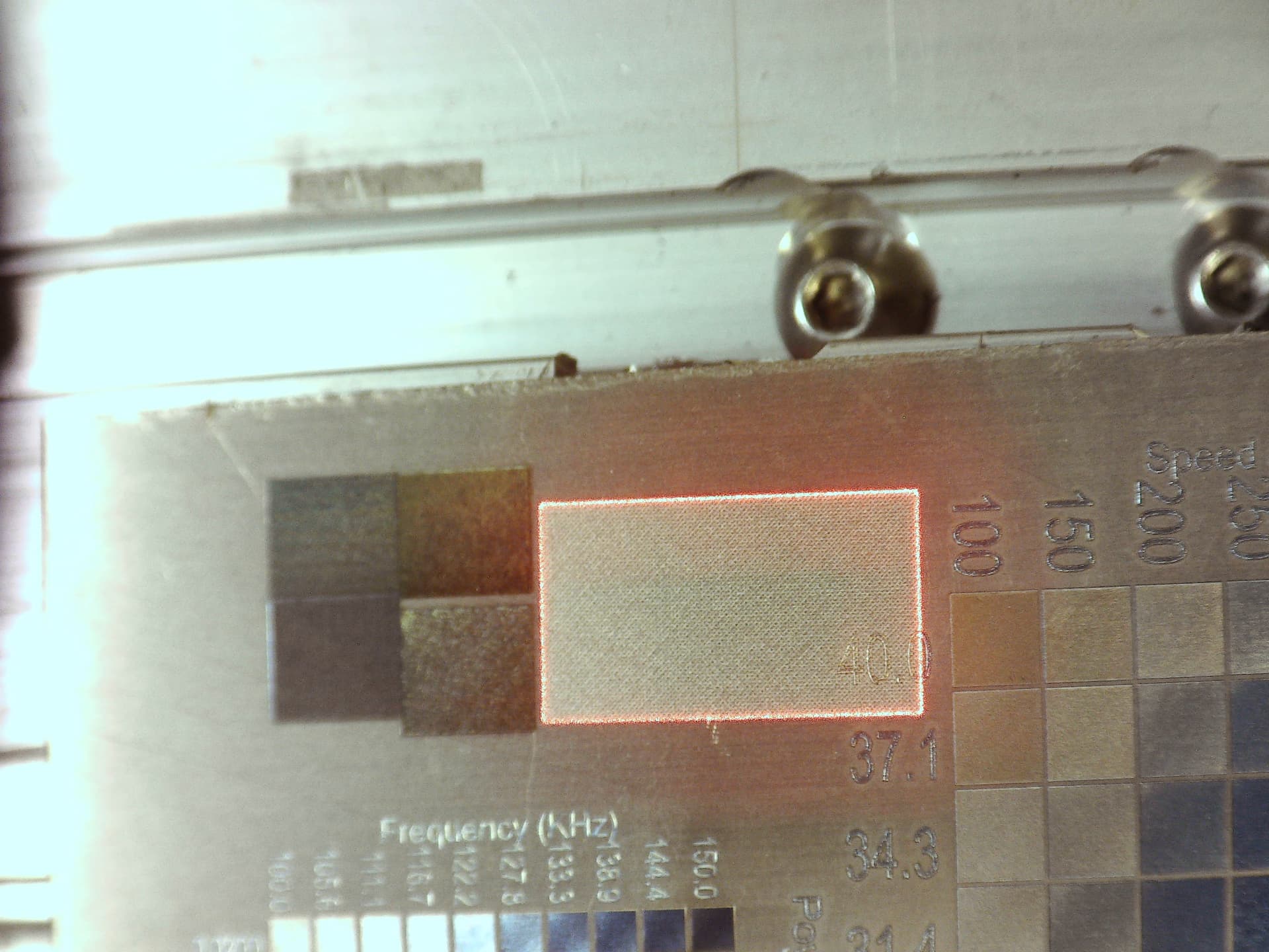

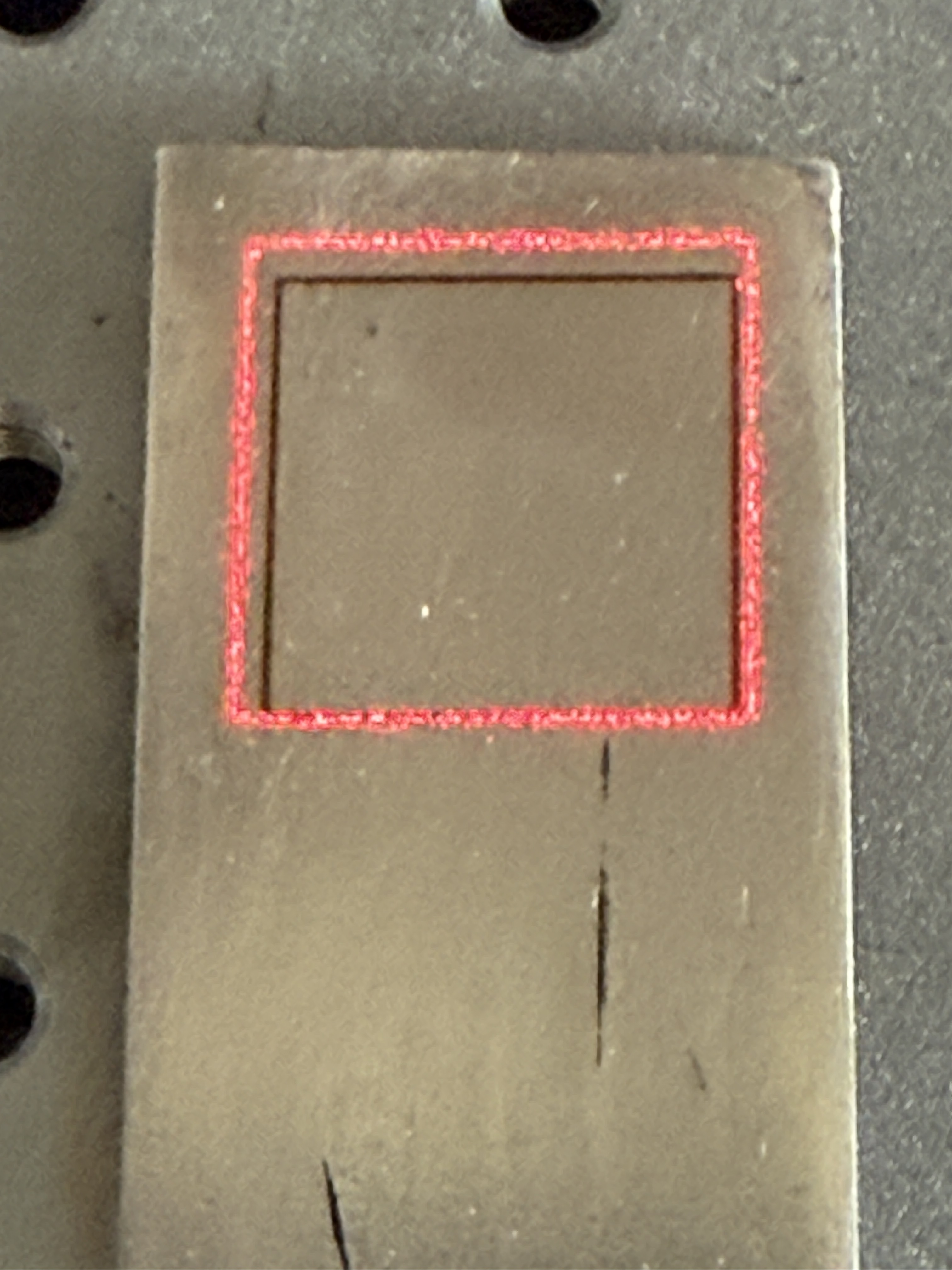

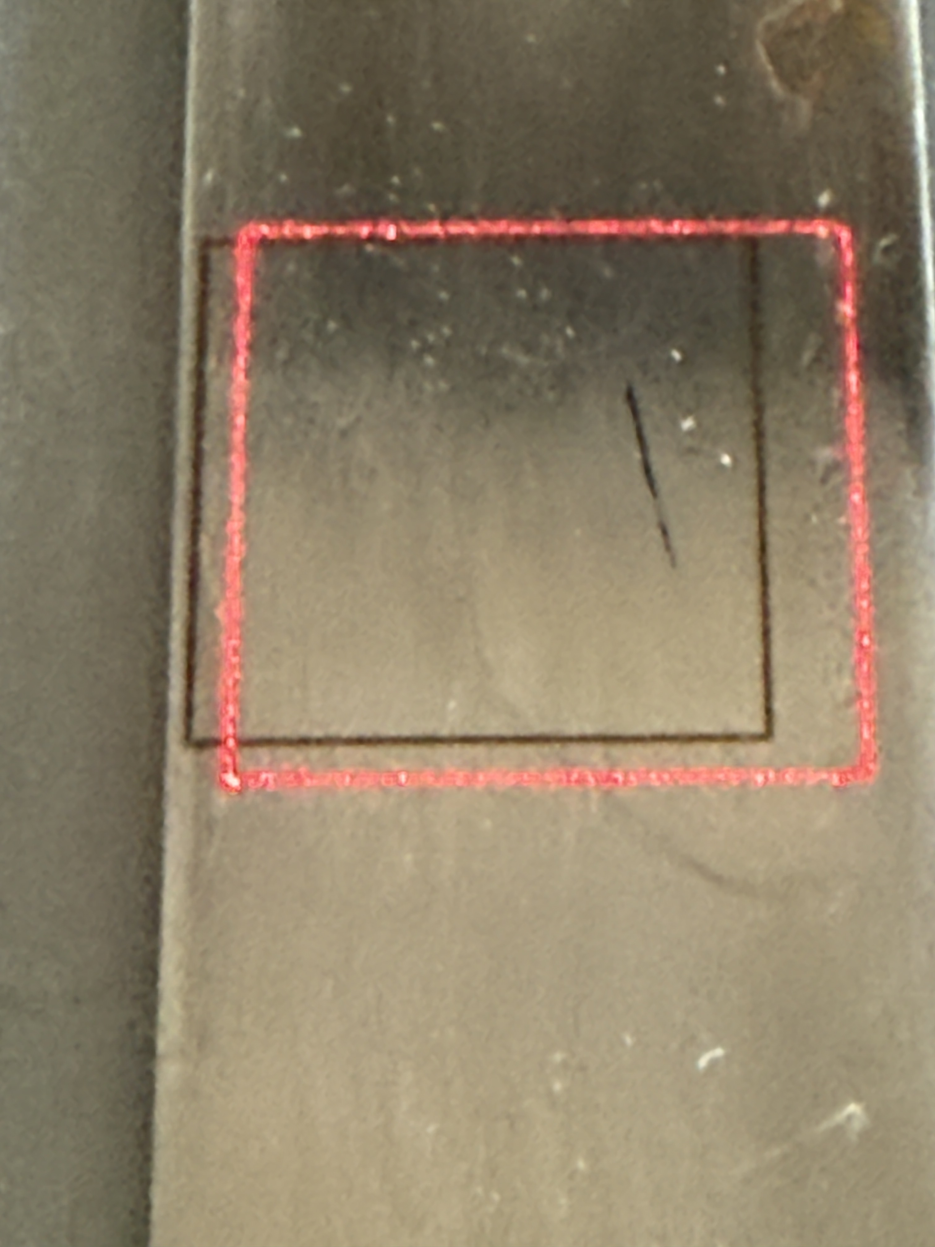

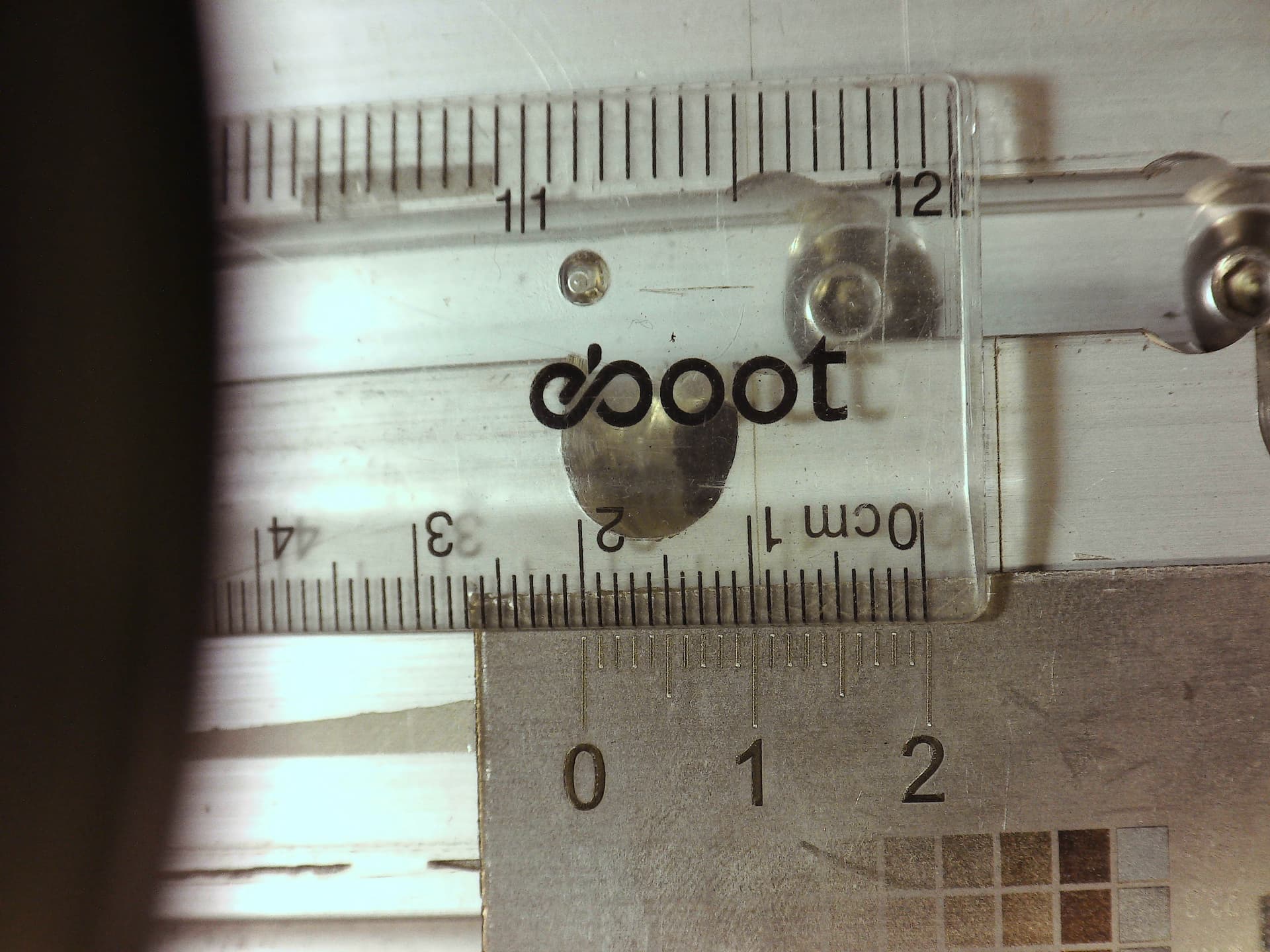

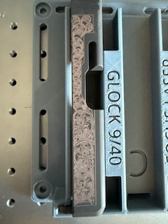

I’ve adjusted the framing several times but it keeps getting off. As you can see from the pics, it’s definitely off. I’ll have to sand blast and re-coat it.
I used a test piece for alignment before engraving.
I hope there is an answer to this because I need to trust the framing to be spot on.
Thank you.

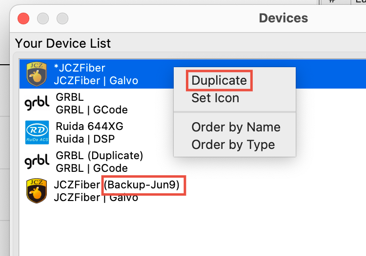

Try to set up a reference test as a baseline with known software settings, so you can better determine if the drift is software or hardware related - here is one way to do this;
-After re-calibrating the framing, right-click and ‘Duplicate’ your device and rename it so it becomes a saved “snapshot in time” of your device settings (see pic below).
-Switch to the duplicate device and save the red light test file you used for the calibration with as similar name such as “Red light framing test-Jun9”.
-Switch back to your normal device.
Now, if you ever notice an unexpected red light drift you can easily switch to that previously duplicated device and run the associated framing test file again knowing that the same software settings will be used.

I finally got it to frame a square correctly. But, when I start a new file, it’s back to being off pretty much the same as the square was.
I’m pretty sure none of the other settings change.

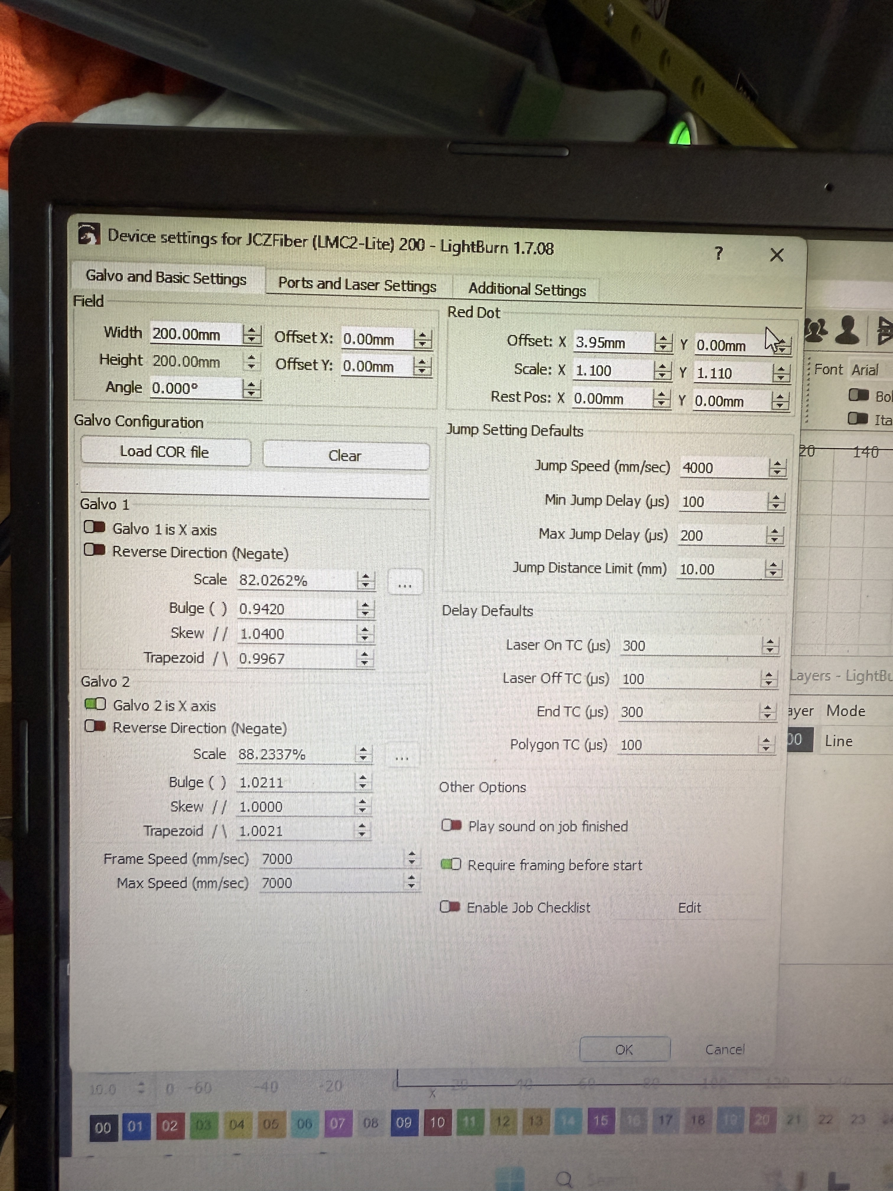

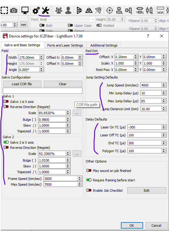

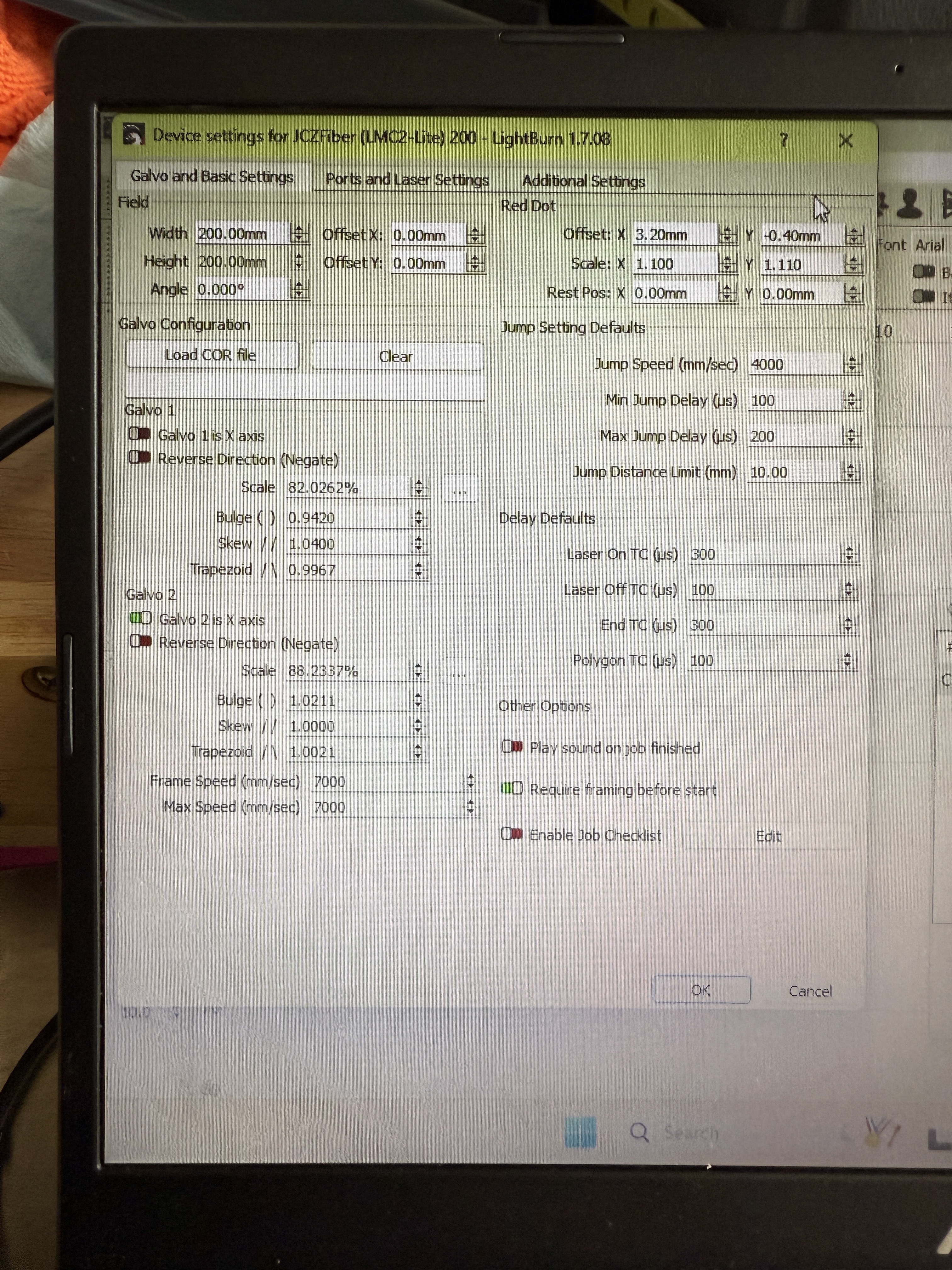

Also please a screenshot of the Device Settings > Galvo and Basic Settings like I posted above.
Big question, should have asked already, do the red dot numbers in Offset and Scale (Device Settings > Galvo and Basic Settings) change back to 0.000 and 1.000 or do they remain what you set them at when you loose calibration?
I’m pretty sure they stay corrected but I’ll check them all tomorrow.
Thanks for your continued help.

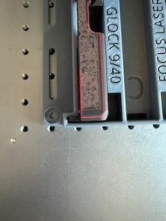

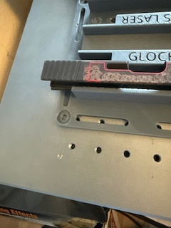

I’m hoping these are in the correct order.
First is settings from yesterday’s corrections.
Second is incorrect framing that was correct yesterday.
Third is corrected settings.
Forth is new square that’s ok.
Fifth is new design that’s off.
Sixth is settings that haven’t changed.
I hope this makes sense.
And here’s a new square with settings.
I don’t see any that are acceptable to start with. You should be able to get it dead on. I think you need to go back to the beginning.
I would suggest backing up a little further. start by making sure you are perfectly in focus and marking a 50mmx50mm or 100mmx100mm square or whatever and measure it. If it is EXACTLY what you drafted in lightburn, check it corner to corner. If both of those are perfect, continue on to calibrating the redlight framing laser so it matches exactly the 50x50, 80x80, what ever you are doing your quick test with. IF the measurement or the corner to corner are not perfect, you need to go back to calibration of the lens. You need to get the nuts and bolts squared away 100% before you jump into anything sexy. I spend probably 10-20 hrs nuts and bolts for every 1 hr of sexy. Keep at it and report back.
