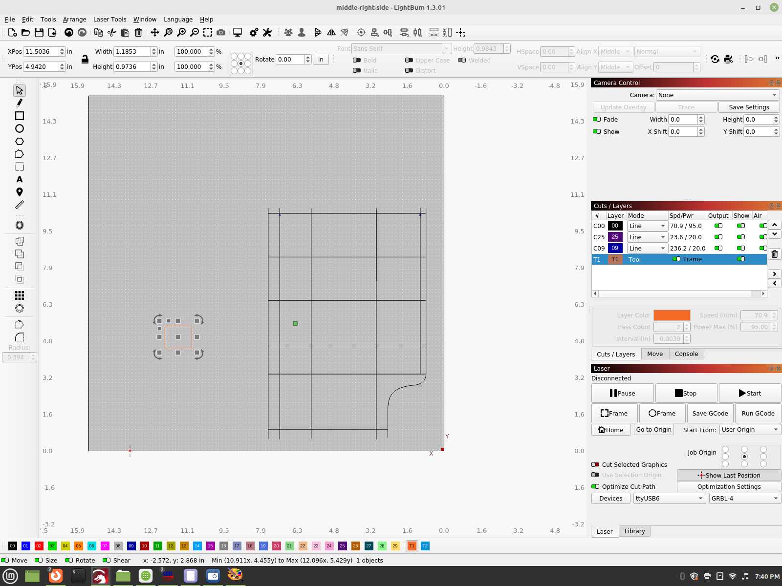

Refuses to return to user origin, weird anchor point
It’s been working on my Linux Mint system for quite a while perfectly. Yesterday it went totally haywire and I’m getting this strange anchor point/small square which affects where it starts. If I add a second drawing, it moves with it and resets the starting point to another part of the screen. The starting point used to be user origin, but it starts and stops only at the beginning of the cuts no matter how I set it.
I did try just putting a small box where the user origin is supposed to be as the starting point, then placing the cuts required it to be positioned off the actual work area and I get the the cuts are out of bounds warning, cut anyway and it was not out of bounds to the actual physical work area.
I turned on the homing option, that was a bad idea, it tries to go well past the physical boundaries of the work area.
I can eliminate a hardware and it’s physical hardware software since it does work correctly on my cheap Windows laptop, be it the difference is the Linux system only works with GRBL-4, while the laptop only works on GRBL-3.
Could this just be a simple setting, I’ve tried so many to no avail? I don’t want to have to reinstall LB, it was a nightmare to do in Mint, but I can’t see any other solutions unless someone has options.

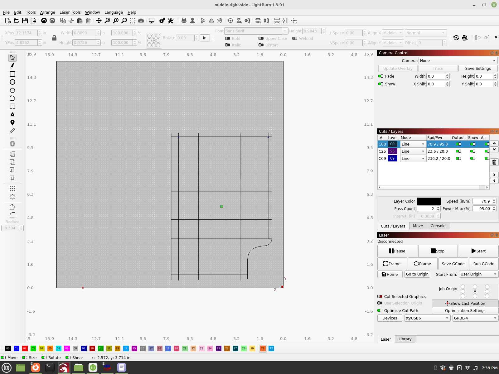

You have the user origin set to the center of your work, is that what you intended?
I did not intend for it to be user origin as the center of my work. How do you disable or adjust this?
If you look in the Laser window, you will see “job origin” with a box with 9 little circles. Those circles represent coordinates for the location of the origin. if you set it in the upper right hand corner your job will be cut or engraved just below and to the left of the location you set as the origin on your laser.
The little green square is the actual location of your origin relative to your work.
That’s helpful. The problem is, it’s not going back to the home or corner position of the work area, it just stops at where the cut finishes. I changed the format to coordinates and set the origin in the corner for it to move out of the way of the stock from, but hardly what I had to deal with, before, and before it was set to the user origin, just as it is with my windows laptop which functions stock as is correctly by returning as it is supposed to.
Let me make sure I know what you want to happen before we go any further. You want to run the job and then have the laser head move out of the way to a predetermined spot, correct?
I am assuming you know how to set an origin point for your machine, independent of lightburn.
Stock it returns to the corner of the extrusion/work area, it stopped doing that, it was doing some very strange things before then I don’t want to get into on this request.
It’s now going through the cuts, and instead of just stopping at the finished point, it’s moving to the center, just below it, stock, like it used to move to the corner but it’s now just below the stock it cut. When I manually move the laser to the side, it begins and ends still just above where it was physically put upon and returns again, just below the cut area, so one inch over, it will start and end cuts one inch over, right above where it’s physically at.

Change the “start from” setting in the laser window to Absolute Coords.
Home your laser, run the job and see if it returns to home.
Absolute coords will run the job just as you have it set in the work area in lightburn.
