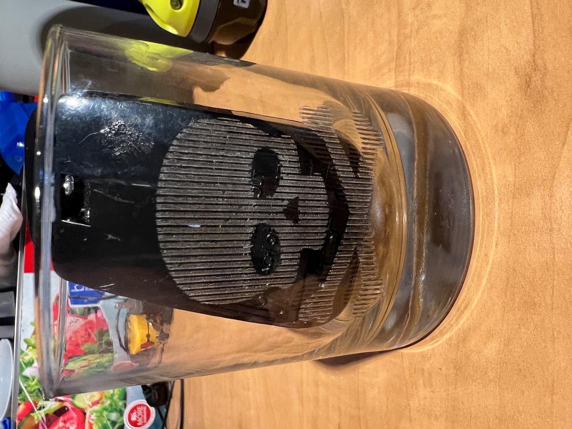

Have a DIY rotary Chuck that I am using with the Comgrow Z1 20 watt Laser. I am getting evenly spaced blank spaces no matter what I do. Stepper motor is Stepperonline Nema 17 Stepper, step angle 1.8 deg. 200 step/revelution. As far as I can tell it is the same type stepper as the comgrow stepper but larger.

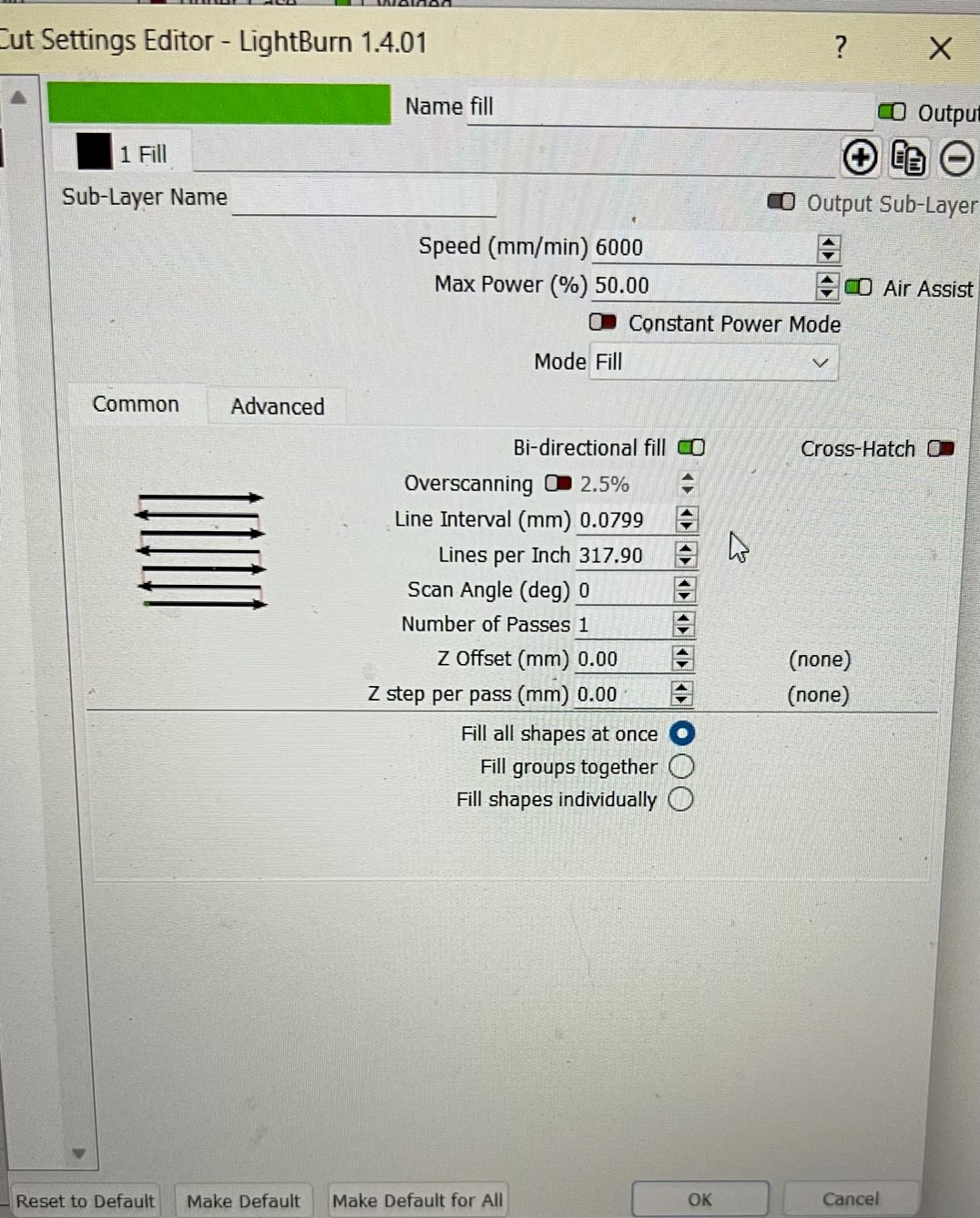

Have you checked your “line interval” under “common settings” in the cut settings editor ? Typical setting would be .1- .2 mm or something around that.

How far apart are the evenly spaced blank lines? It’s possible that it’s a rounding error related to line interval but that would be a longshot. Adjusting line interval by 10% would move the blank lines and let us know if we’re on track.
Great test! The repeated blank lines won’t change if this behavior is Crud-driven. :slight_smile:

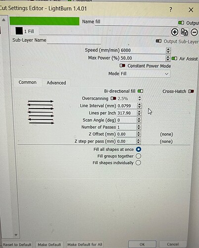

A screenshot of the cut/layer edit screen so we can see the values.

saved a blown up preview and it looks like this
I have tried from 180 to 600 still there
