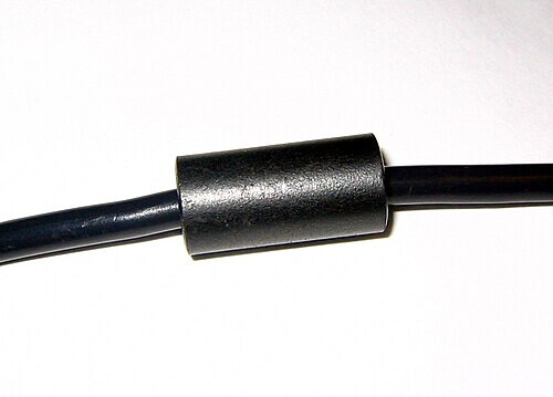

Given your recent test results, I would recommend using the shortest possible USB cable with a ferrite bead, which is designed to prevent electromagnetic interference with high-frequency signals. :slight_smile:
Thanks for the suggestion, but that is the cable I am using. It is 100% shielded and there is a toroid on each end near the plug itself. I am wondering if it could be because the cohesion 3d board is inside the cabinet about 5 inches away from the high voltage supply for the tube. I even put a toroid on each axis ribbon cable when I installed the board 3 years ago. The thing is I didn’t have this possible interference problem until Uncle Bill told me my old computer would not support windows 11 and I bought this HP computer. This never happened before I changed computers. Maybe the HP usb port signal levels are flakey or something related. Anyhow, thanks for the tip on the cable. mz lowell indiana

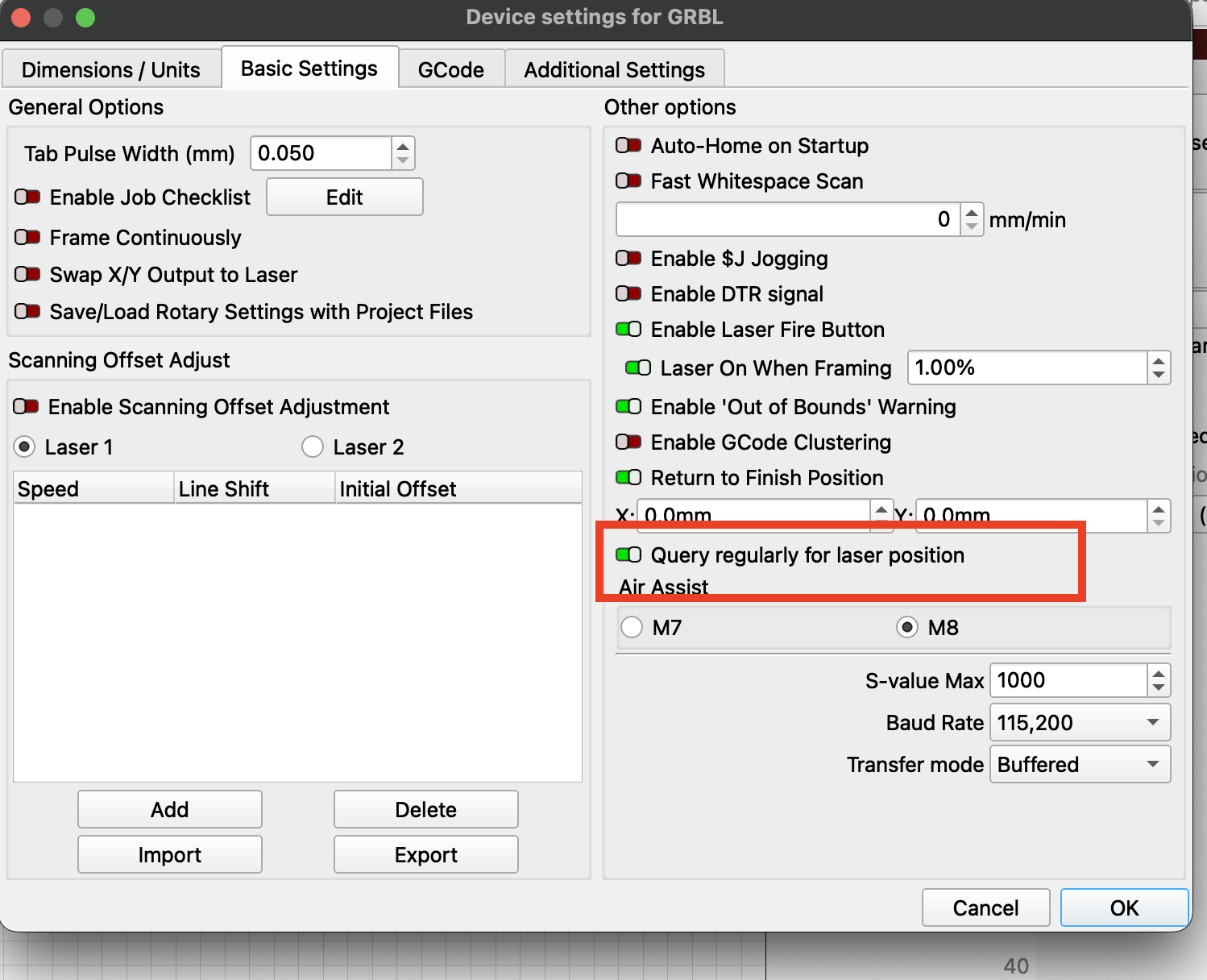

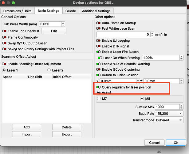

See if this switch is enabled in Device Steeings and disable it if it is.

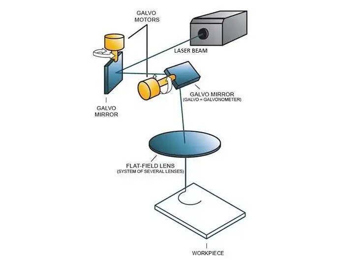

Is there some reason you tagged this with Galvo?
:grinning_cat:
I am not a wizz at these message sites. I just typed a new response to my problem to the last responder. I don’t know about the Galvo thing. Anyhow, I think my problem is solved. I have a new power supply installed with higher wattage and better filtering. Also the laser is running fine now. Thanks to all who helped, this is community spirit at it’s finest. MZ Lowell Indiana
Lean what these mean. A galvometric head is usually on fiber machines, but can be for other types of lasers.
We use the keywords to help us locate items that we can possibly assist with.
This is the basics for a galvo.
