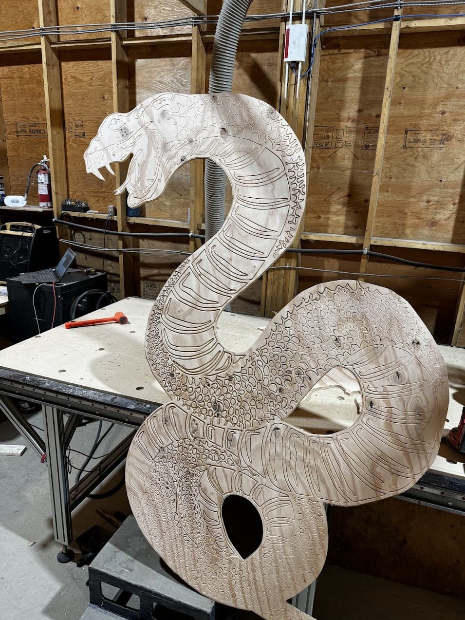

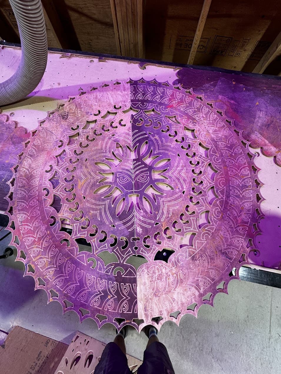

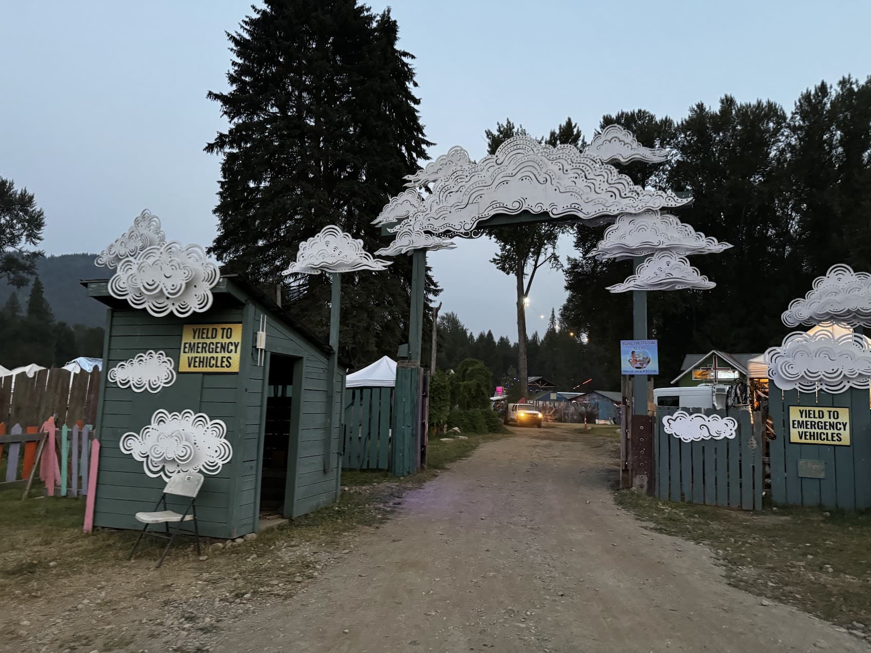

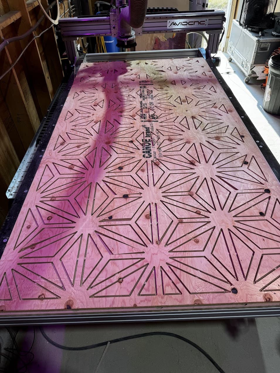

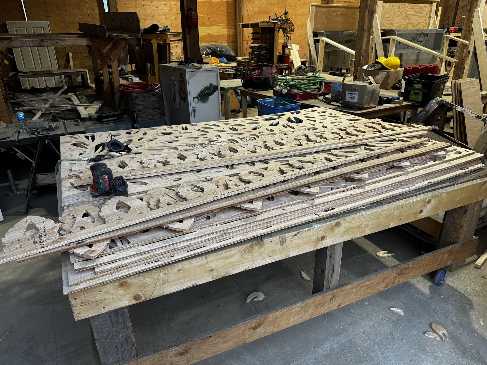

I just worked for a month doing the Digifab at Shambhala Music Festival - I did all the work with MillMage. It’s absolutely going to change how you work with routers.
Some of the things made with MillMage this year:

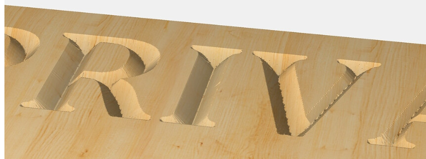

V-Carving is actually very complicated. If you want to use a V-Shaped bit dragged along a profile at a specific depth, that’s trivial (and already supported).
If you want to vary the depth so the tool creates a perfect V-shaped pocket that varies in width with the shape, things are a bit different - It requires computing what’s called the “Medial Axis” of whatever shape you’re carving - that is, the path for which you are the same distance from two (or more) sides of your shape, and which parts of the shape you’re equidistant from for any given segment. When you have the medial axis, you use it to compute the proper depth for a given segment of the V-Carve.
In case anyone is unclear, this is what I’m referring to:
Computing the Medial Axis is something we’ve had one of our “moon-shot” coders on for several months now. It’s a relatively simple thing to explain, but really damn hard to get a computer to do it cleanly and quickly.

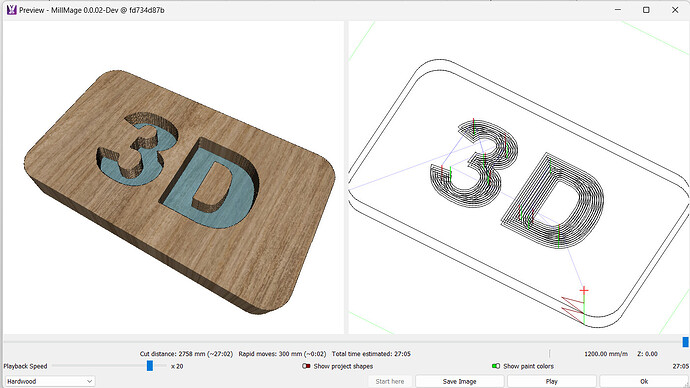

A few basics:
  • Operations currently supported are Drill, Pocket, Rest Pocket, Profile.
  • Pocket and Profile ops can use straight plunge or ramp, and profile adds the ability to do a spiral descent as well.
  • Tabs are already supported (full depth, partial depth, ramped)
  • Pocket ops can use offset or raster clearing, and will attempt not to do a full retract unless necessary
  • You can specify a “Safe Retract” height for moves between operations, and a “Rapid Retract” height for retractions within a single op. You don’t have to use rapid retracts if you don’t want to.

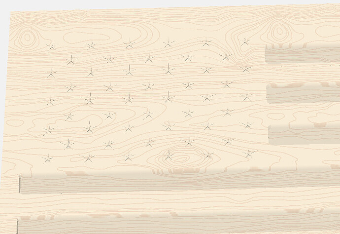

  • Preview is shown in orthographic wireframe with different colors for retracts, rapids, plunge, and cut moves, as well as a full 3D sim. Both views are interactive. The 3D view is similar to Vectric’s.

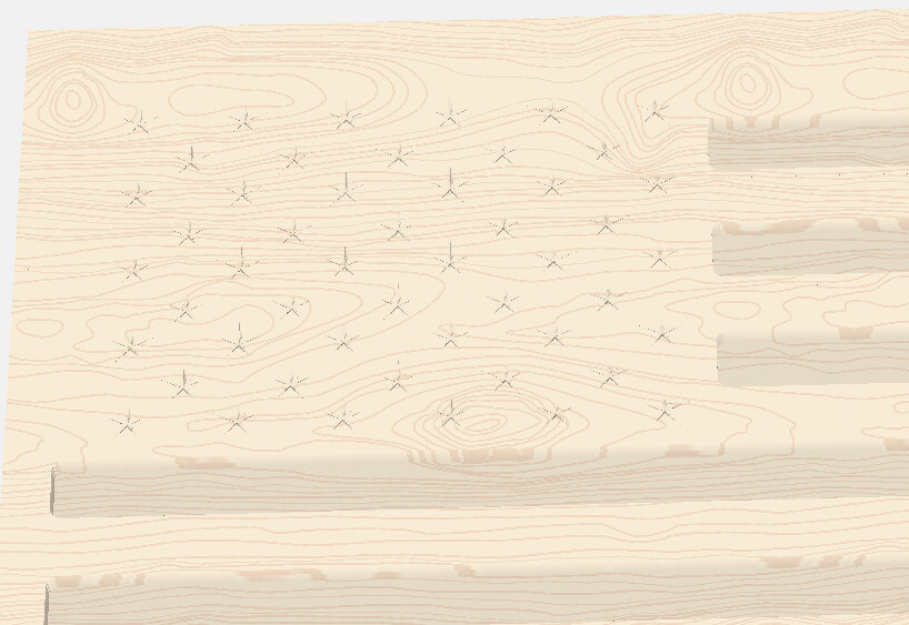

To give you an idea:
