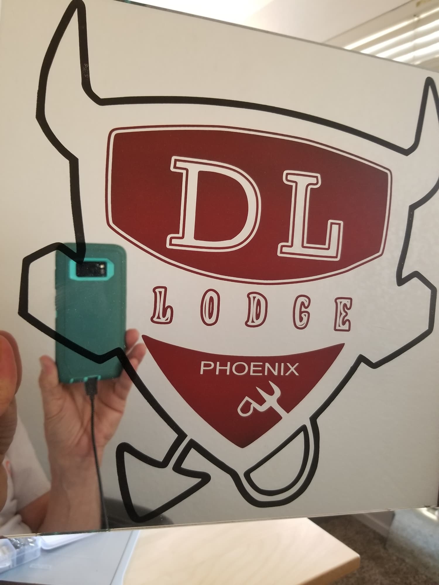

I put the backside on a different layer, and turn off Output in the Cuts window. When the first side is finished, it goes to the entered finish position.
I flip the part, then flip the outputs, and/or select other paths, and go at it from there. Maybe not efficient, but I do not get burned fingers.
