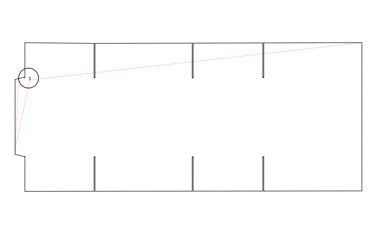

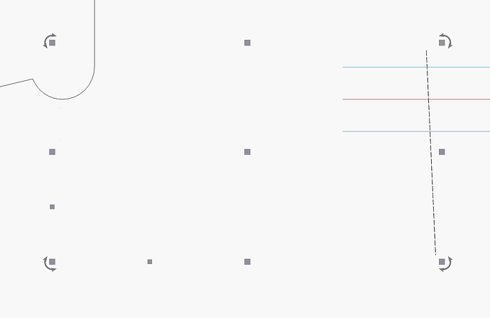

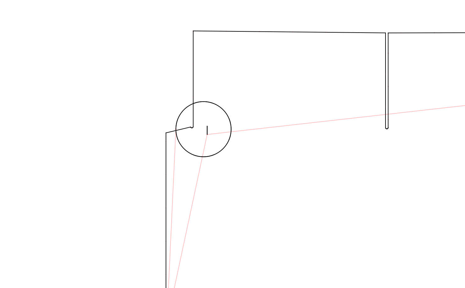

How do I remove the extraneous mark shown in the attachments Preview_Overview.png and Preview_Question.png? They were captured by LB/Preview/Save Image.

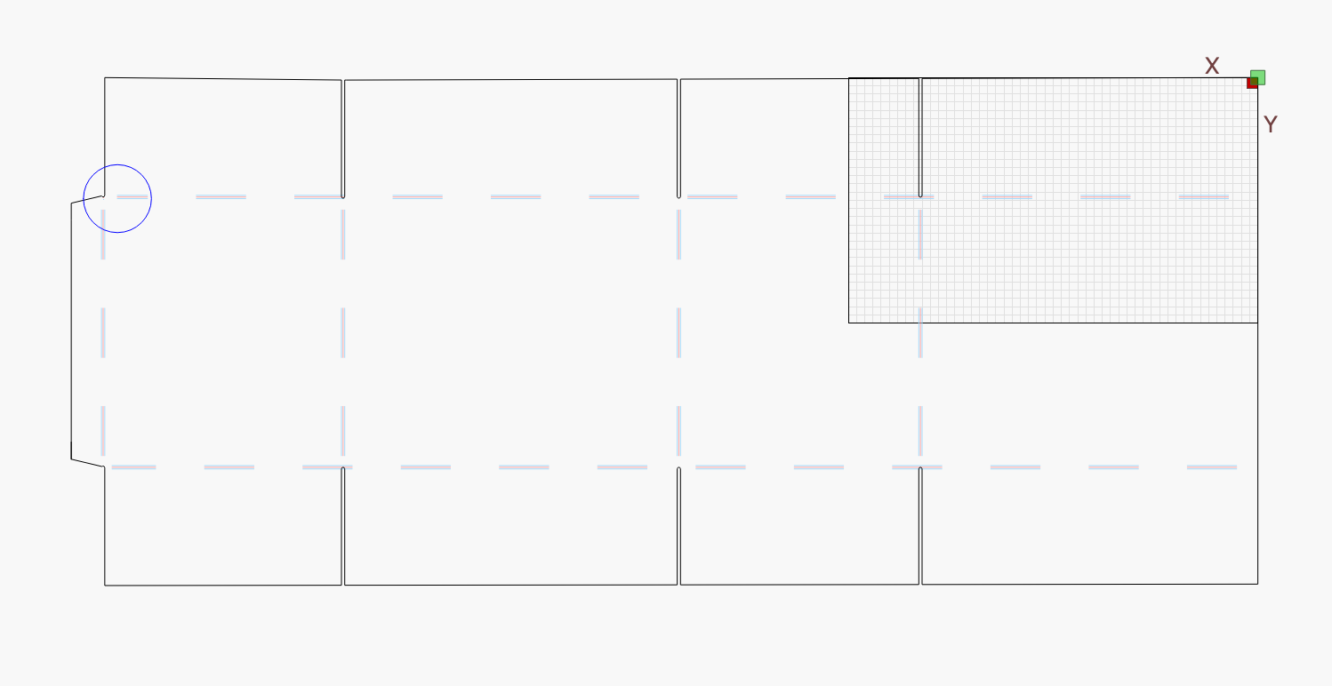

I cannot see the mark when I look at the drawing on the LightBurn screen.

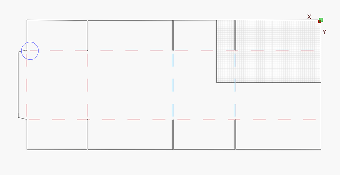

Attachment Drawing_Overview.png shows what I see on my LB screen. File Stock_Size_Gallery_ay2.lbrn2 is the file.

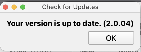

macOS 26.1. Hardware: MacBook Pro, 14” 2021; “Chip Apple M1 Pro”; “Memory: 16 GB”. LightBurn says it’s up to date:

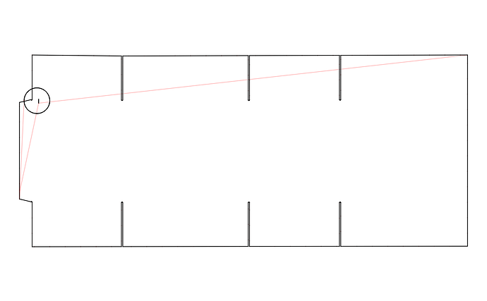

Not sure where it came from or why it can’t be seen. I ungrouped everything and selected the area using drag from left. That showed a selection box and when I previewed the cut there was the mystery line and a random dot. I deleted the selection and saved the file.

I don’t understand: how can a line show up in a Preview, but not on the primary LightBurn display?
It seems to me that something is wrong.

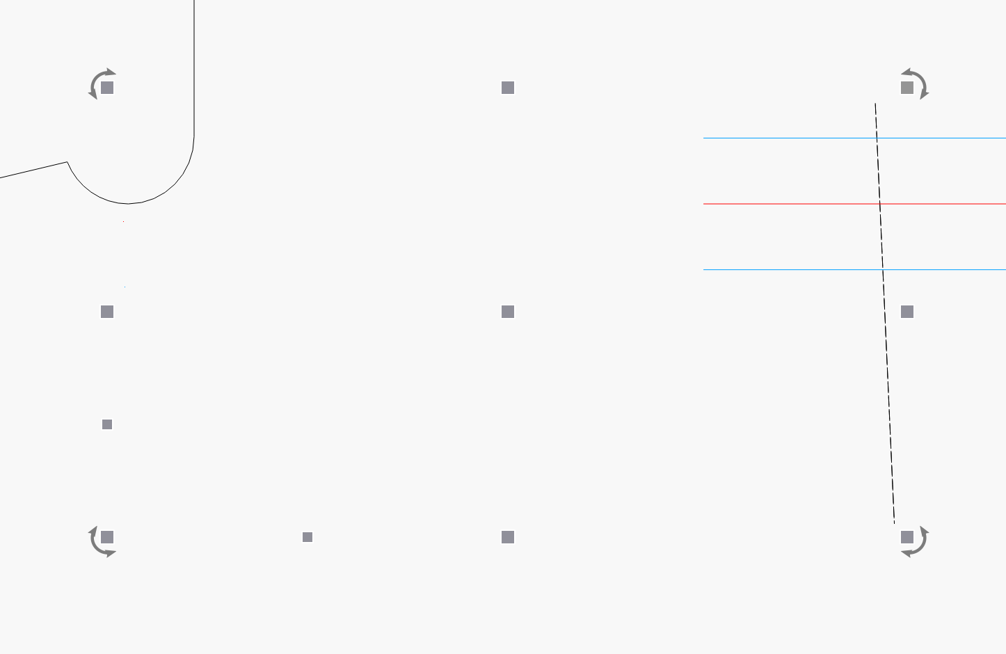

Here are the mystery shapes.

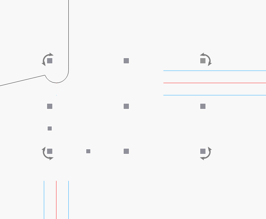

I rotated a couple degrees and this line appeared. When I select it by itself, while invisible, it has a width of 0. The other dot is on one of the disabled layers.
Nuts - an intermittent.
Sometimes a “Select Box” will show the debris, but sometimes it won’t.
On the other hand, Preview always shows it.

You cannot select the ‘debris only’ when it’s grouped with other items. I had to ungroup all to find it.
Oh! You’re right. I forgot to ungroup.
By the way, the line was a part of a guide line I put in. I used it so I could shorten the 3 horizontal lines.
:slight_smile: And I used the Snipping Tool to actually do the shortening.
