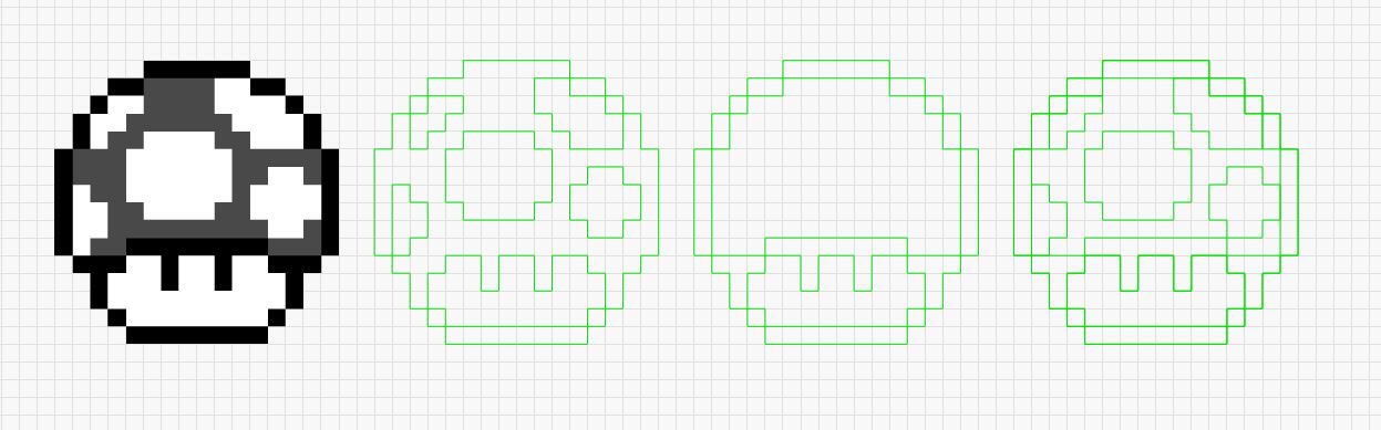

Is there a way to remove overlapping vectors in the design yet? I’m playing with entering pixel art here and getting it to sync with the grid. I do Trace, but it will detect one shade transition not the other. I do a second with the Threshold slider moved over and it finds the other transition, made sure the nodes snap to the 1mm grid and superimposed them (on the right), but many vectors overlap and if it fires the vectors twice in some places it will not look right.

It’s hard to tell from just looking at the picture but are you able to union the overlapped components to flatten them to a single set of lines?
The two Trace outputs are different objects. The object isn’t a “Group” of vectors so I can’t Ungroup, only Node Edit (which can work, just very manual). I can Group them, but that doesn’t change things.
Selecting the superimposed, snapped-to-1mm-grid on the right, Convert to Path and all Boolean ops are greyed out.

Boolean operations will work on specifically 2 objects at a time.
Each “object” of the pair can itself be made up of a group of smaller objects. However, the important part is that whatever you are trying to apply the operation to must be in one of the 2 pairs of super objects.
Try this:
  1. Take trace output 1, group all components
  2. Take trace output 2, group all components
    3, select both components and align them on top of each other perfectly
  3. Tools->Boolean Union
Again, it was hard to tell from just the screenshot if the conditions were correct for this to work predictably but there’s a chance.
Upload .lbrn file here for a closer inspection.

Hmm, I tried to superimpose the two Trace Objects again, and I CAN get Boolean Union to work! I think it’s removing the duplicates!
It looks like Boolean Union already is kind of wonky if the shape is Closed but not Simple. Well, I’m not even sure what to expect as a logical outcome. But this does seem to do what I want.
I started looking at your file and realized I don’t really know what you expect this to look like.
One thing I can see causing some issue potentially is that these Boolean operations only work with closed path shapes. The expected outcome is that all positive portions of each respective shape should remain in the final output for a union. The different booleans work in a similar way in accordance to the operation.

I tried again with a Mario turtle and had “Boolean Union” remove interior features, but I just tried “Boolean Intersection” and it actually did what I needed, remove overlaps.

This must be something unique to the situation. The intersection should in fact leave you with parts of the 2 objects that are common. So the reverse of removing overlaps. There is another operation that LightBurn doesn’t have called an Exclusion that would remove overlapped portions leaving parts that are not overlapped.
