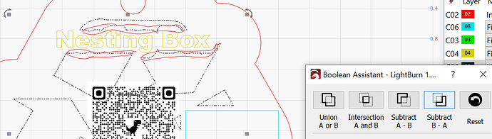

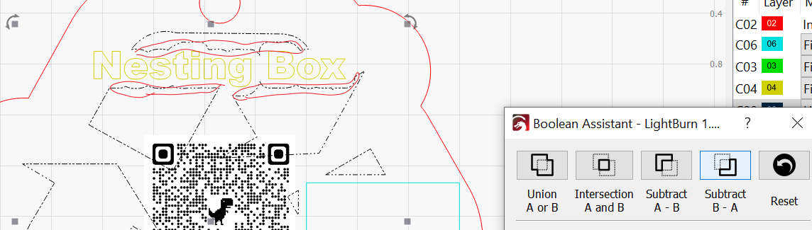

I want to create text over a background line image, but would like for the background line image to just disappear for a certain margin around the text. What I tried was outlining the text, changing the outline to another layer ( so it can be removed from output later), and then selecting outline then background image, then doing Boolean Subtract B-A.
Question1
This seems to remove the background lines, but causes the borders of the Outline appear to become a part of the original background line layer. That is not the desired effect. I want the Outline to be invisible and any lines behind the outlined area to be invisible.
Can anyone explain how that could be done? Thanks!

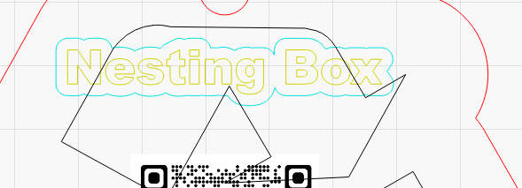

Hi. Thanks for the response. For clarity I’ve marked around the lines that should not be there. Those are from the Outline effect on the text which I used to determine the area where I did not want to see lines from the recycle symbol that is the background. They should not be completed objects. Just lines that stop at that distance from the text.
Does that make more sense?
All boolean operation will leave a closed object, so this can’t be accomplished with doing this that I know of.
If it’s a small enough area you can go in and manually remove it using the node editornode-edit.

If you want a space between the text and the background, you could try doing an offset around the text then try the boolean operation and then delete the offset,
That didn’t work the way I needed it to.
Using a rectangle you could use the boolean operation. This would make the lines straight and very easy to remove using node edit… probably in one keystroke for each line…
