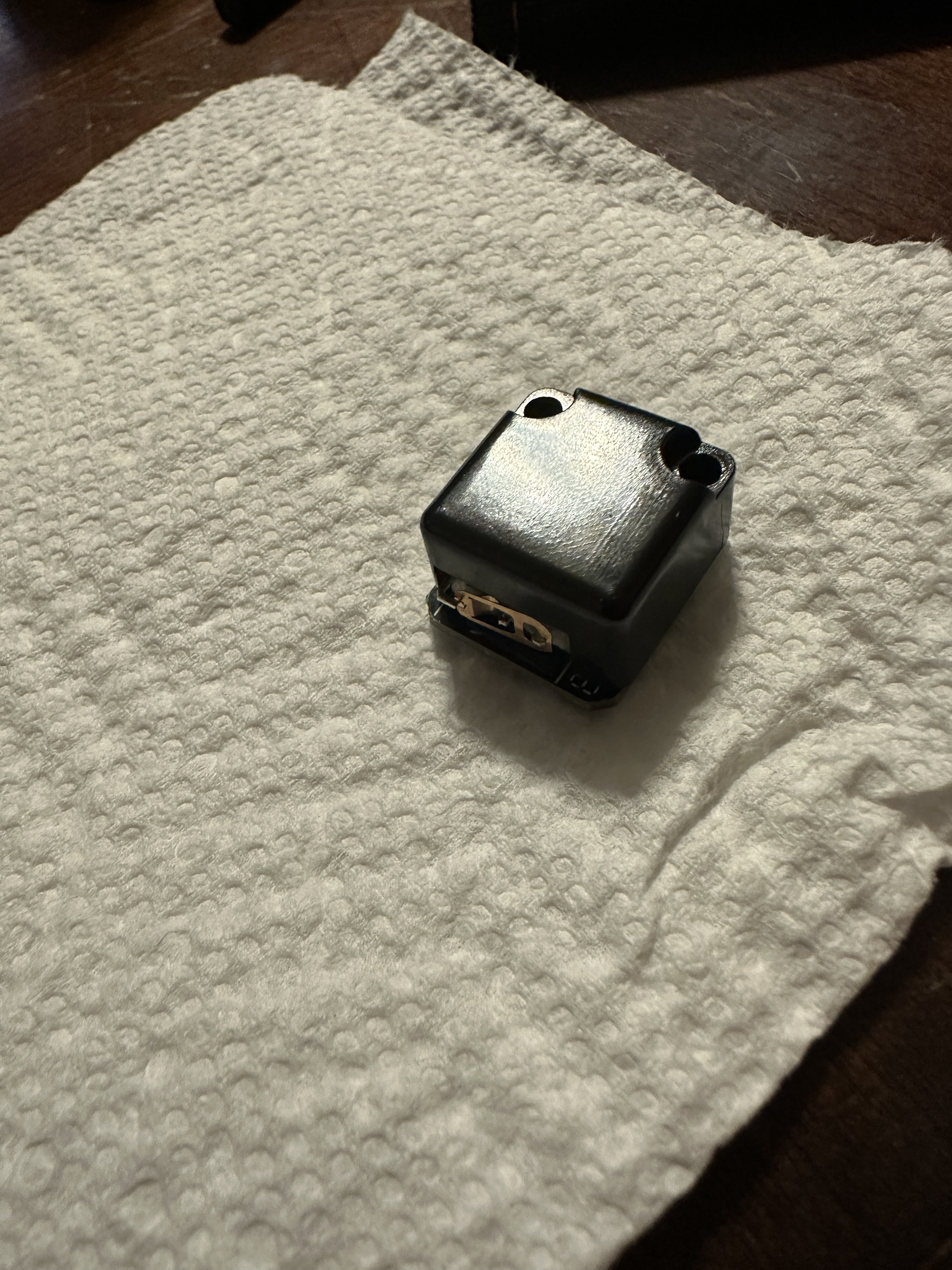

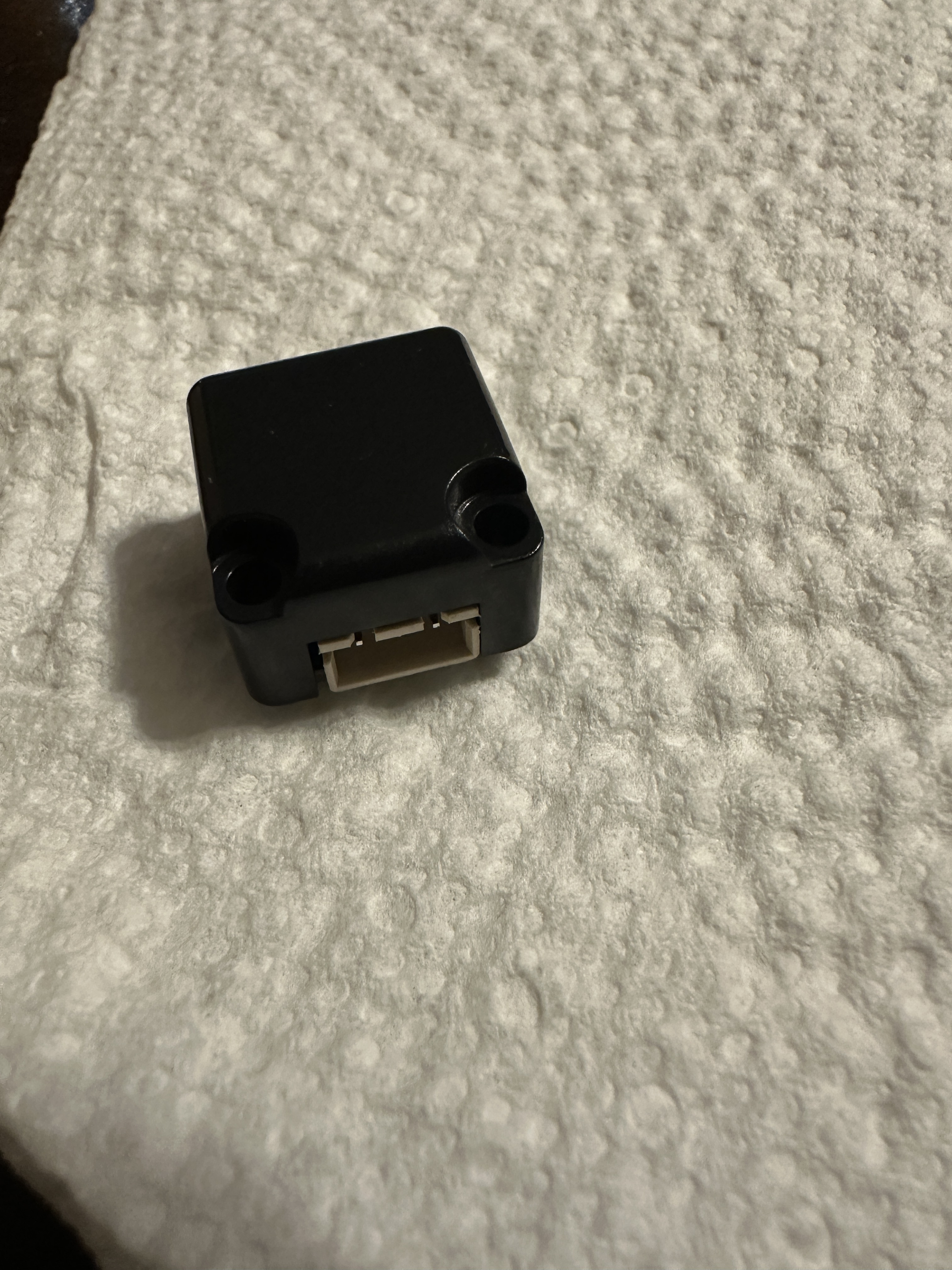

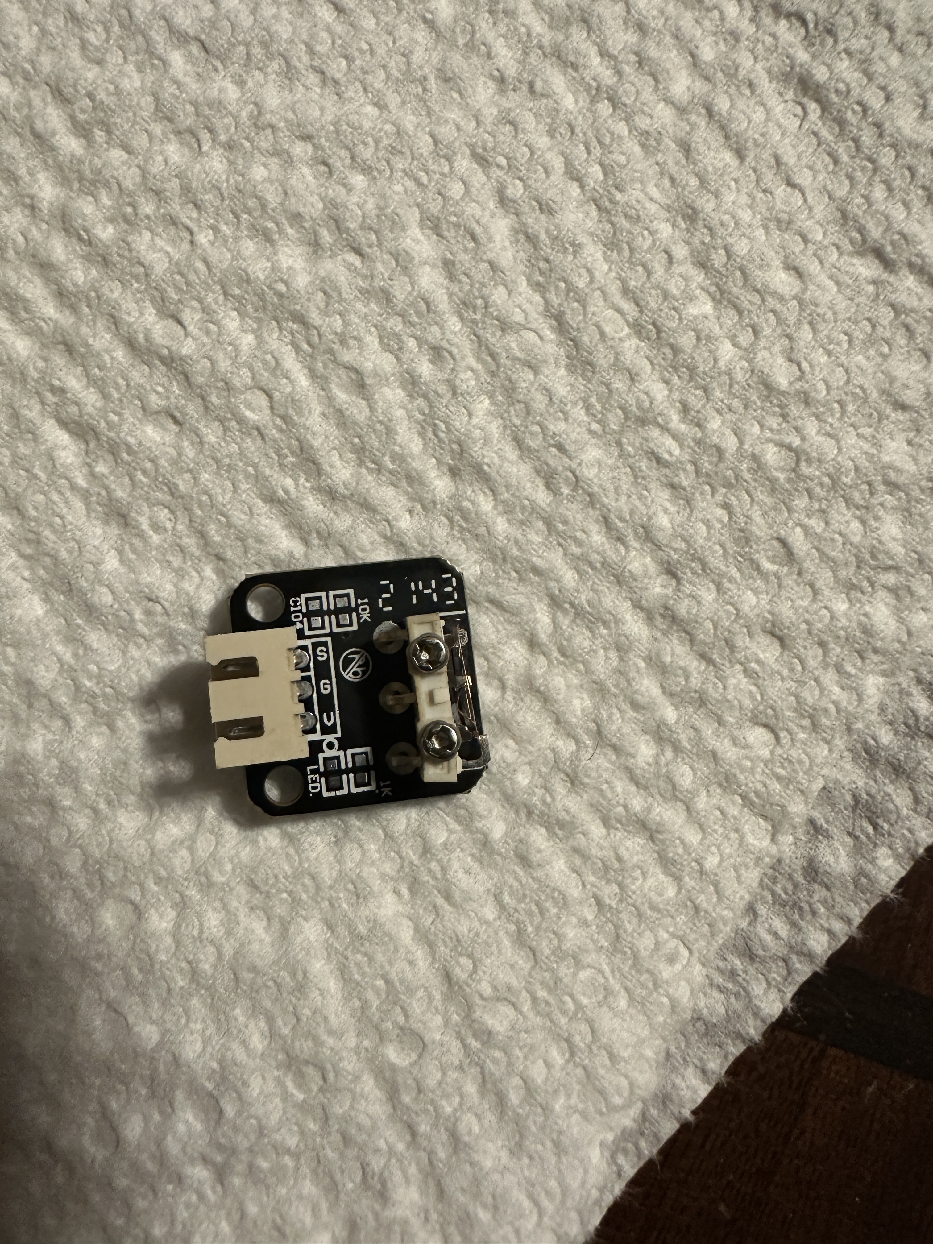

I was hoping that someone could help guide me on how to get a part. I am in need of replacement parts (2143 home switch) for Creality Falcon 22w. My machine had a fit while framing and I reach into the enclosure to move things out of the way. I suppose that my watch band snagged the switch mechanism and broke it. Any help would be appreciated.
should be obtainable on amazon (packs of 10)
But post a picture of your switches so we can help locate them
Multiple angles if possible
I looked on Amazon, Walmart, tried the Creality website without any success. I took a few pictures that I’ll post them. Thank you so much for your help.
The closest i found are these but i am uncertain if you can actually replace them as you would need to unsolder broken one and solder new ones

Hi Billy, I consulted with our Facebook group expert team, seems that you can try these swtiches, they’re for Creality Ender but basically the same model used on Falcon. Thank you @gilaraujo for helping out here!
Amazon.com: 5Pcs Creality Original EndStop Limit Switch Kit for Ender 3 V2 Ender3 Pro 3S Ender-3 Max / 3X, CR-10 V3 S4, Ender3 S1 Pro 3D Printer : Industrial & Scientific
I ordered them and hopefully that will work. Thank you for your help.
