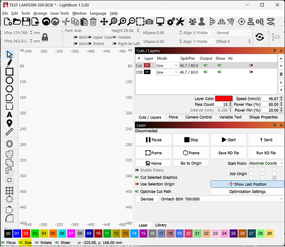

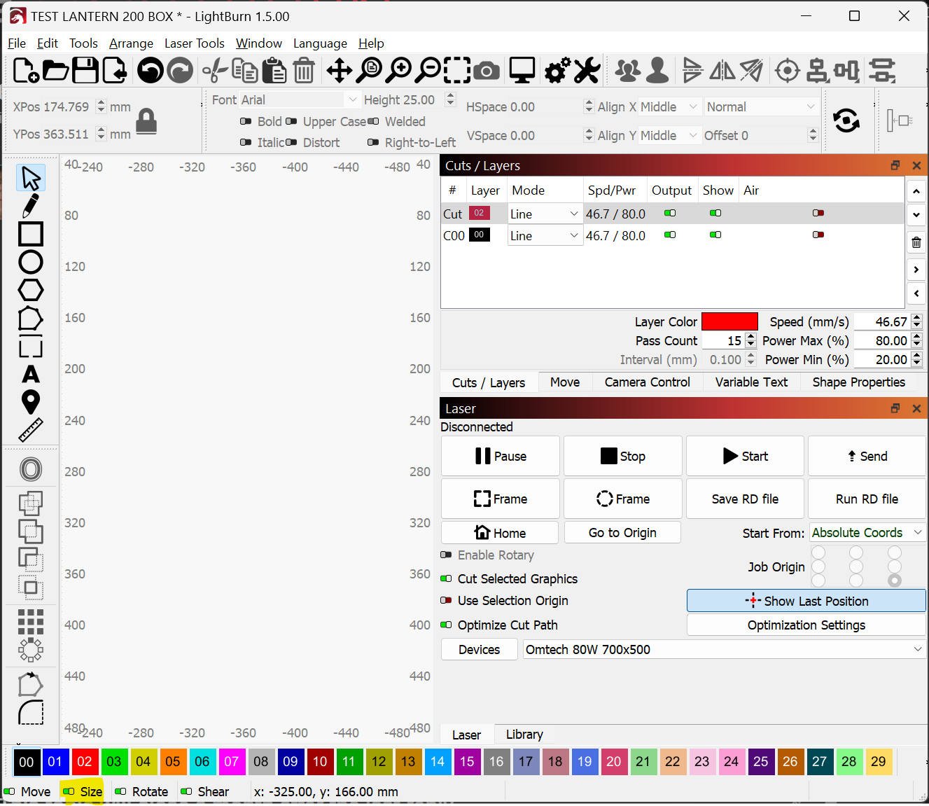

I’m a fairly new lightburn user. This is the first time i’m actually drawing in lightburn (as opposed to just importing images) I wanted to draw some text over a shape, but I quickly found that there’s no resize handles on the text. I have the curved arrows for rotate, but not the square handles for resizing. See the attached screenshot. How do I fix this? Lightburn 1.4.04 on windows.
Look at the bottom of the screen. There should be 4 toggle switches for various aspects of how you can transform the shape. Make sure the “Size” toggle is enabled.
Yep, that was it. I never would have thought to look there. Thanks.
