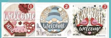

Hello everyone,
This is my first post. I have a question about resizing multiple designs purchased online to fit the same backing dimensions.
I purchased several circular wood sign designs online. Every design has a plain circular backing as it’s base, and cutouts that are layered on top.
In order to try and max out efficiency, I’m hoping to resize them all so that the backing circle in all designs measures 11.5 inches in diameter so I can cut the circles ahead of time. I need to have the cutout portion of the designs maintain a proper aspect ratio. I can’t seem to figure out how to do that in Lightroom. I’m attaching a screenshot of several of the types of designs I’m talking about.
If anyone has an idea on how I accomplish this I’m all ears!
Thanks for your time
It’s quite simple. Load your design file, stack all items in their finished location if not already there, in other words, if the layers are spread out across the work area you want to move them all on top of the backer for this process. The pics you posted show everything stacked. Select everything in the graphic you’re working with, group them then using one of the corner handles drag to scale the entire selection to the size needed, or use the numeric size boxes in the toolbar to resize, ensuring the lock aspect ratio is engaged. Then you can ungroup and move elements around as needed.
Thanks! This was…so simple I’m embarrassed not to have thought of it. Appreciate the help!
