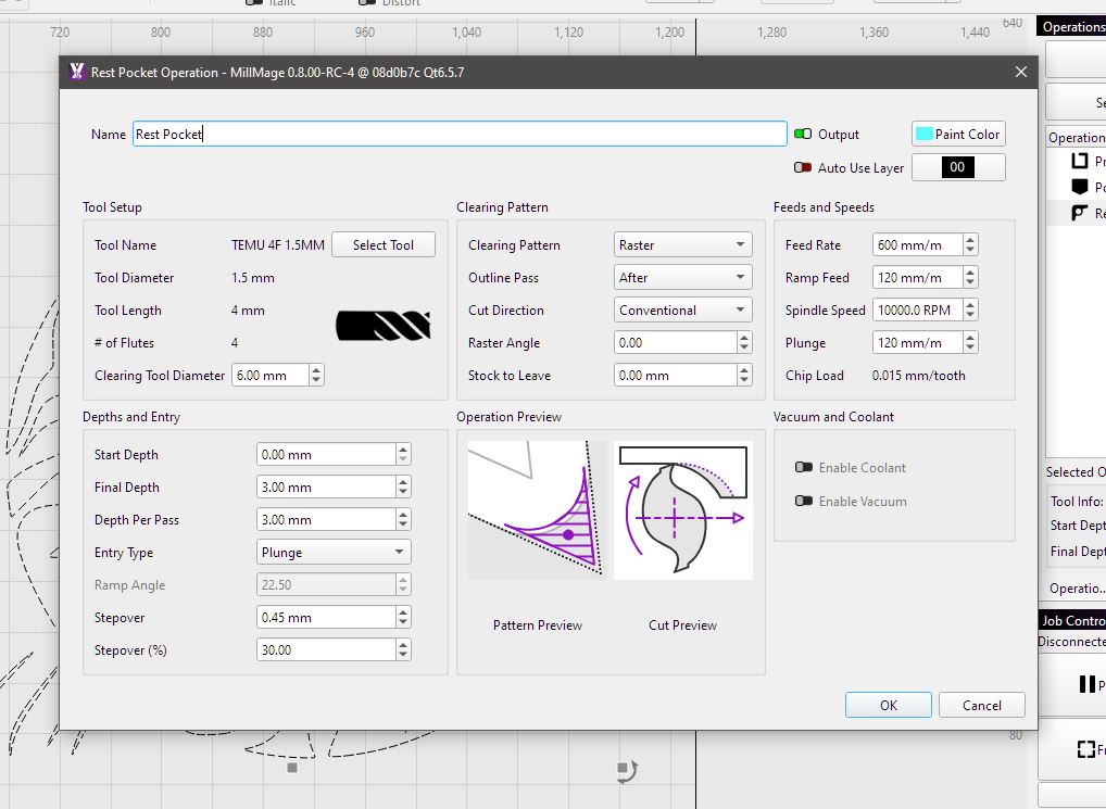

Rest pocket issue or preview problem
just download rc4 , not sure if this is just a preview issue or weather it will be issue in cutting file
cant confirm if this was issue in earlier RC versions i picked up on it as trying a smaller tool to get more defining finishing lines, hence zooming in on preview all shapes are closed triple checked that also hovered the scissors over and it deleted area in 1 click so def closed and
below is what I’m getting in the preview windows
![pocket 3|642x500](upload://dMHkLjtrCurXAJf4Zwpqap8dJHF.jpeg
not sure why it is leaving that little piece have max zoomed in on file , ungrouped, done a sweep trying to find the smallest dot / node etc cant find anything
as you can see little pieces aren’t being cut out
correct me if I’m wrong isn’t the rest pocket meant to clear all of what the clearing tool dosent
its like the tools aren’t quiet over lapping enough
this isn’t just isolated to this area its all over the job
the paint colors look like they are overlapping
one more issue is moving of preview
left side with paint colours nice and smooth as per previous RC versions
right side showing tool paths, is spiritic, twice as fast hard to control used to be same speed as left view
You didn’t show the entire settings window for the operation. What is your step over? Is it more than 50%? If it is lower it and if the issue is still there.
rest pocket tool is 30%, pocket tool 40%, none of my tool are set to more than 40% step over
Can you send me your project? You can send it over PM if you need
i worked out whats making it leave pieces ,
on the pocket piece, i clicked no outline with the raster pass to save time , by doing this it saves over 5 mins. as the rest pocket also does an outline pass, it dosent make sence to over over same lines twice i would assume it would clear what the pocket dosent
should this be the case
if i choose offset in pocket operation it removes all the little pieces , rest pocket is still set as raster
but adds time to the job
