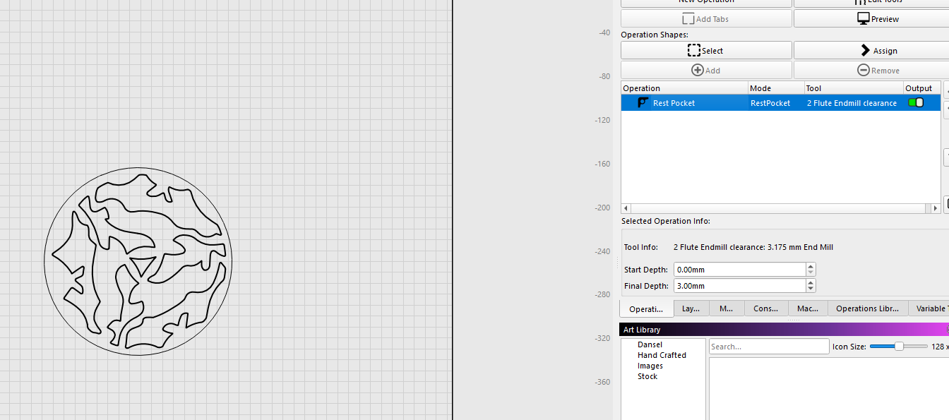

Hi all, I have seen a similar post to my question but no resolve as yet.
I have a rest pocket profile set with 4mm clear and 3.175mm rest, my understanding is that the rest path clears all that the 4mm bit cannot clear.

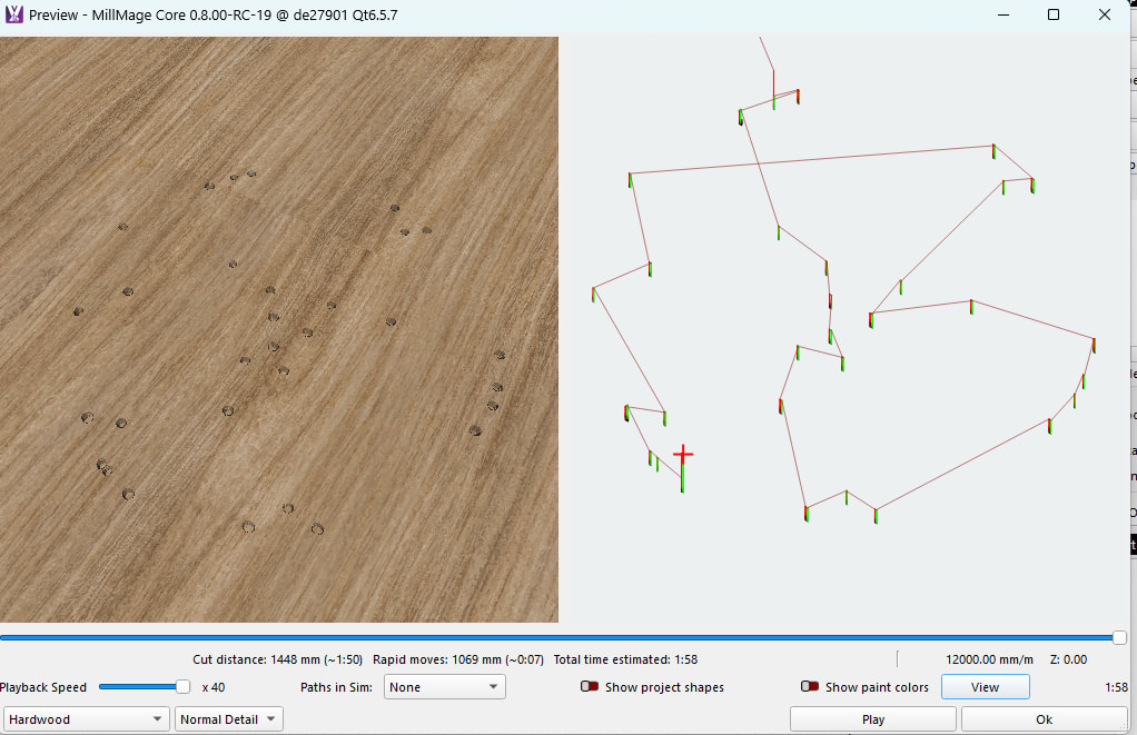

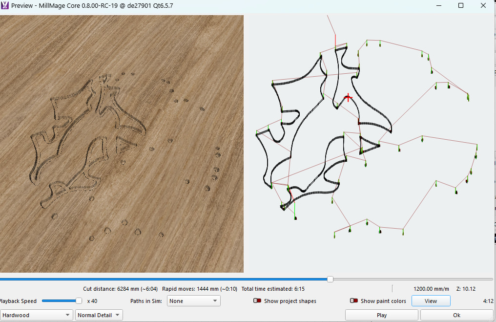

My preview for the rest path shows all the correct rest clearings but then follows up with a profile pass of the entire profile without ignoring the 4mm clearance setting.
This preview shows part way through the rest operation as I would expect at 2.24
From 2.24 to 5.34 shows what I believe should be ignored, it can’t be a preview glitch as the Gcode shows the entire pass. I’ve stopped the preview early to make my point clearer to visualise.
I’ve tried all sorts of permutations with no success, file attached if anyone is interested.
Rest pocket.mage (127.6 KB)
Cheers

Thanks for your reply, as it happens only this morning I have found the reason behind my frustrations. Funnily enough it was nothing to do with tool sizing’s, in my particular situation it was all down to the offset/raster options in the rest settings.
Up until now I had the rest set to ā€˜offset’ which resulted the desired rest operation but then it would run a full profile pass of all the selected shapes when I only wanted the rest path, and the run a separate profile pass to finish.
I changed the rest option from offset to raster with no outline and BINGO, all ran as I would have expected….question now is….this is my first use of a rest operation but is there something wrong with the rest settings?

I go into the rest settings, it comes up with ā€˜offset’ by default giving this preview (I’ve stopped the pass half way through to show the rest followed by profile pass which is not what I wanted)
Now if I toggle from offset to ā€˜raster no outline’ then I get this (What I expected)
NOW….if I go into the rest settings again and toggle back to ā€˜offset’ I get this. Hoorah!

This was a bug that was found and fixed already. Since you’re still using the RC, and not the released version, you’ll still have many bugs that have already been fixed. :slight_smile:
(the ā€œoffsetā€ pocket method was seeing the ā€œrasterā€ outline option and running it - offset will no longer run the final pass)
