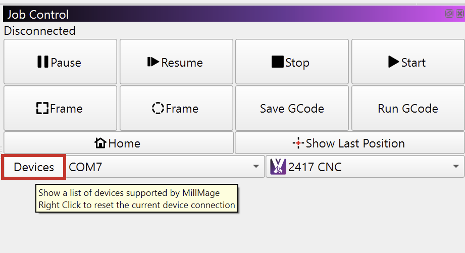

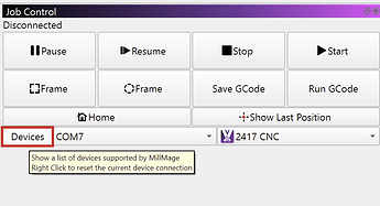

A right click on the “Devices” button in the Job Control Window resets the current device connection and has a similar effect like restarting MillMage in this regard:

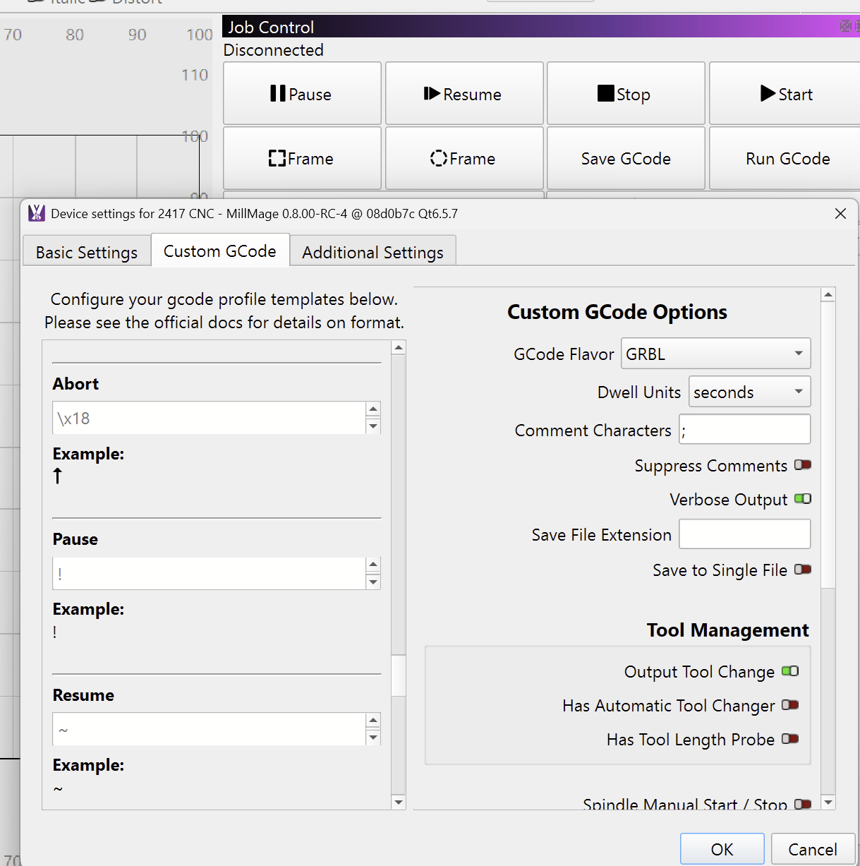

Which command MillMage sends to the controller when you hit the Job Control buttons can be defined in the “Custom Gcode” tab of the Device Settings:

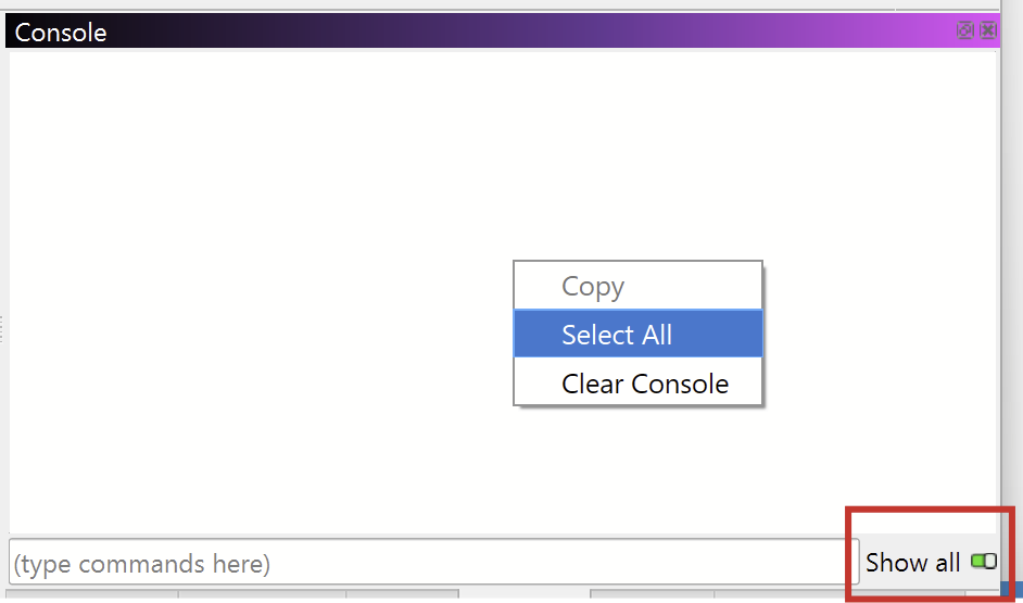

There should also be some error messages appearing in the console. To get a better understanding of what’s going on, please:
  • Enable “Show All” in the console window
  • Repeat What you were doing until the controller locked up
  • right click in the console window and “Select All”
  • Copy the text and paste (Ctrl+V) it in a reply here
