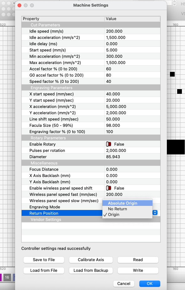

You don’t specify what kind of machine you’re working with. On a Ruida controller there is a setting in machine settings labeled return position.

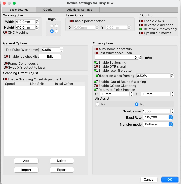

On a diode laser (GRBL) there is a setting in Device Settings labeled Return to Finish Position. You can enable and set that to whatever position you desire.

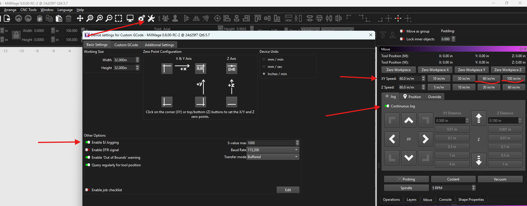

One thing I discovered for jogging the X and Y axes is using the ‘Continuous Jog’ feature.
You’ll need to enable it in the device settings first. After that, I usually stick with speed settings of 60 or 100, which have worked well for me.
However, you can enter any speed you like—I’m just not sure what the maximum limit is.
