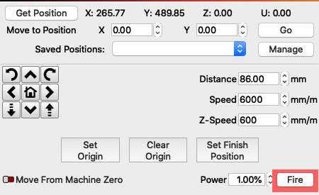

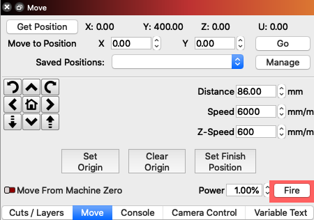

This was the move window immediately after “Go to origin”
Screen Shot 2023-10-22 at 1.44.45 pm
And this is after selecting “Get position”
Screen Shot 2023-10-22 at 1.44.56 pm
I think on a machine without home limit switches, “origin” is wherever the laser head is when you connect to Lightburn…unless you set a new origin.
I think.
Try first explicitly doing a “Set Origin” at a desired location before “Go to origin”.
What are the results of “Get Position” at that point?
The root of the problem seems to be the difference between Machine Position and Working Position but I’ve never seen this be an issue while using $10=0.
