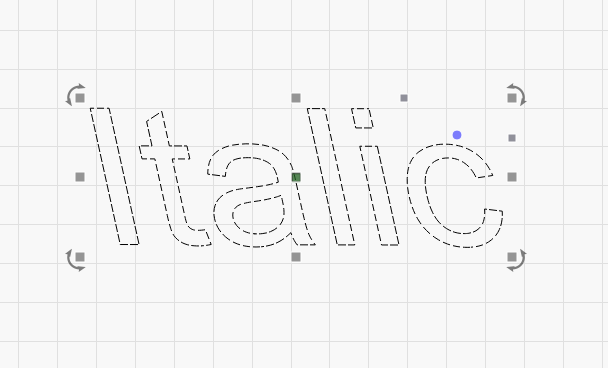

You could try this.
Create your text, go back to select arrow and select text and grab this handle.

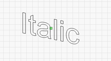

Change the text to look like this.
Grab this handle and turn it back to horizontal.
That what you are hoping for? I have not seen a reverse italic selection in lightburn.

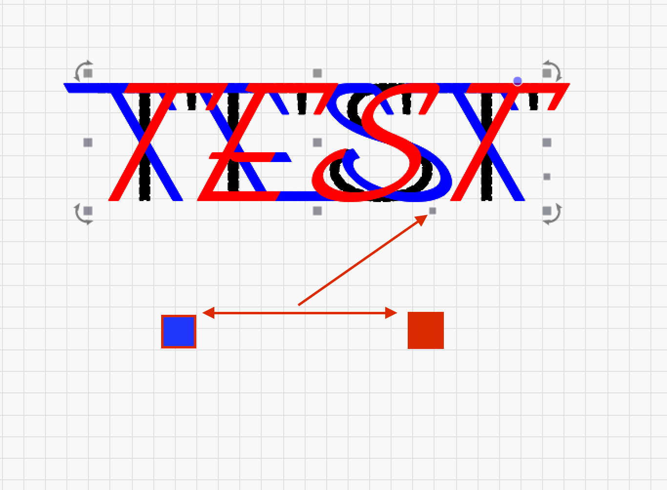

If you use the second small dot, there is no need to correct afterwards
That works better. Now why is your dots vertically flipped compared to mine??? Not that it matters.
My origin is top left, that’s the only explanation I have. If I try to change it to the bottom left, they change the control buttons.
Makes sense. As long as they show up, that is all that matters.
