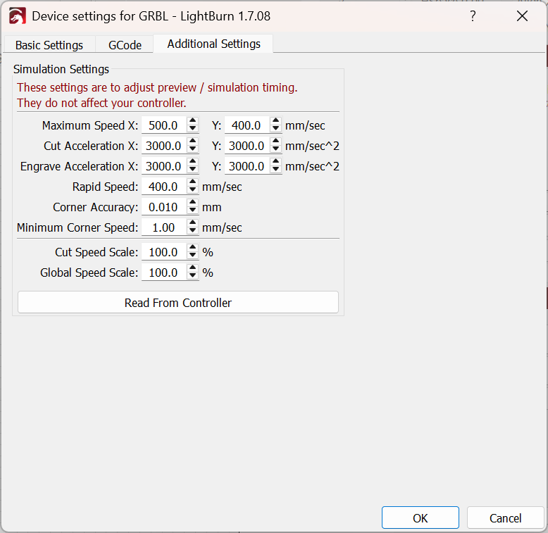

Most of the team is off to LBX at present. Can you share what device settings you’ve configured for your CNC? A screenshot will do.
Thank you. Can you also specify what device you’re using?
And sharing your device profile (file ->bundles->export bundle, select only the device you’re having a problem with) would really help us as well.

I am running a FoxAlien Vasto.
Lightburn export.lbzip (4.8 KB)
GRBL export.lbzip (4.8 KB)

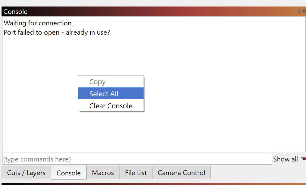

Machine homes in the front left. How do I find the “output of the $$” in the Gcode console?
With your device connected, enter $$ in the Console Window
Your laser’s controller will reply with the $-values from the firmware.
Then, right click in the Console Window to “Select All”, copy and paste it in a reply here.
