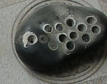

Trying to drill hole on those river rocks.

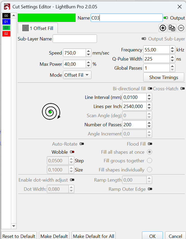

I am using a JPT MOPA 300W on a 110mm Lens.
Air assist pointing downward.

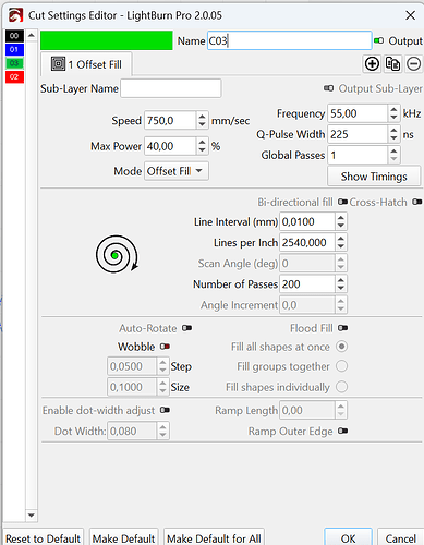

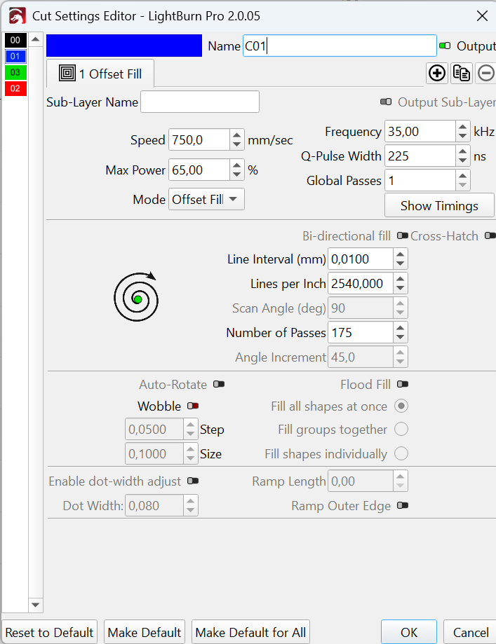

Digging stops after 4mm. If I go higher the rock vitrification starts. If I stay or go lower nothing happens. Wobbling makes vitrification fast so I stopped using it.
I use Offset fill seems to work better then Fill.
If anyone has any tips or tricks for this job. I think I’ll have to use a drill for the rest. But i’m sure it is possible.
Do you have a longer lens? Blasting holes in river rocks may work acceptably well with a larger field, and having more depth of focus would likely serve you well.
Personally, I find I use my longer lenses more often for depth of usable focus than for their larger field sizes.
Thanks, Rock getting hot I suppose. I wonder if cooling period at 3mm would allow further digging or air maybe there was a buildup of dust in the hole.
