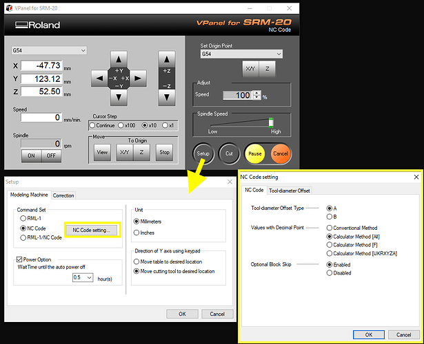

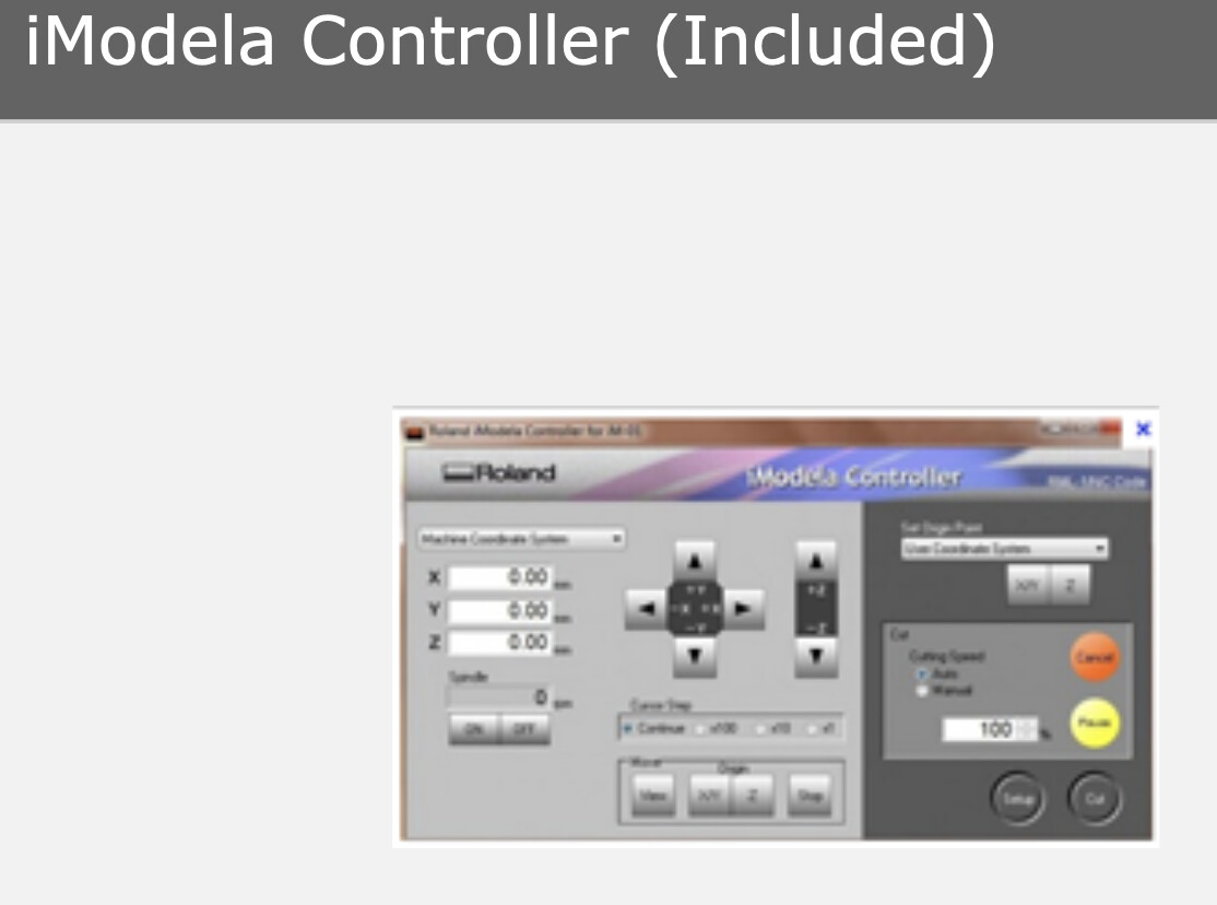

I recommend you install Roland’s ‘iModela Controller’ software if you have it:
The software only starts if the machine is connected by USB. And will allow to set your origin and use overrides. If you click on the ‘Cut’ button you should be able to select and start a gcode.nc file that was generated from MillMage.
I have a different model Roand SRM-20 machine and it has a similar control interface but it’s called “VPanel for SRM-20” . It has options for how it will interpret decimal places, yours should be similar:
It’s windows only, though, right? I’m linux/OSX only here..
Yes. Sorry I didn’t realize you were looking for a solution that excludes Windows?
You can still run Millmage on the Mac, however I’d still recommend a Windows PC (an old laptop would be perfect) using the Roland supplied software to connect to the machine and send it the job.
There may be other methods, I can only speak for what I know works well with my Roland.
