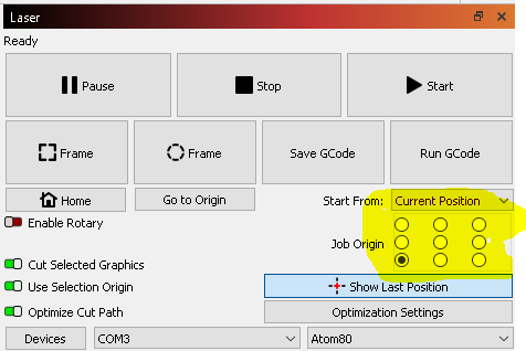

- Try “current position” (better for roller) and select job origin

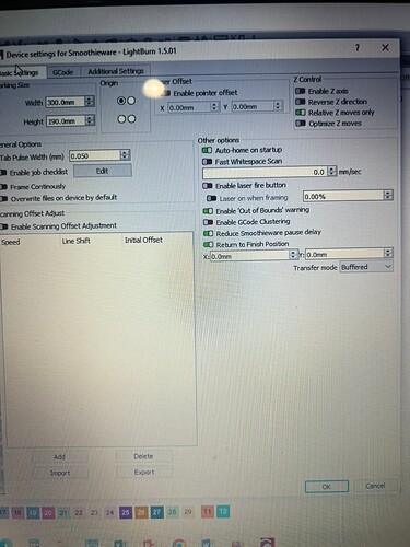

2.disable “fast whitespace scan” or lower scan speed
DONT FORGET TO REVERT TO YOUR NORMAL SETTINGS FOR FLAT JOBS.

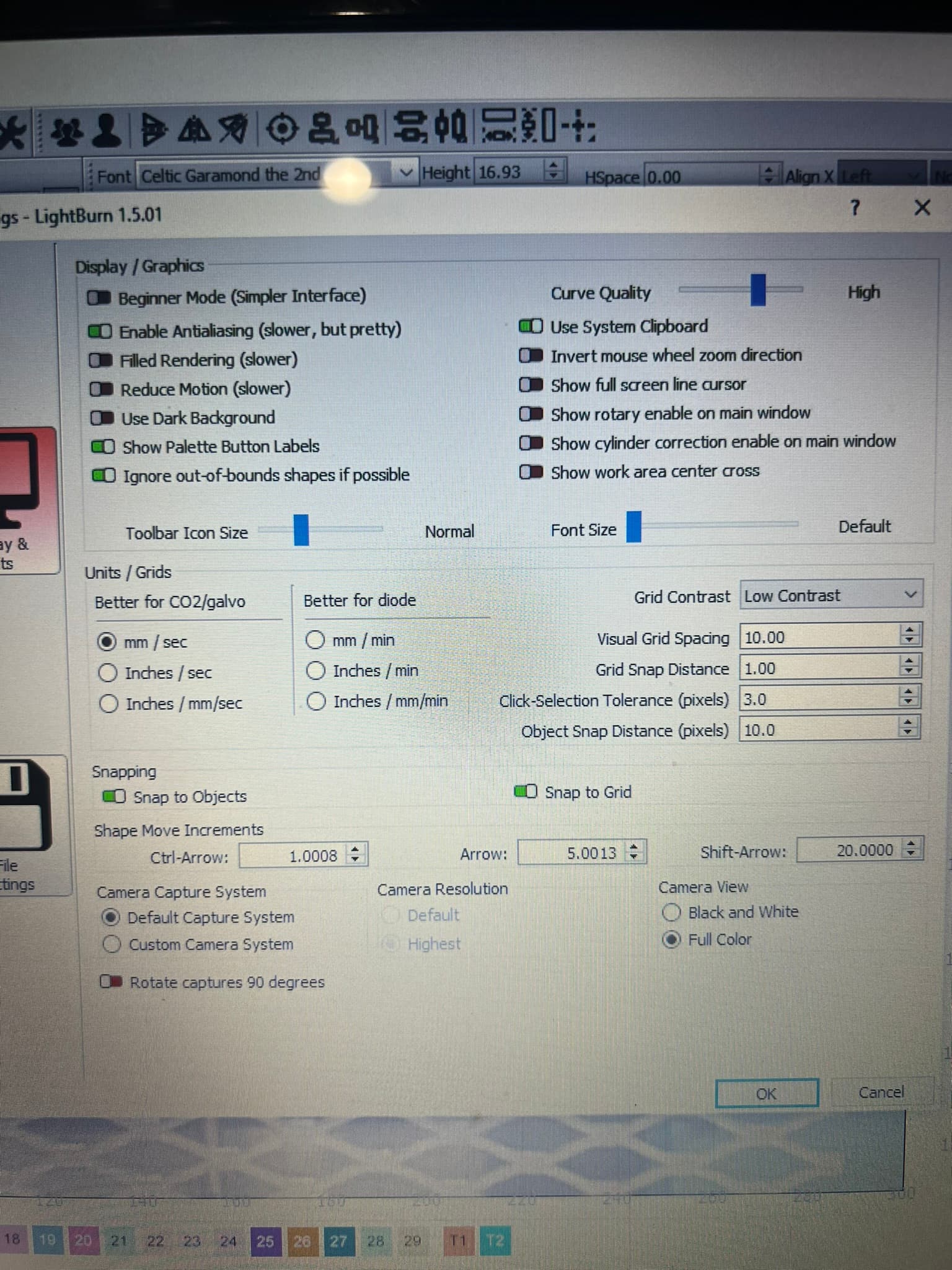

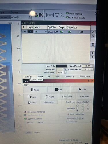

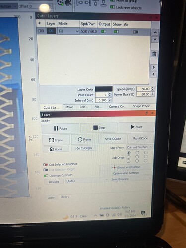

I have all those settings configured but it still spins very fast when it jumps to the next position to laser and sometime at the beginning and end. Below are all my settings.
Were you able to use the roller before and this has only just happened or did it never work?
No it was never used before. Im a beginner. Everything is fine with actual engraving. It is just the movements before and after engraving. Then sometimes while engraving, the movement between letters, for example, is too fast and spins the object on the rotary.
