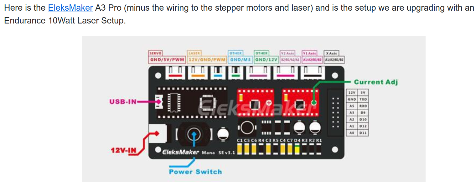

Hi, i try to use my rotary to z axis as i don’t use z axis on my laser and i don’t want every time i want to use the rotary to take out the Y1 and Y2 cables from controller. When i choose the z axis the y axis doesn’t move(as supposed ) but nor the z axis(which goes to rotary) moves. Do i still have to take out the Y1 and Y2 cables? Thanks!!!

This is the posted info for the eleksmaker A3 pro
Where do you propose to plug in the Z axes? This appears to be a 2 axis board.
i have a mks dlc-32 board with 3 axis
Assume the rotary works on the Y axes ok?
If you are running a 3 axis board then you should not have to fiddle with the Y cabling.
Yes the rotary works with y axis. I tried to use the stepper of rotary as a z axis after I enabled the z axis in lightburn but it doesn’t move. Maybe the board needs another firmware. I don’t know yet. But after I manage to enable z axis will I be able to move the rotary and don’t change cables every time I want to engrave a bottle?

Do you have a photo of your board in the machine?
Sorry, I’m totally idiot. I don’t have a driver on z axis. Now that I saw the photo of my board I remembered it. The board came with 2 drivers. Do you think that If I take one of my eleksmana board will fit? I have to see if the switches are in same position. I think all of them are in the upper position. I’ll check tomorrow. I have to sleep for work. Thanks for your valuable help.
