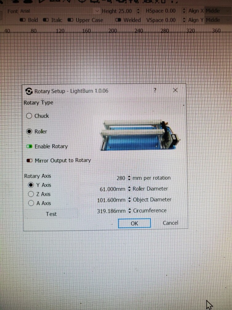

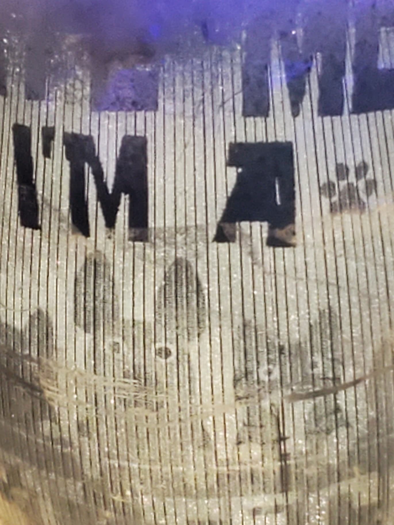

Ortur yyr rotary, and Vevor 4 wheel rotary burning with verticle lines. This just started a few days ago.
Also, it rotates so fast in framing the glasses and cups fall off. Any help would be appreciated.

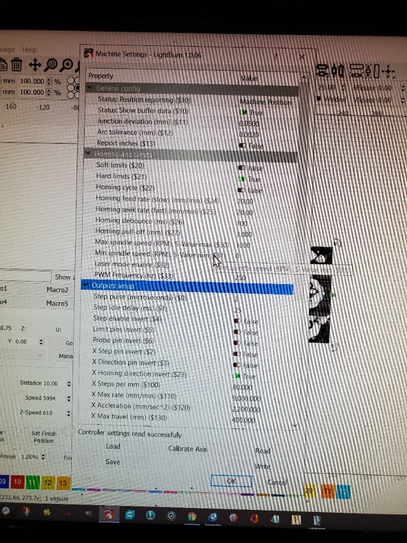

The ‘acceleration’ values are too big. There is not enough ‘traction’ to hold the cup and accelerate it.
When you photo’d the screen of the Machine settings you left out the Y settings.
A screen shot is preferred.
What kind of rotary do you have?
Are you using the ‘Norton’ method?
Are all the surrounding vertical lines OK?
