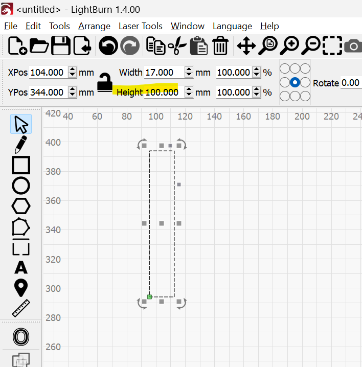

Not following you. The circumference set in the Rotary is equal to the height of the shape on workspace. Since those are the same, that should be the linear distance traveled for one complete rotation of the chuck.
I agree. And the linear distance travelled for one rotation should equal the circumference.

To follow up on the diameter setting in the rotary setup with a chuck, when you enter the object diameter or circumference, that setting applies to the work area of your drawing, it doesn’t affect the distance “Test” travels. “Test” in chuck mode is supposed to rotate a full 360 forward and back to zero.
I understand what the Object diameter and Circumference settings are for, that’s so lightburn knows how to calculate how many step/degrees its supposed to rotate to give the correct linear surface area. You should be able to test this yourself. Set your machine to chuck and tell it to test with a diameter of 1" and watch how much it rotates when you hit test. Now change the diameter to 2" and hit test again. its still going to rotate the same number of times. The “test” rotates what it thinks is a full 360 degrees of the chuck, not the object. I hope that makes sense.
