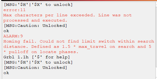

This also happens when framing. Attached is what appears in the console dialog.

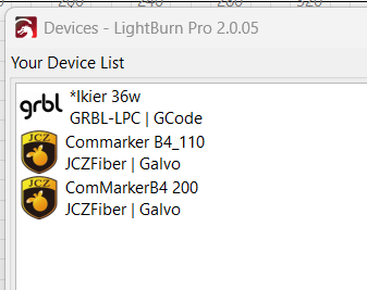

As a start check if your Laser is set as plain GRBL?
How do i check that, and how/why would it change?
Thanks
Create a new device set as GRBL per the docs:

I assume I’m set up as a plain grbl?
This is what my Ikier is named:

Alarm 9 is not caused by Framing. You need to take one issue at a time. For the Rotary, does the chuck or roller rotate once and back when clicking the Test button?
When you try to Home, the rotary will go until it covers the max Yaxis travel while looking for the switch. Then it throws the Alarm 9 message.
You should select plain “GRBL”, not GRBL-LPC.

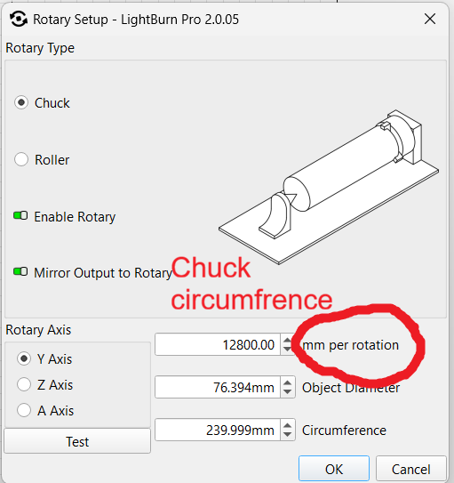

Can you show us a screen capture (WinKey+CTRL+S) of the Rotary Setup wondow?

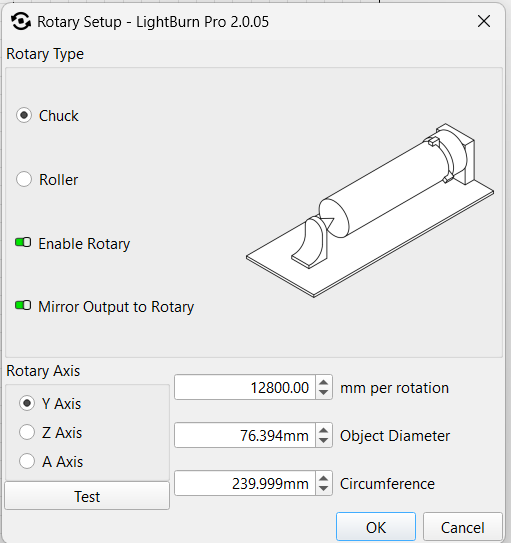

I see that the X axis selection is missing. Don’t know when that happened and I don’t know how to get it back.

A chuck rotates once in the Test. That means the linear distance traveled is the circumfrence of the chuck. You entered 12,800mm, meaning your chuck has a diameter of 4074mm, or about 160 inches. Or a little more than 13 feet.
My setting in that box is 132mm. Try entering 128mm and see how it does with the Test button.
I’m an idiot. I grabbed the wrong rotary manual. It does call for 160mm/ration. After testing, I had to adjust it to 129. Thanks for setting me straight! Getting old sucks.
