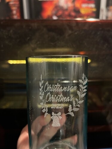

We’re trying to use the 4-wheel rotary tool to engrave pint glasses on our OMTech MF2028-60 and the design is starting out very squished and ending normal/stretched - consistently - squished starts halfway into the design it gets more and more normal.
It’s not squished as a whole - starts squished and ends correctly.
What am I missing? It’s all new to me; just got the engraver a week ago.

I am also quite new to laser engraving machine but did you check that your glass is not drifting, maybe if the rotary wheels are going too fast at the beginning?
Depending on the wheel material, lowering the speed could help maybe. This way you would ensure that the glass is rotating exactly in sync with the wheels.
I would start with this but let’s see what experts will say.
Problem with this is that once it slips anything engraved after that is ‘off’… this is not the case here as far as I can see…
Assuming the left/right probably X axes is top to bottom and Y is around the glass.
From the text, I read that it is the last part of the engraving …?
I see one ‘through’ the glass, it looks mirrored…?
Yeah I was playing with the job origin; not sure what we did but one time of 6 or 7 it mirrored the issue.
Where it started good and then ended squished.
And yes Y is around the glass and X is left/right for the laser.

Are your drive rollers clean?
I got it!!!
I cleaned the rollers and slowed the acceleration.
Perfect marking!!!
