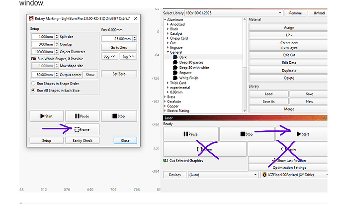

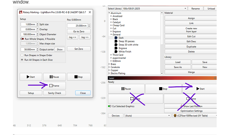

I had a problem with rotary crashing early 2.0, but only when object was way out in the negative end. If I approached it by bypassing framing and just used start, then framed from the rotary window worked OK. For what it’s worth.
