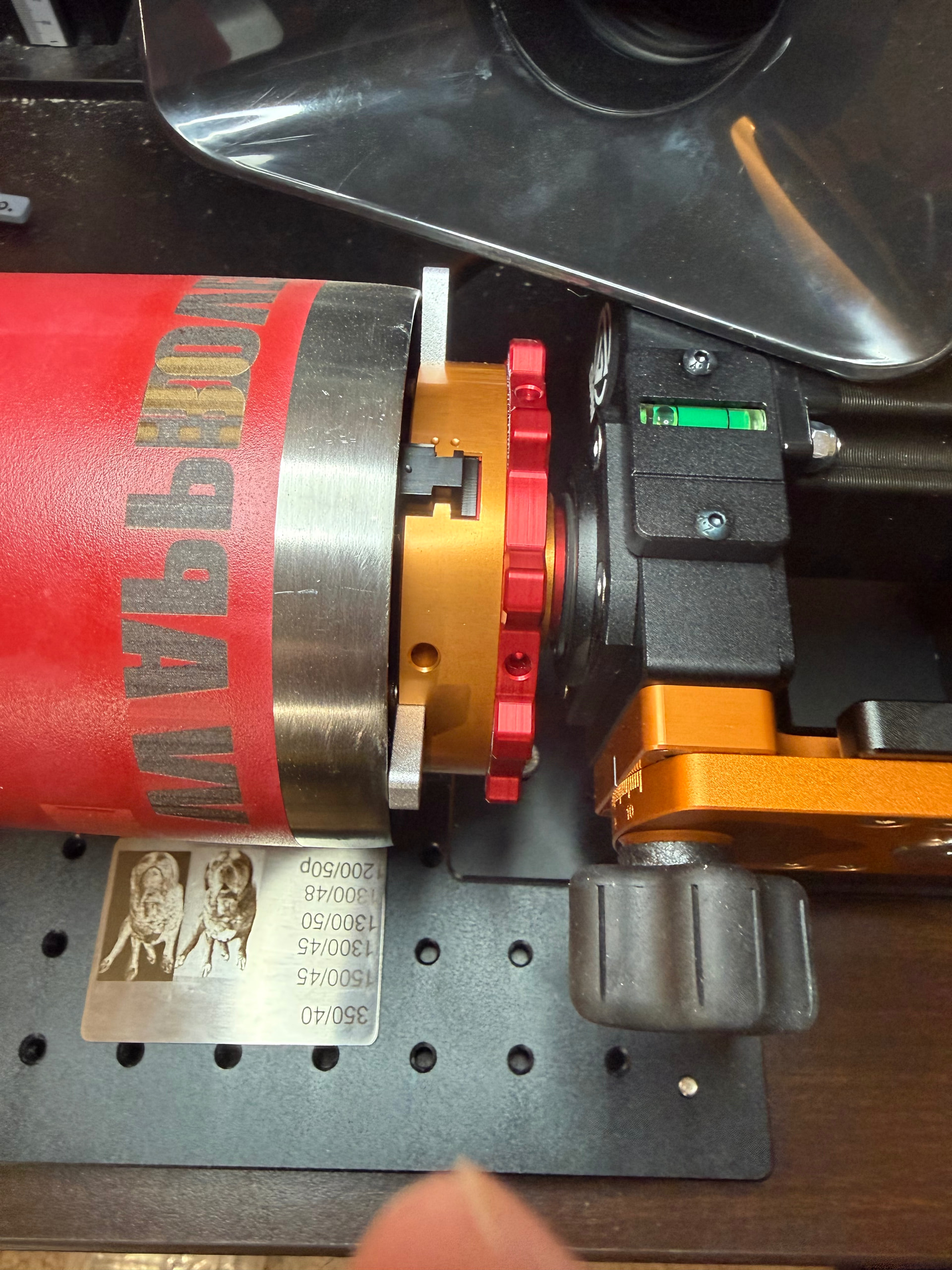

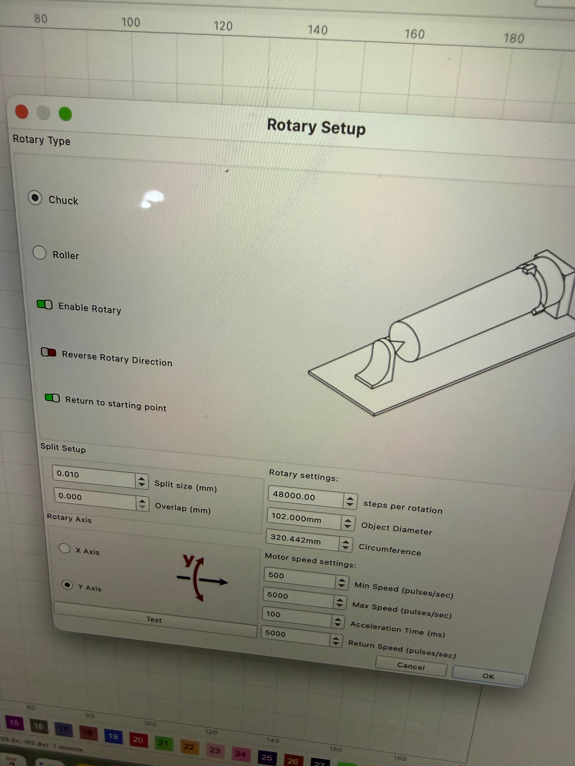

I have an EMP 60W MOPA fiber laser with Grip rotary from Lens Digital. Trying to engrave text on a cup. Text is backwards and mirrored. I’ve tried searching and I don’t have a mirror toggle in the rotary setup. I also searched and saw about changing origin and I don’t have that option either. I know that I may be able to mirror the text on the screen, but I don’t think I should have to do that. How can it just laser what I see on the screen without mirroring.
Try turning the rotary 180 degrees placing the jaws on the left instead of right.
The other option is to swap the A and B fields… Most of the time they like the motor on the left..
