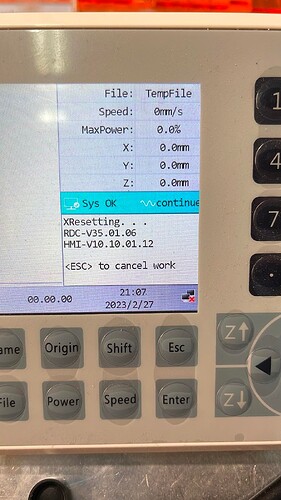

Because my firmware is a lot newer, I tried not to downgrade it.
Then she mentioned that my version (shown below) should have a software selectable axis for the rotary! But in Lightburn, as mentioned, I cannot set the axis for the rotary.
