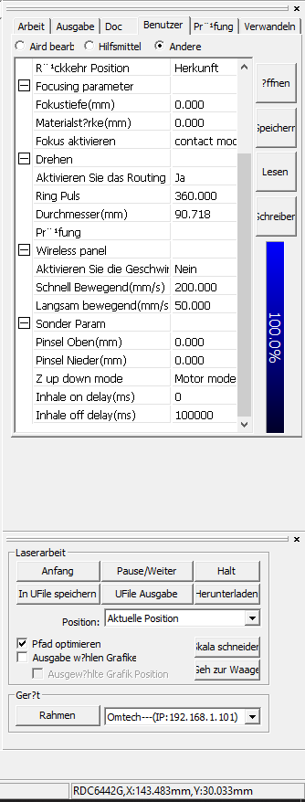

hi, I have modified my Omtech laser a bit so that I have a U axis with the aim of being able to connect my rotary to this U axis without having to lock the Y axis
I can move my rotary manually using the buttons, but if I want to laser, for example, the Y axis moves and not the U axis
Rotary
What do I have to do so that the U axis moves when engraving?
but the Y axis stops?
Unfortunately, that’s set inside the controller, where changing it involves a firmware upgrade and some tweaking with RDWorks:
Unless you have that specific controller, do not attempt to load that firmware.
It may be that your controller already has that firmware, so fire up RDWorks and see if you can tweak the setting.
There is nothing about Y or U in the rotary area anywhere in rdworks
Also, mine is an RDC 6442G controller and I have no idea what firmware I should use
Then, AFAICT, you’re out of luck with the U axis rotary thing.
Which is a shame, because not gimmicking around with the Y axis wiring seems like a great idea.

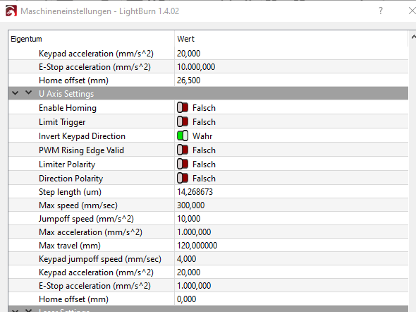

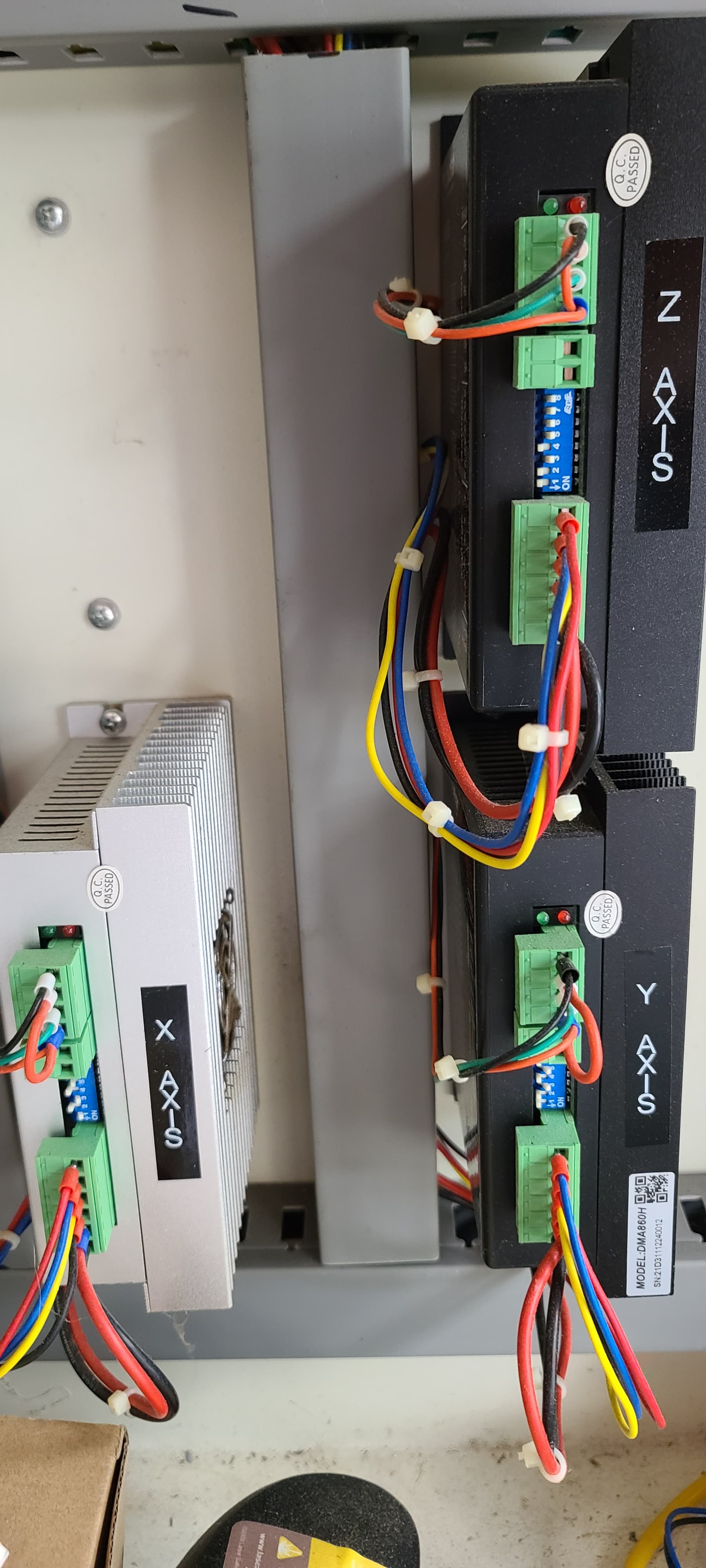

My problem is that my stepper motor gets pretty hot and I don’t want to constantly have to change the dip switches (stepper drivers) so that my rotary doesn’t get hot. With the U axis you only need to do this once when making it
How can lightburn correctly control all axes manually (with the buttons)?
And why does the U axis have its own settings that can be read from the controller?

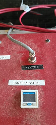

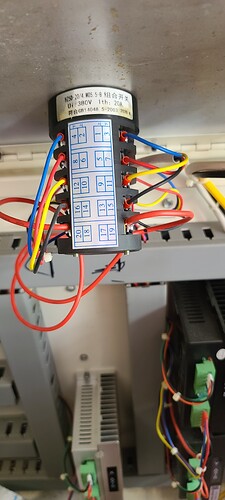

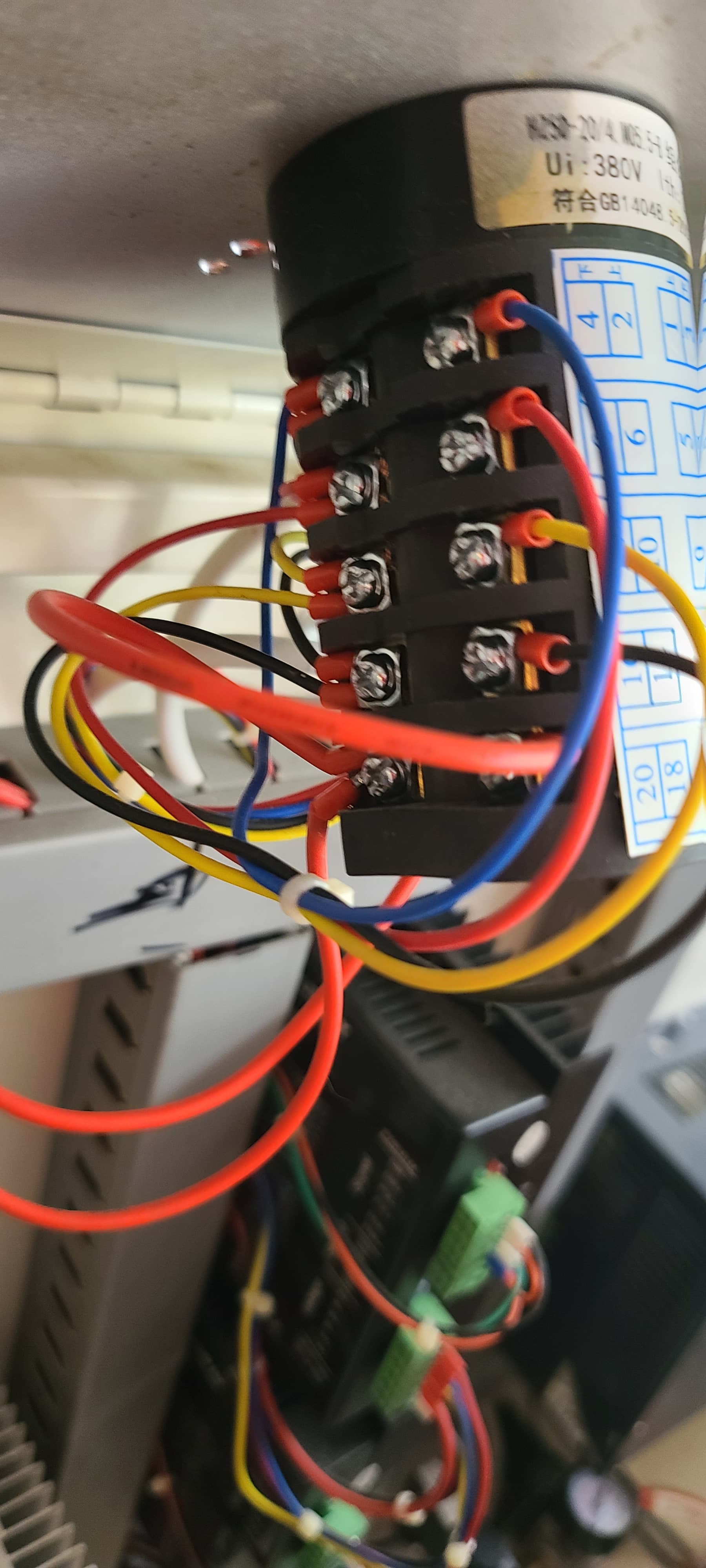

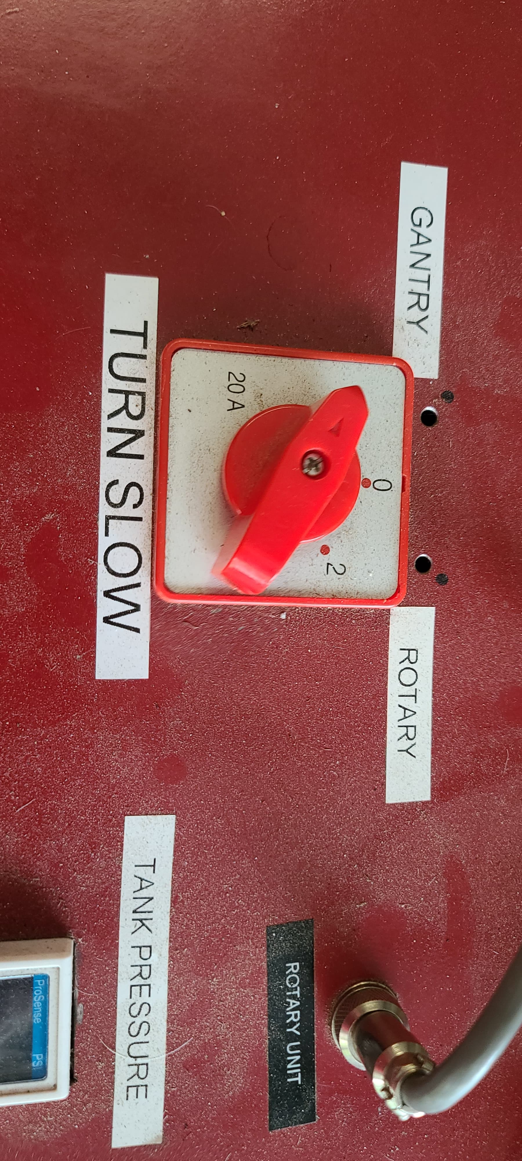

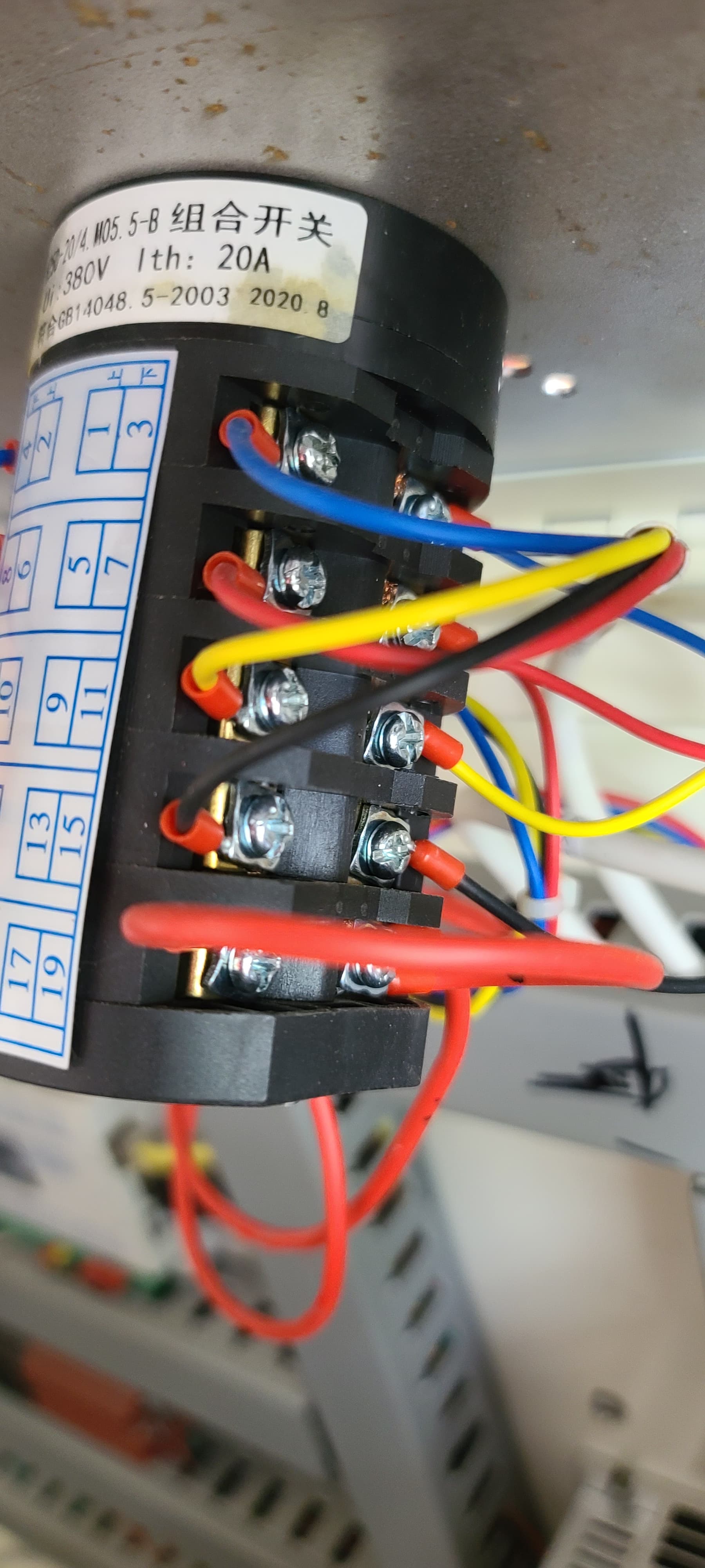

I tried that in the beging using the u axis but gave me trouble.

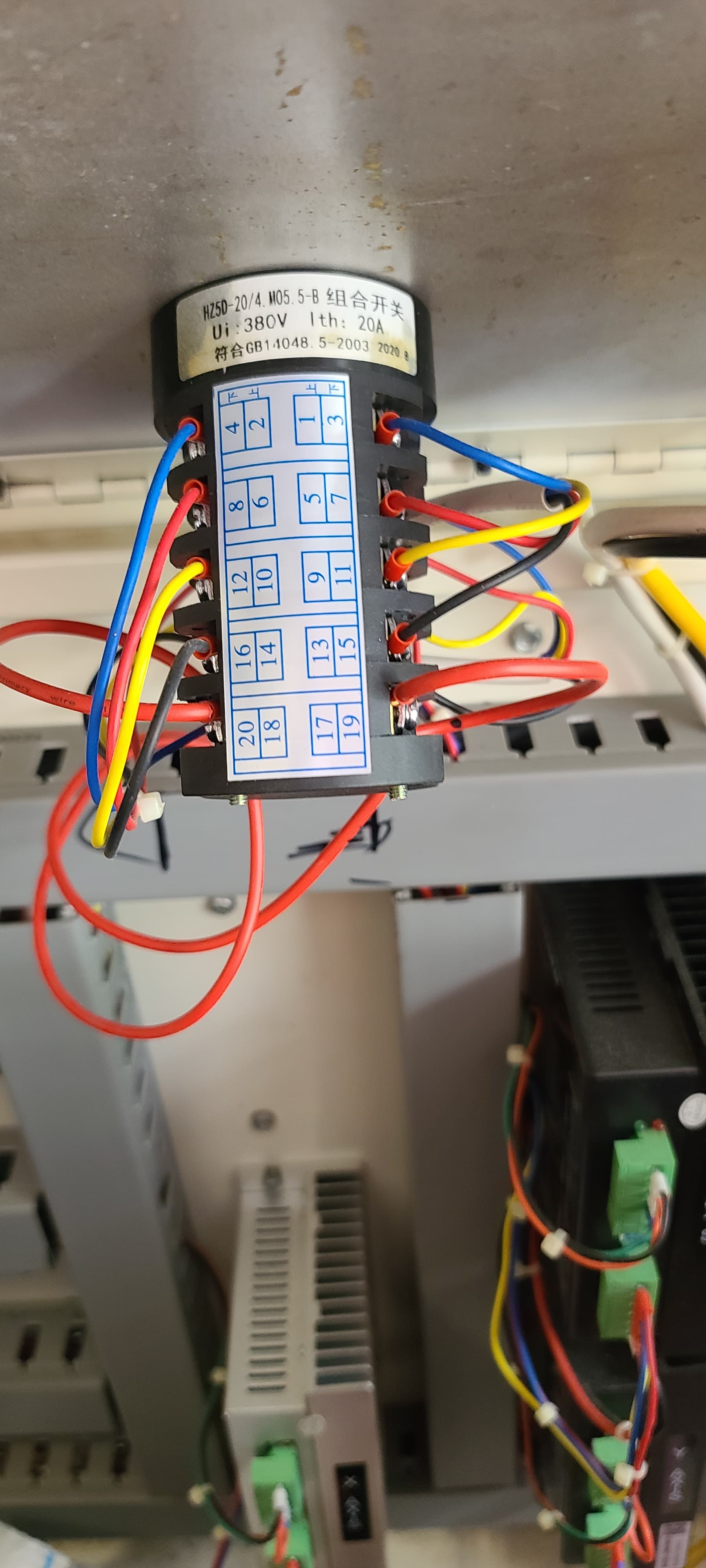

I went back to using the y axis what i did was add another stepper driver just for the rotary with a selector swich to switch from the normal y driver to the rotary driver and never had a problem one the driver was adjusted.
