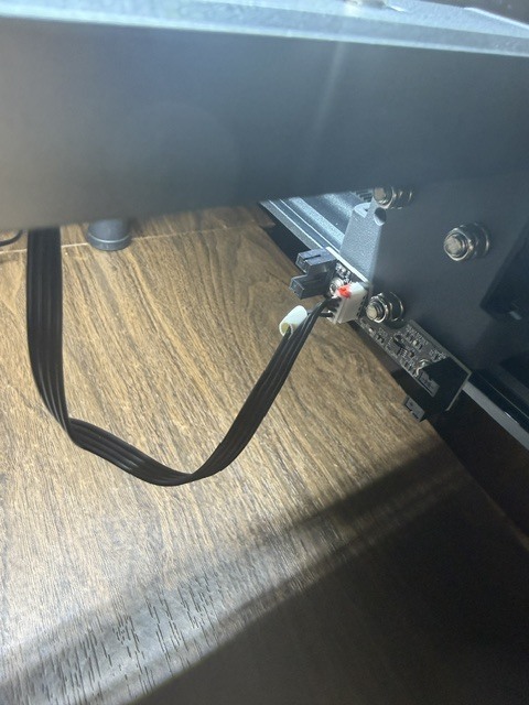

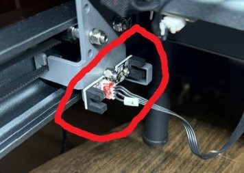

Can you post a photo of the limit switches?
Correction…this is the error when trying to jog left/right:
Jogging up/down makes it vibrate. Won’t let me upload the video.

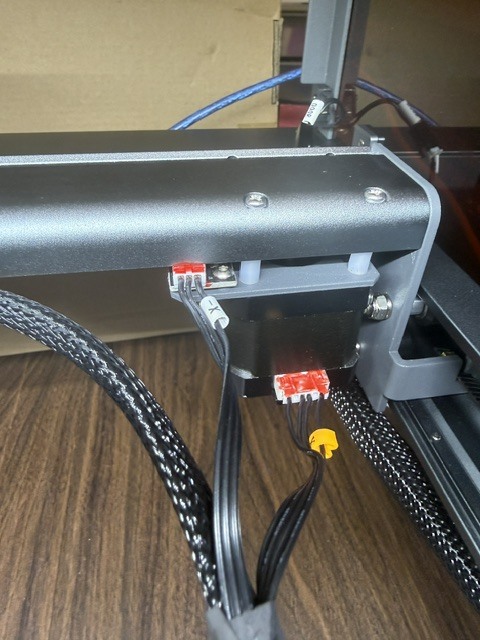

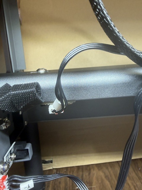

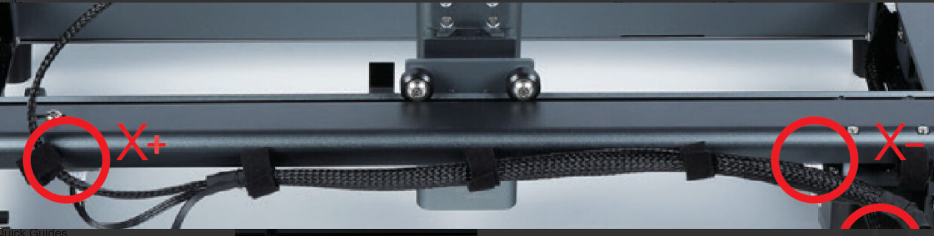

You have to check the switches here:
If they are stick or have something in the optical path.
Connected and clear.

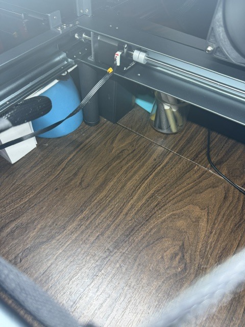

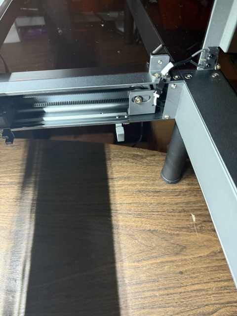

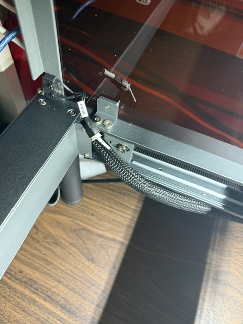

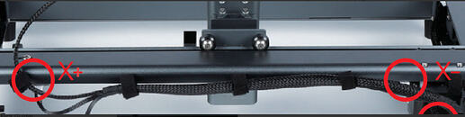

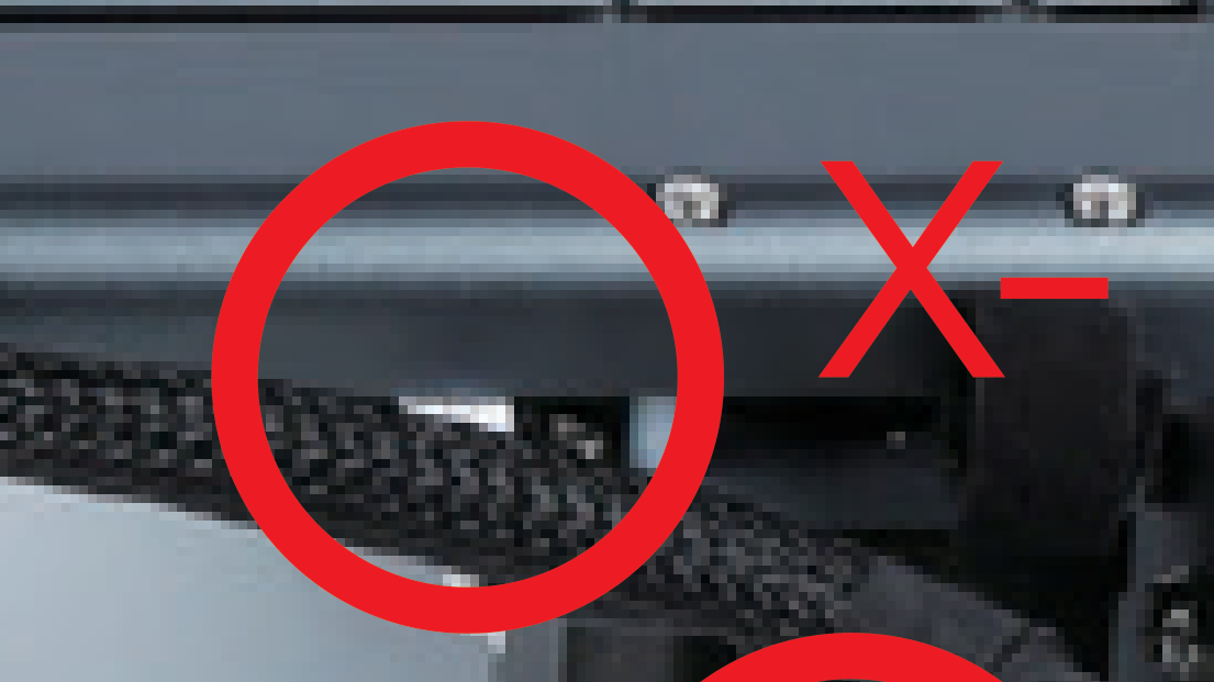

That is only the connections the switches are under the X gantry.
You have to remove the screws( maybe 2 per switch) and check them.

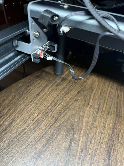

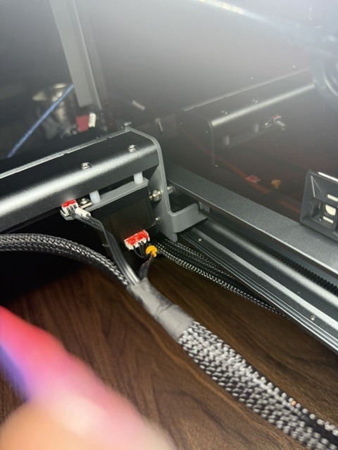

That first image in posting #6 is what you are looking for. The little black thing with the slot in the middle. It appears you have optical rather than mechanical lever switches.
So, what am I to do with that? There’s nothing obstructing it. Indicator light responds when the x-bar is placed at both ends.
Put the trolley (holding the laser module) in the middle of its travel. Enter ? in the Console window.
If you see that |Pn:X| in the MPos: line, then the sensor is bad, no matter what the blinky lights say. This means you need to contact LokLik for a replacement.
Until this is fixed, nothing else is going to work because you cannot turn off the Home cycle option.
That one is the Y switch.

Unplug the X+ and enter ? to see if you get ride of the Pn:X
Like @parsec said, ? instead.
Apologies for that oversight. Uplugged X+ and hit ?
Not sure what XD is, but I am guessing it means X Disconnected. You can’t test the X-limit switch if it is disconnected, right? You also show it is at 0,0, so it could be close to a limit switch. Move the head out in the middle, with everything connected, and do the ? thing again.
