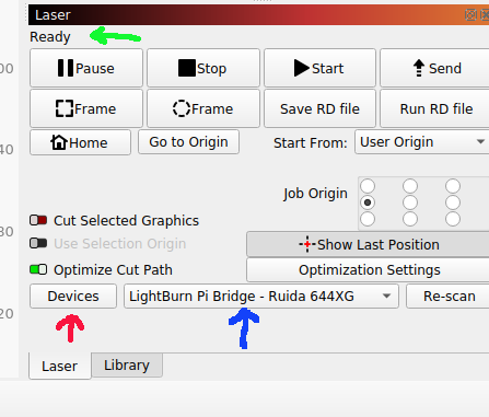

I use USB. I’ve been using this laser, piburn, cable and all worked until I updated Lightburn. Now it says “no device found” at the bottom of the LB screen. Where do I right click “devices”?
The green arrow shows the communications status. The red is the ‘devices’ button.
Screenshot from 2022-03-23 09-46-43
What is selected in device type (blue)? Ensure this is set properly.

Reconnecting the device worked. Now I am able to set rotary settings.
