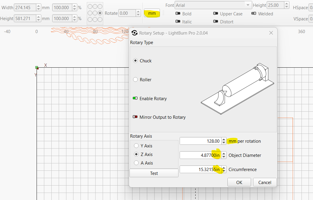

Does anyone know how I can get this issue fixed? Used to be that if I had selected “mm”/Metric, my rotary tool setup displayed all in metric. After I upgraded to 2.X it is split between both standards. Is it a Windows issue or LB?

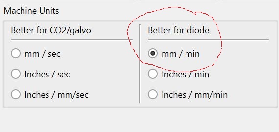

What is your selection for Machine Units in the Device Settings window? I think that bottom one may give mixed Units in some Lightburn windows.
That’s because the mm/rotation is kind of a firmware / laser dependent setting. All values in firmwares are in the metric system. Like steps/mm. You will never find steps/inch.
The other two are “user dependent”; it’s just a calculation help, and LB will translate all inch measurements to metric units internally (since only metric values are sent to the laser).
Starting with version 2.0, Lightburn changed how design units and machine units are adjusted.
You guys are awesome! That’s where it was. In Device Settings. Thanks!
