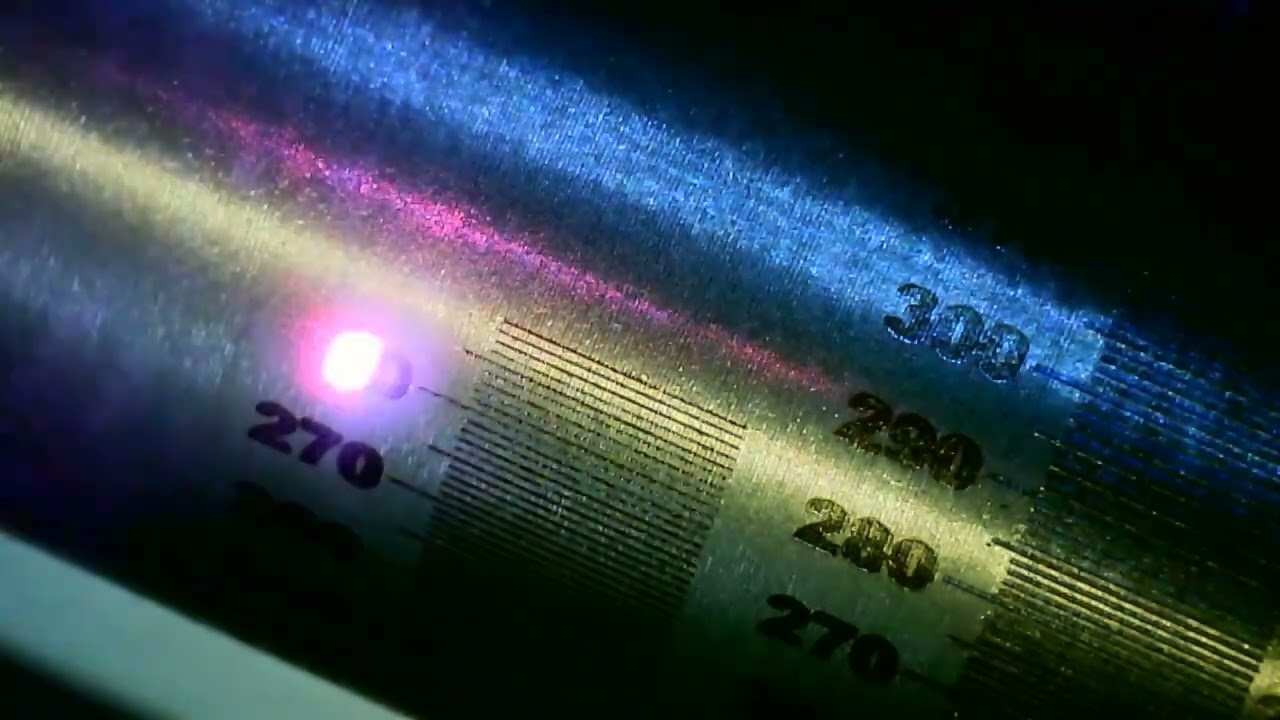

I am trying to set up my rotary on a HaoTian UV Galvo and the steps per rotation should be 48000 which also match the test in lighburn (y-axis) as it rotates exactly 360 degrees. However when I do a test line at 100mm it only engraves 93mm. In order to engrave 100mm I need 52200 steps per rotations, but at that number the lightburn test 360 rotation is way off.
I have no idea what could be causing this discrepancy. I have randomly played around with other settings, but always get 93mm.

Sounds like your scale is off. Do you get exactly 100mm on the flat? What are your rotary settings? Another great test is make a shape exactly = to the circumference and see if it closes. First minute of this video is a good example of closing a full wrap,
So that may seem strange at first, but, in the “Closing the shape” test the software calculates the length of engraving to equal 360 degrees, so regardless of actual circumference, IF the object on the screen equals the dimension that is input into the field, the rotary will turn 360 degrees. (If steps per rotation are correct). Next test would be wrap a string around the wrap and measure.

I have used this whiskey glass for years on my co2 laser roller rotary and I know the diameter of 89mm is correct, however that was also my downfall, as it actually does have a little bit of a taper that I have never had to worry about, so it didn’t cross my mind.
