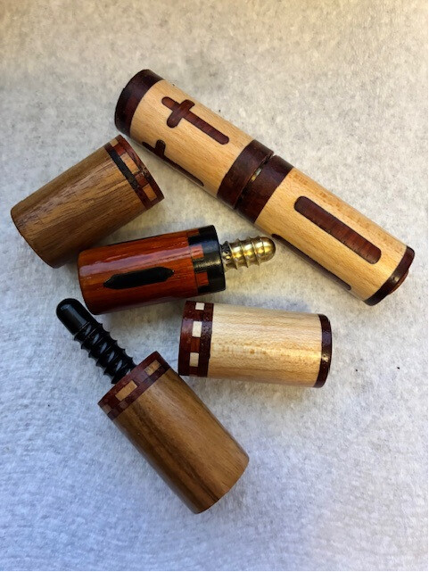

i have been using MM since it was released; for a 3 axis lathe, everything works
great, i just use the y axis for my turning and x for left right and z. i turn down, and do inlays
on round objects with no problem. i will try out the v-carving soon :grinning_face:
wow really, cool :smiley: would luv to see some photos of what you have done, been wondering if anyone has given it a shot and come up with a way to run it.
for your shape do you draw single shaped line an use profile operation to control how it would run
i turned these down from 1.5x1.5" turning blanks
