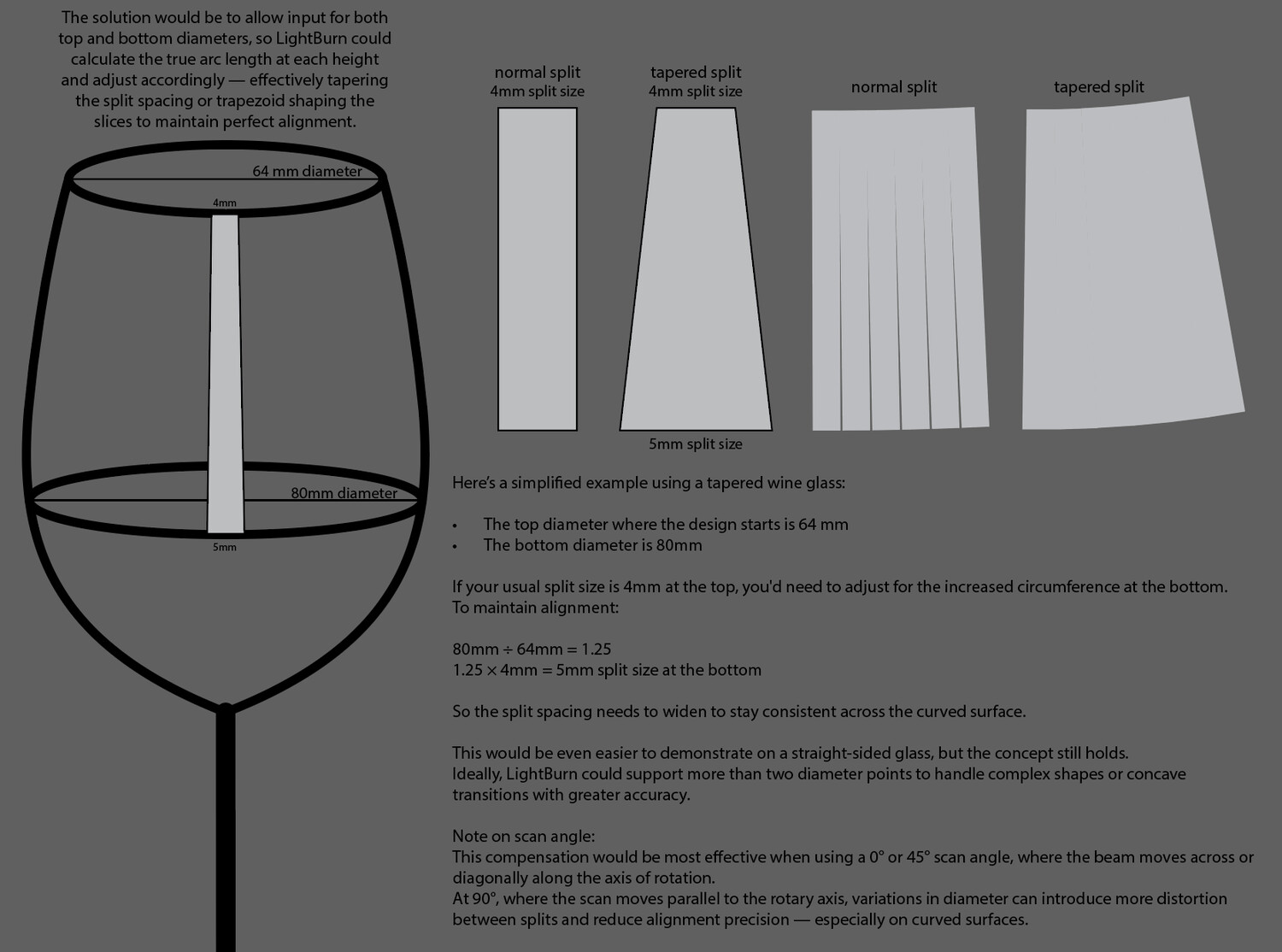

Add the ability to input both a top and bottom diameter in the rotary setup. LightBurn could then calculate the true circumference at each engraving height and taper the width of each split accordingly—effectively turning each slice into a trapezoid that matches the surface it’s covering.
This would keep the engraving perfectly aligned all the way around, even on curved or tapered glass.
Here’s a more complete visual explanation:

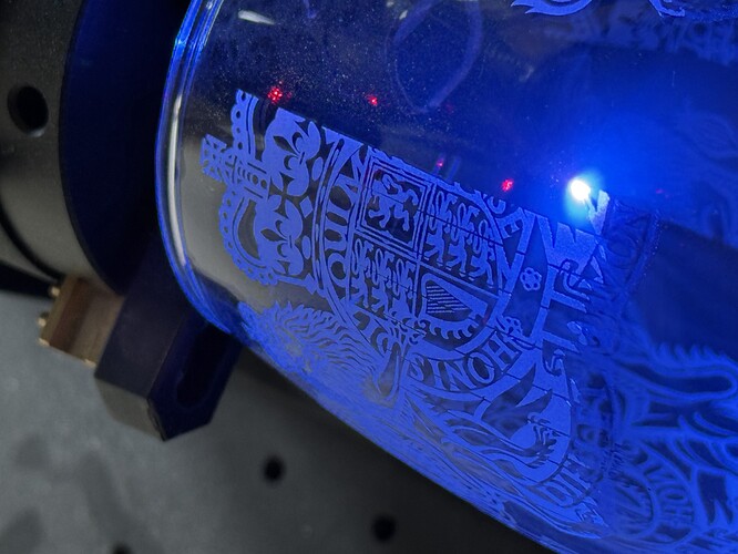

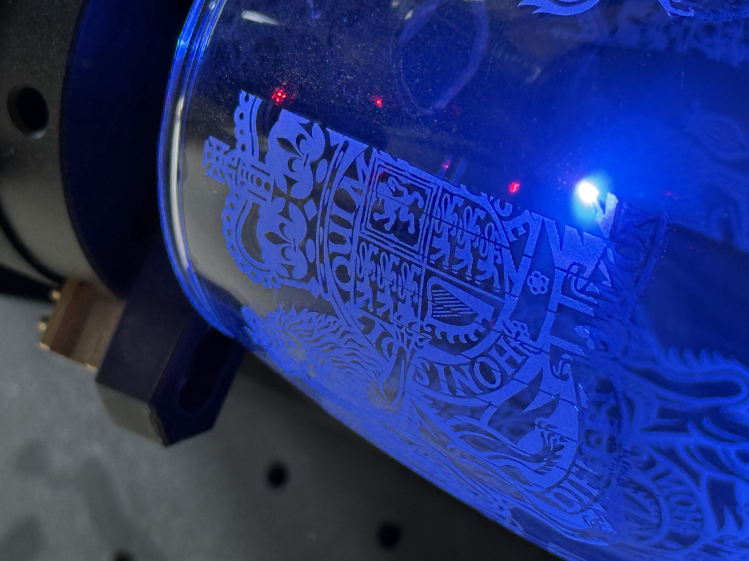

Especially with the Omni 1 UV laser, the engraving quality on glass is incredibly clean and detailed when using a 0° or 45° scan angle. It closely mimics the appearance of sandblasted designs. This works best when using larger split sizes to reduce visible transitions—but that only works well on flat or cylindrical objects. On tapered glass, those same large split sizes introduce visible misalignments.
Most people compensate by using very small split sizes (like 0.1mm), but this introduces many fine lines into the design, breaking up detail and creating an unnatural look. A tapered split system would maintain both visual smoothness and alignment, allowing us to use the wider split sizes that give the best result.

  • Taper Warp only warps the artwork. It doesn’t influence how the rotary moves or adjust step distances between slices.
  • Overlap helps close gaps but does not account for variable arc lengths—overlapping too much in one area and not enough in others.
  • Yes, you could manually compensate by warping and modifying the artwork by slicing ‘wedges’ from it, but this is tedious and doesn’t scale for production.

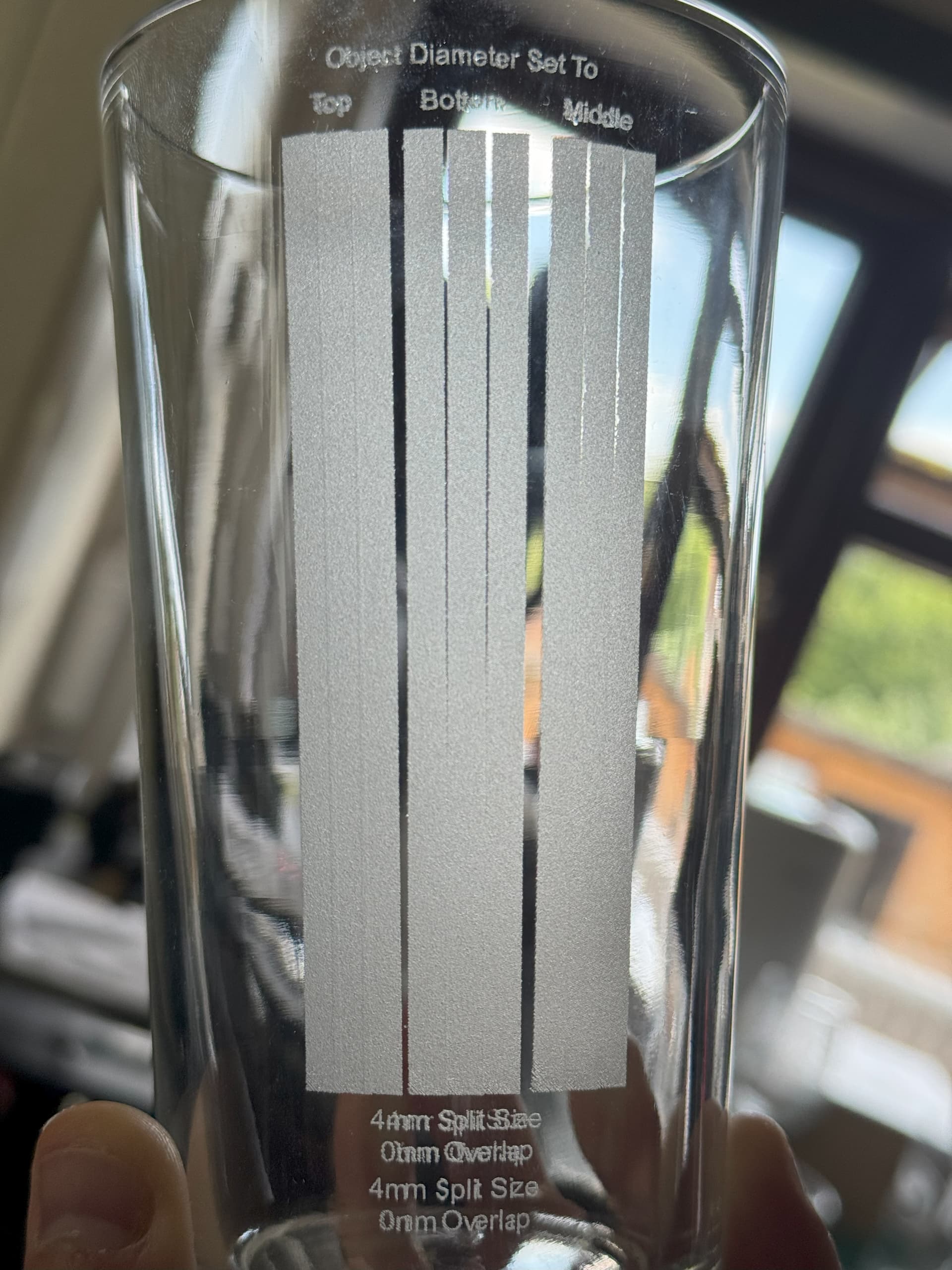

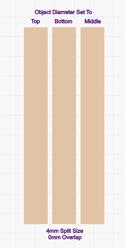

(Example below shows three rectangles (each are 12mm in width, and set to 4 mm split size) engraved on the same pint glass with the object diameter set to the top, middle, and bottom diameters respectively. You can see the one set to the top diameter overlaps at the bottom, the bottom-diameter version leaves gaps at the top, and the middle-diameter version shows both an overlap and a gap—exactly what the tapered-split idea would eliminate.)
