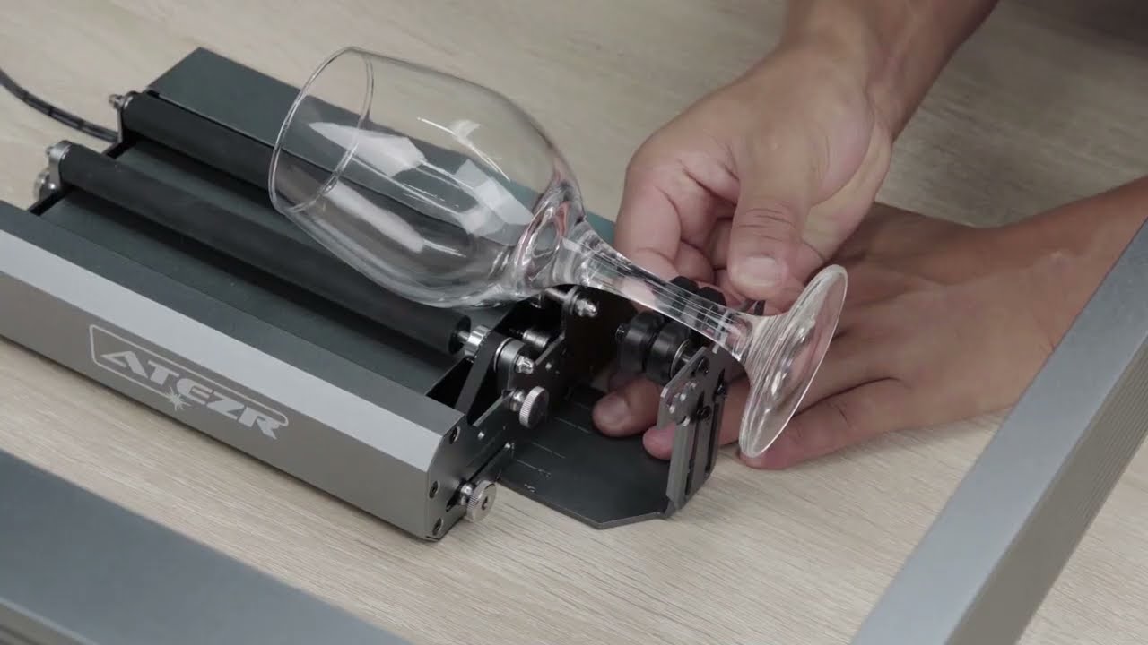

Back again, struggling mightily setting up my Atezr KR rotary tool. Ive made a couple post here, asking for assistance and recommendation but still frustrated. Now wonder if there are places to go to get hands on training or hire someone to actually walk me though the set up both with laser and lightburn ? I live in the Tampa Bay area, if any one knows of a place or someone please sent a link or email address, thanks.
Might add that im doing great at using laser on flat objects, just can’t comprehend the rotary tool.

If you understand how your table works, all a rotary does is simulate the table. All other limits/sizes still apply. The machine, for all practical purposes, thinks it’s just driving the regular table.
You configuration changes the machine or software in that axes to be modified to rotate a certain amount based on the type of rotary.
Think of the rotary as a round table… that’s what the machines thinking …
Steps or degrees/rotation is critical. If the test button is working correctly – it’s configured correctly.
If the test button doesn’t work correctly – there will never be an end to adjusting things…

Update: Met with Bill and we had fun figuring out the roller setup. He actually etched a wine glass. I understand now why the confusion when setting up a roller rotary.
