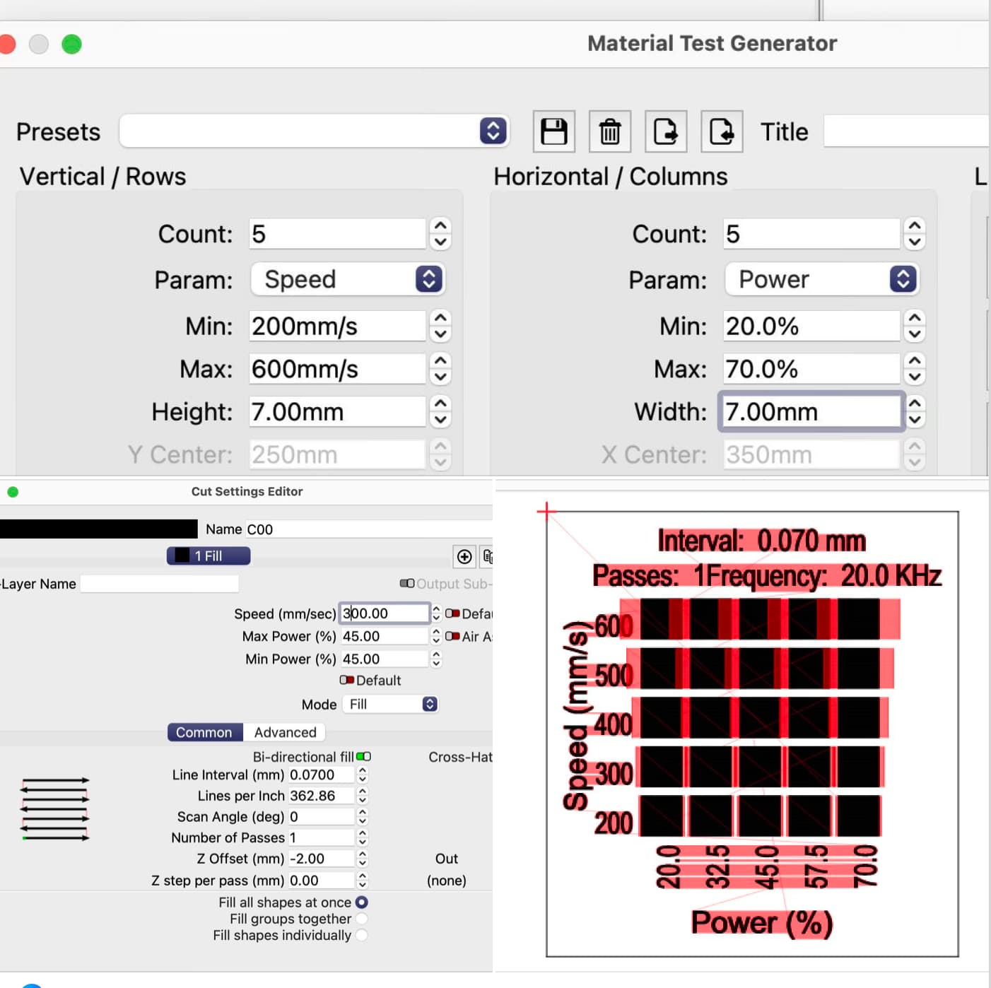

Aeon Mira 7S with RF tube. Using roller end of a LensDigital Omni 2.0. Rotary works fine - I have been able to engrave tumblers but when I go to run a material test, the rotary does not spin and the framing is a rectangle (as if it was a flat material). I know one other person that has had this issue (not resolved). LB v.1.7.07. Settings attached. Any recommendations are welcomed.
Does the Mira use the A axis or Y axis for the rotary? What you’re describing sounds like it uses the A axis, but the material test uses the Y axis. I don’t think you can designate using the A axis in the Lightburn material test. You will probably need to create a manual material test to have it work with the rotary.

The rotary works. I’ve done a tumbler on it. No issues. When trying to run a LB material test, the laser head moves and makes a rectangle in a flat plane which is the size of the material test, but the rotary does not spin. If I hit start, nothing happens even though the preview shows what should happen.
