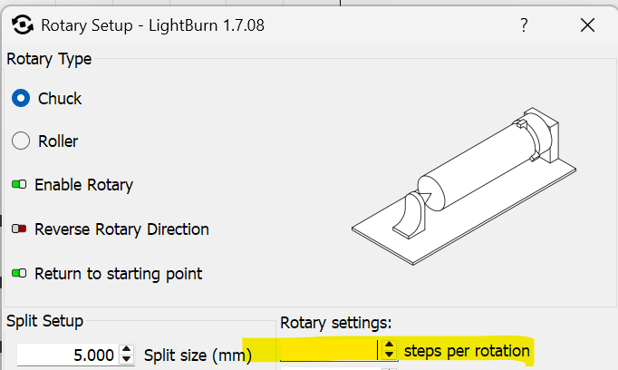

Rotary works in ezcad2 but won't in Lightburn
I have verified the rotary parameters in ezcad2 are the same in Lightburn. The rotary chuck only moves a tenth of a revolution when I click on the test button. It also moves very slow. I am using a Laserstar fiber laser.
Hello Jay,
In the Rotary Setup, multiply the “Steps per Rotation” by 10
The Speed of the rotary is defined below this with the “Max Speed” setting.
Post screenshot of rotary framing and setup windows. Probably something simple you missed. Extra zero or decimal point, mm instead of inches, like that. Assuming the rotary did work correctly in EZCAD.
