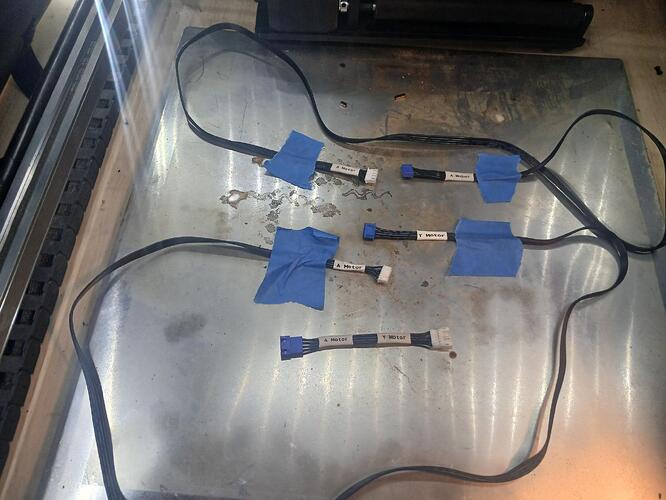

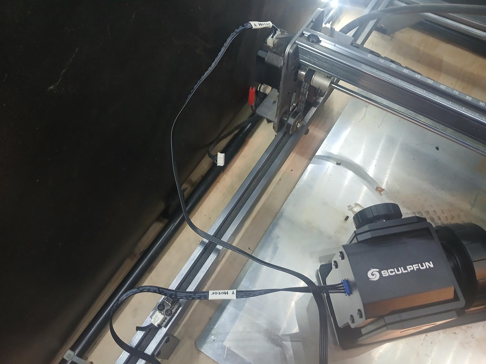

My sculpfun RA Pro Max works on my sculpfun laser but when I hook it up to my other laser the Y axis is not turning. Any Idea what may be wrong and how to resolve this issue. Thanks any help would be appreciated

The picture shows:
  • A dangling cable that was (probably) plugged into the Y axis motor
  • A cable marked "A Motor` plugged into the Y axis motor
  • A cable marked “Y Motor” plugged into the rotary
Is that one cable with two different labels? If so, plugging the rotary into the motor won’t work: it must be plugged into the controller. Perhaps (this is a guess) the “Y Motor” end goes to the controller and the “A Motor” end goes to the rotary?
If there are two different cables involved, then we need more details about what’s going on.
Check to see if your RA2 came with a short extension cable wit the wires crossed on one end.
@ednisley is right, a motor to motor hookup will not work. Back off with the camers and show us the entire wiring hookup.

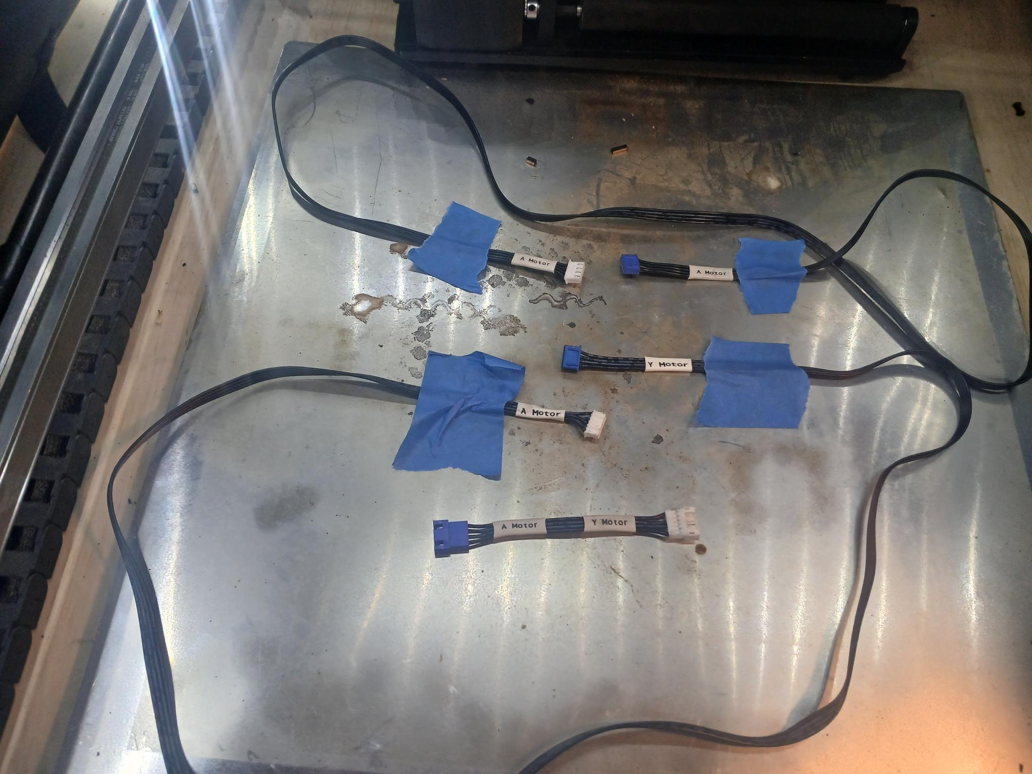

It did come with a short extension as shown.

  1. I have no idea why they used “A Motor” instead of “Rotary”. Maybe for “Auxillary Motor”?
  2. I downloaded your pix, zoomed in, and could see no obvious wire crossover on any of the connectors. That is usually what they do to that short one, so the 2 center pins are switched on one end. Maybe it is done under the shrink labels. Anyhow, add that one to the laser that is not moving the rotary and see if that helps.
  3. It could be that short crossover cable is a boo-boo. Have a test meter?
I could check for continuity on the short wire and that would tell me if they were crossed
