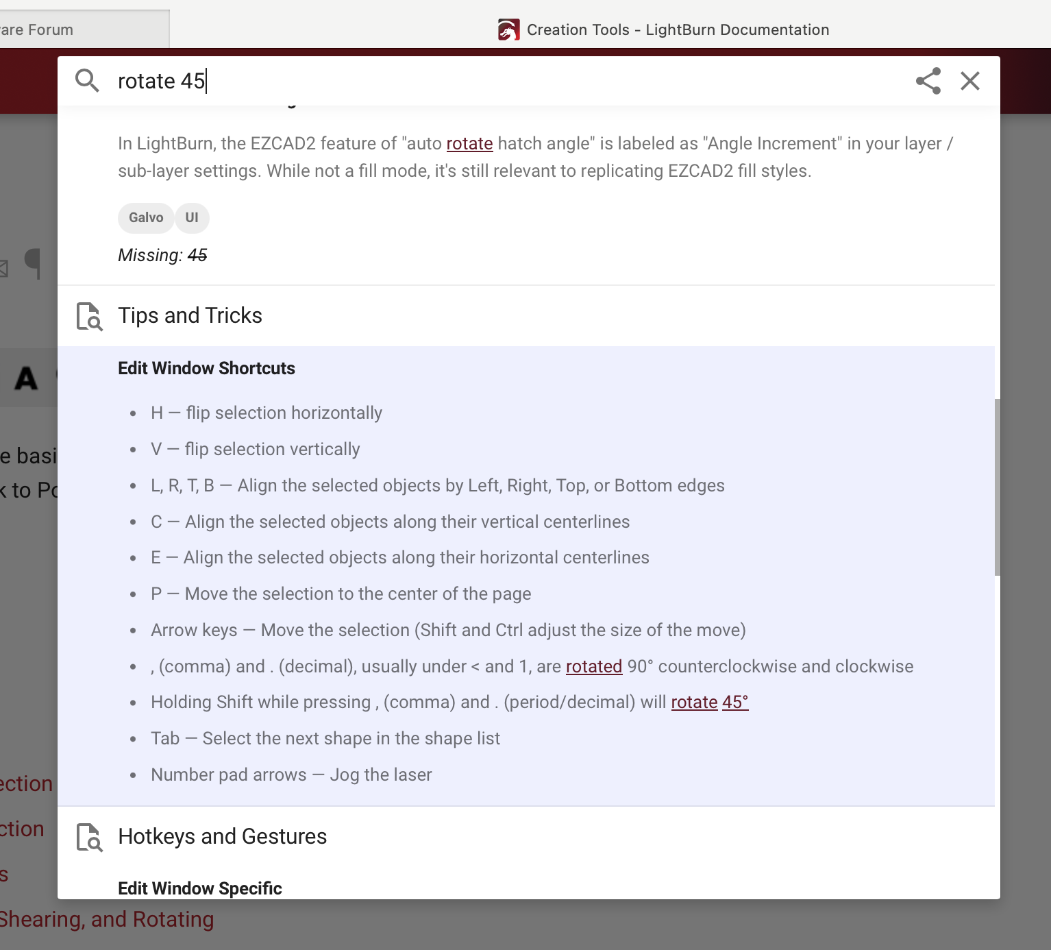

ctrl + shiff + . = 1.5º CW
ctrl + shift + , = 1.5º CCW
ctrl + shift + corner handles = 45º.

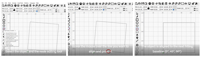

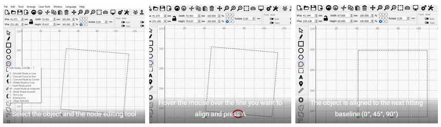

If the shape consists of vectors and nodes, you can use the Node Edit tool to snap an almost-horizontal line to 0° while rotating the entire shape:
The gotcha is that the tool will automatically select the nearest multiple of 45°, which may not be quite what you want. You can manually rotate the shape so one of the sides is almost horizontal (or vertical or whatever), then snap it perfectly.
… Not sure I’ve understood you correctly, but one of my faforit features in Edit Mode is “A - Align Select”. It snaps to 0, 45, 90 … degree, depending on what’s closest, ie, I rotate free hand roughly and press “A” with the mouse over the line I want aligned.

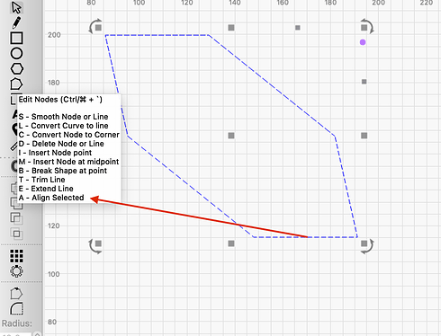

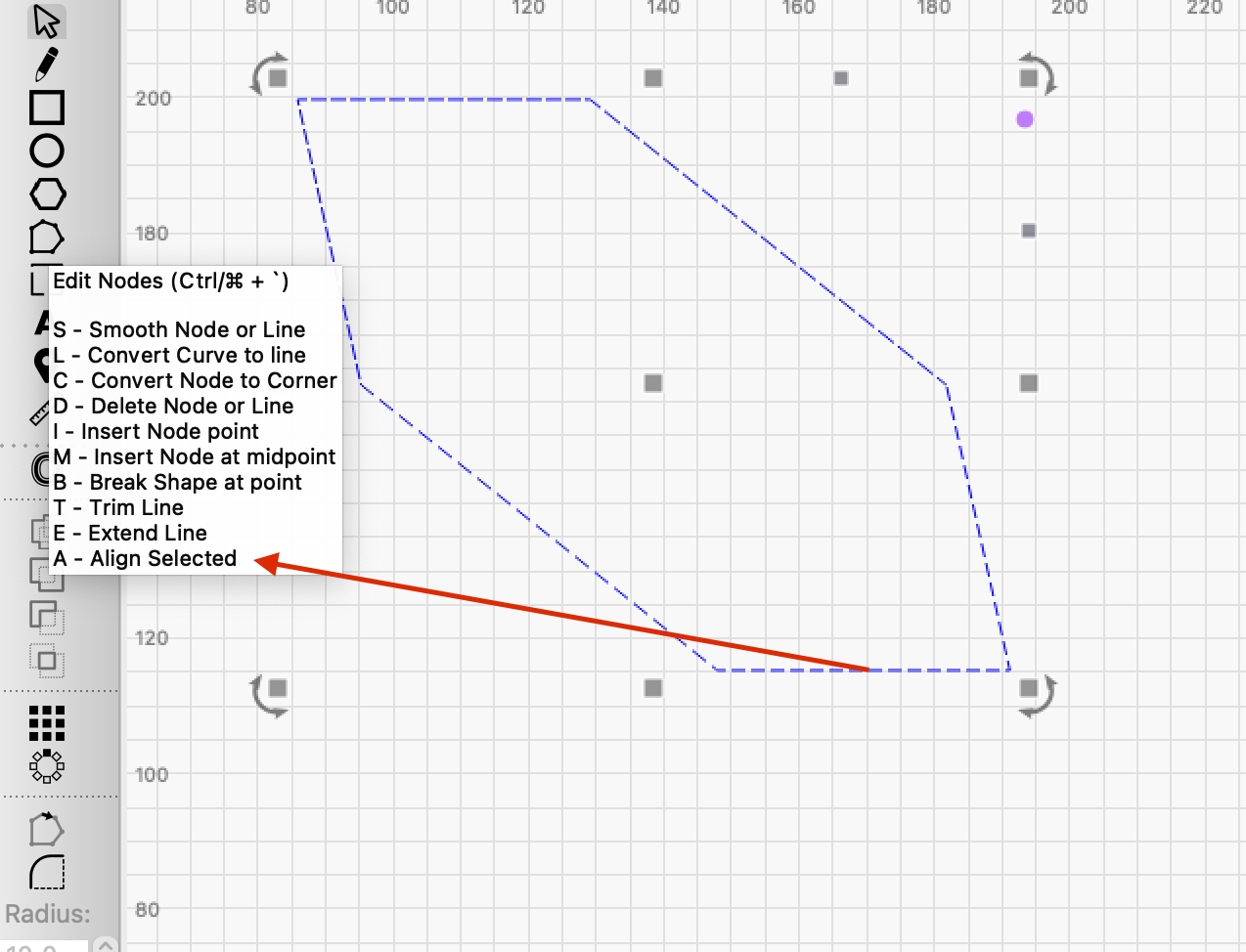

I don’t know of any function while rotating, but you can activate node edit mode, then hover over the line you wish to have flat and press A key. This snaps the line to either 0, 45 or 90 degrees, whatever is closest. Here is a screenshot:
You can find the full-sized pictures at the end of this page:

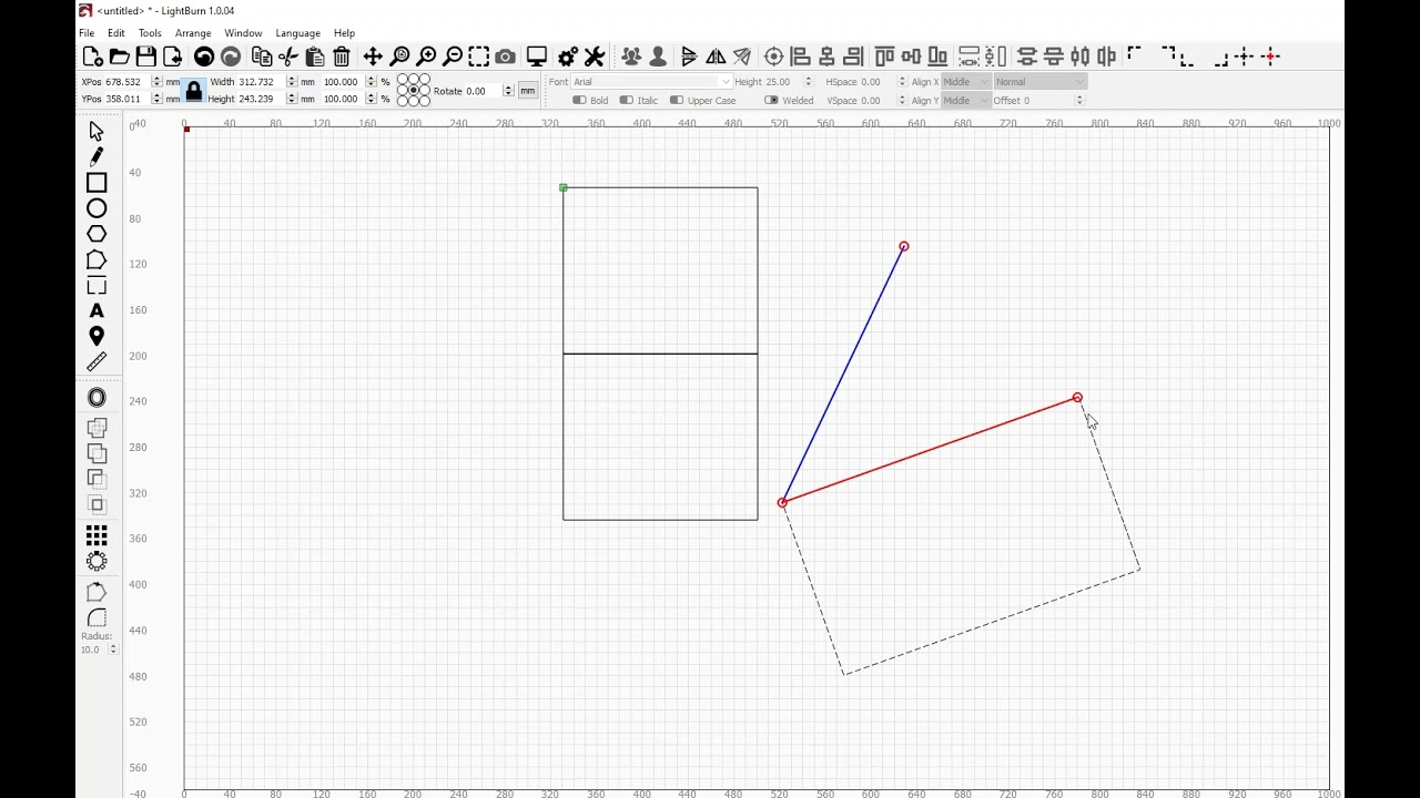

another feature that isn’t quite so obvious and may be useful in this case and especially others is the Ctrl-2 operation.
identify object to rotate
create object for reference. This can be any shape, any segment, any component with a node.
drag new object to snap to rotation point
select first object, press Control-2
prompt appears: “Select the first point - the center of rotation” - use previously created intersection/snap
“Click and drag the second point, where you will rotate from.” Consider this to be the lever/handle for rotating the initial object. It is flexible, that is, you can stretch it anywhere to snap to a reference location.
When the drag is completed, the desired rotation will be performed.
