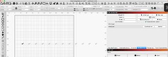

Rotate multiple words or rotate words in a sentence
WoW!
Thank you very much for your help.

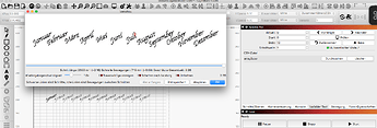

I still have to test further. I haven’t managed it yet.

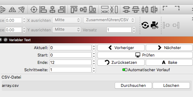

My CSV now contains what is in yours (I hope).
Hm, but where exactly do I write the “%0”? I think I had that wrong.
I selected the arry (January) and then “Merge/CSV”. The check mark for “auto-advance” is now also active.
The preview doesn’t show me anything changed either.
Bildschirmfoto 2023-12-23 um 09.46.28
The “%0” is the text in the parent array entity. The syntax tell Lightburn how to handle the variable text options.
Formatting/syntax

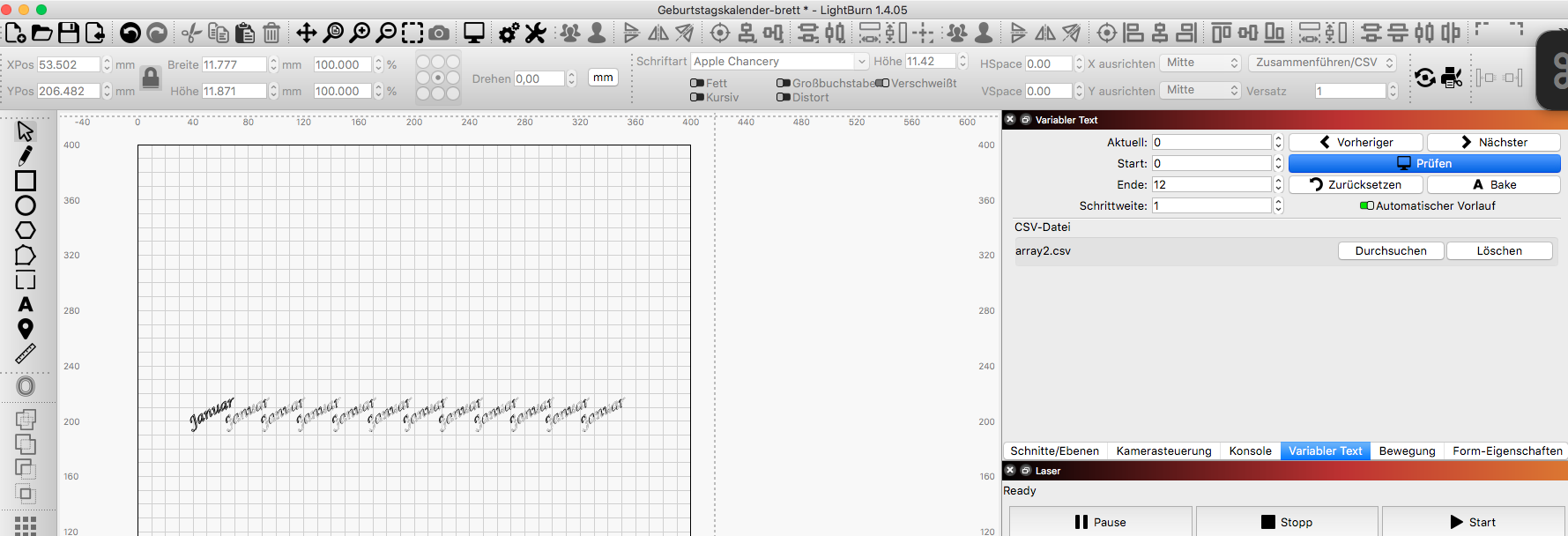

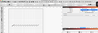

It’s worked out! Finally.
It took me a long time to understand where exactly I should write the %0. :innocent:
However, the display and preview do not make it easy to align everything exactly. I’m happy if this is resolved with an update.
