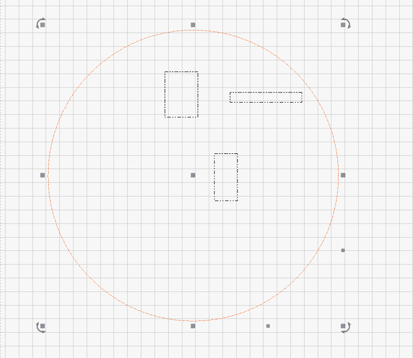

I have a grouped assembly of parts & want to rotate the whole set of grouped parts pivoting on MY OWN selected pivot point…
How do I achieve this in LightBurn ?

I’m not aware of any way to set the pivot point in LB but this would be a useful feature.
The first workaround I can think of is to draw a circle on a tool layer that’s centred on your required pivot point (making sure that the circle fully encloses your group):
I hope this helps.
