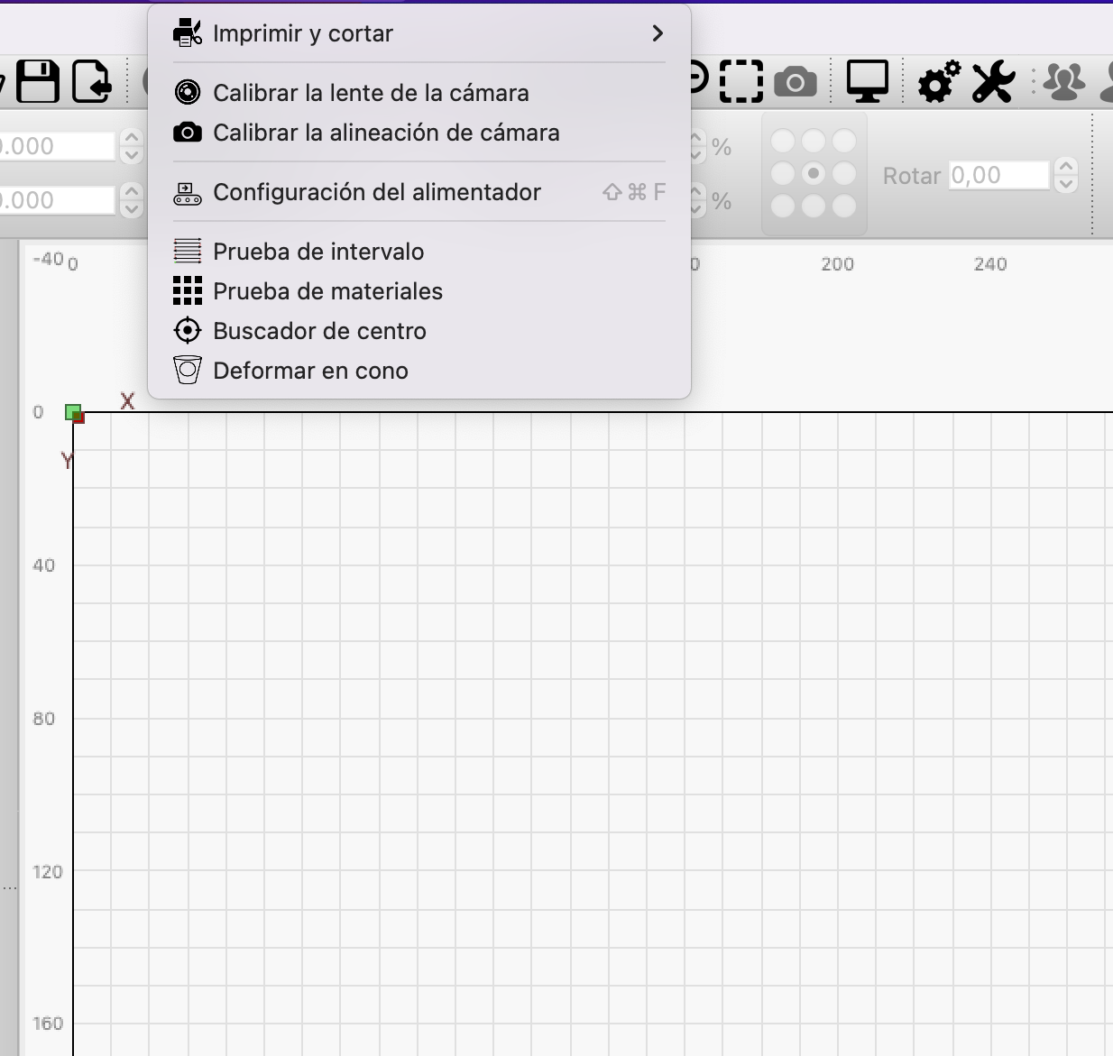

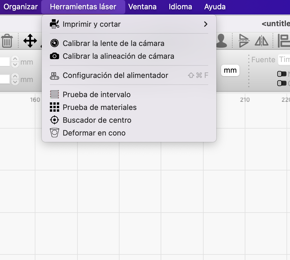

hola. tengo la versión 1.7.08 y no tengo la opción de rotación en el software.
no se como activarlo.
entre en la pestaña herramienta laser y no se encuentra el icono de rotación
Hello. I have version 1.7.08 and I don’t have the rotation option in the software. I don’t know how to activate it.
I went to the laser tool tab and the rotation icon isn’t there.

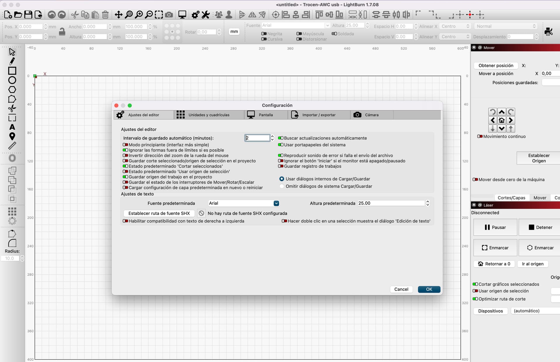

See if you have Beginner Mode turned on.
hola, sigue el problema. desactive el modo principiante y aun no me sale.
Hi, the problem persists. I disabled beginner mode and it still doesn’t work.

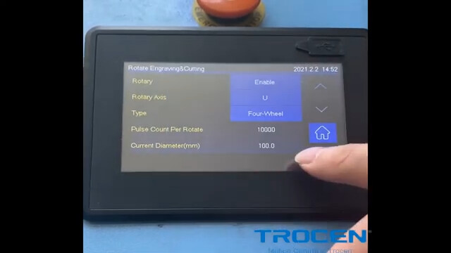

While I don’t have firsthand experience with a Trocen controller, it seems that the rotary setup is managed within the Trocen controller and integrates with LightBurn.
Through some quick research, I came across this information and hope it proves helpful!
