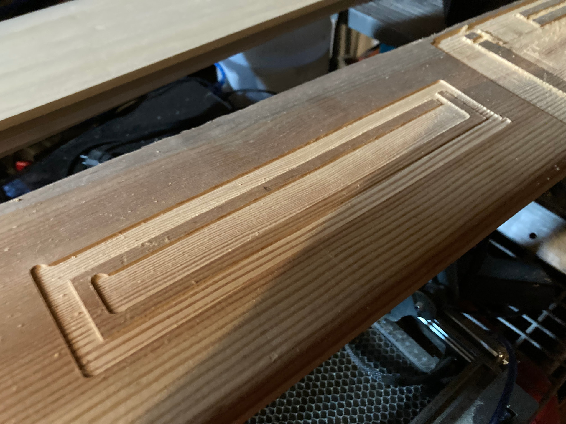

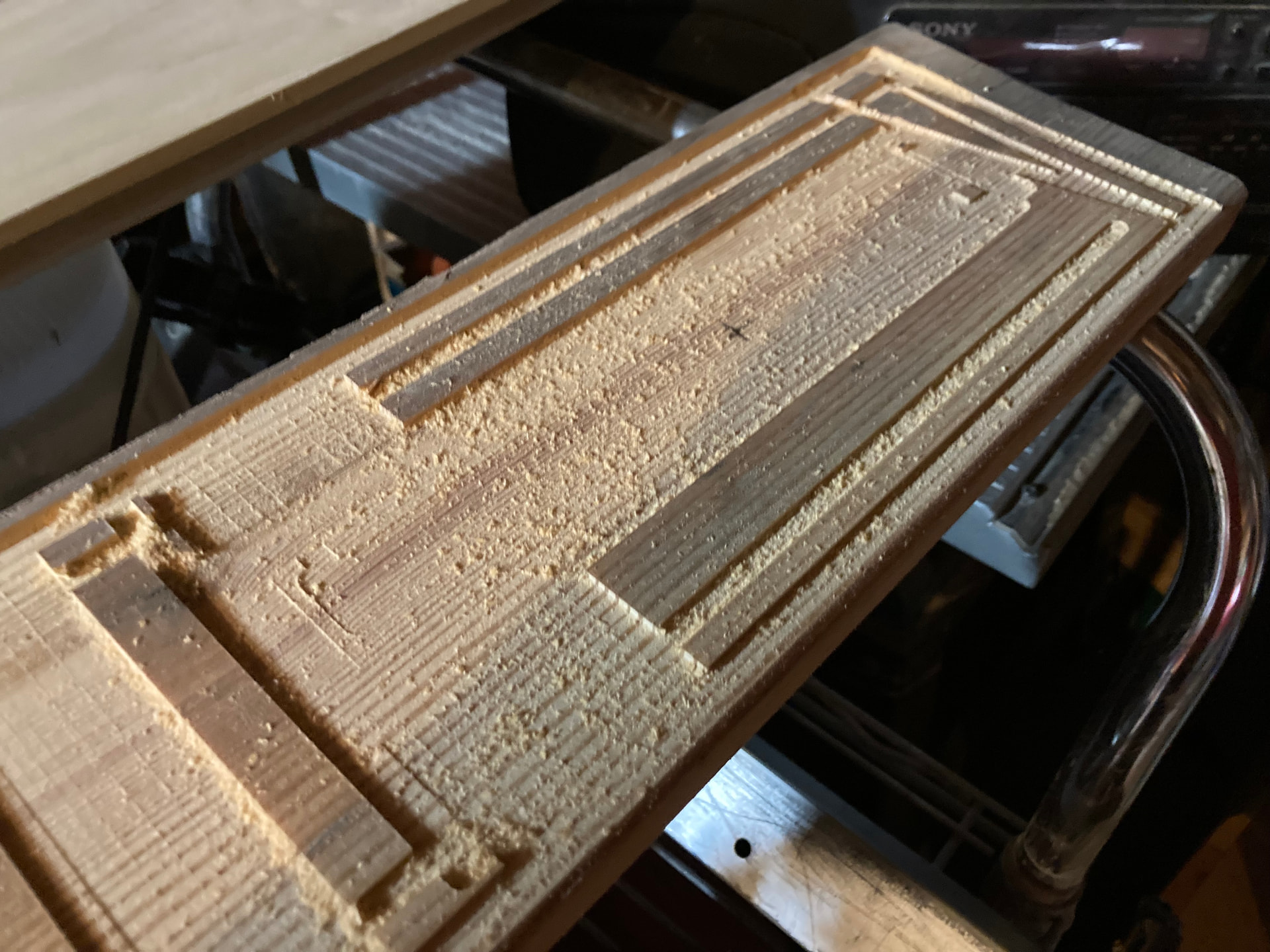

I have made numerous prodjects without problem however all of a sudden while doing a simple pocket after 2 or 3 circuts in offset mode it skips lines and leaves material untouched.
It also needs to have start hit numerous times then stops reacting completely.

I would say it might be software if it is consistanly acting up in the same place, and a connection or controller problem if it’s erratic. USB cables can cause connection issues
Do you have a picturre of the output?
+1 for a photo of the results, please! It will help us understand what the issue is.

his is two different file to clear a pocket.
If it is 2 different files, can you upload both and name them so we will know which is which?

@Dskall states what I think is the most likely issue, but you did not respond. Did you eliminate the USB cable by replacing it with a quality cable (not a $10 Amazon cable) that has a ferrite (big knot) on it?
The images @Colin asked for and you provided do not tell us how you got there.

  3. If it worked but now does not, then that COULD BE a settings issue. Without seeing the MillMage .mage file, all we can do is guess. What do you think the odds of getting to the solution are under that condition? We can’t help you if you do not help us.
This forum is probably best place to solve these problems. Devs. are active here as well as us regular guys who run into problems that need to be resolved. Most find a solution if they are willing to do checks and follow advice.
On that note can you elaborate on what the router is doing in the area when it skips sections, is router lifting up and continuing or is it reversing and going over already cleared area?
