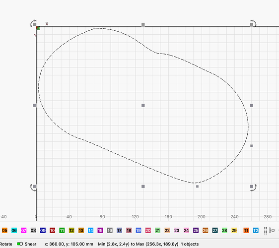

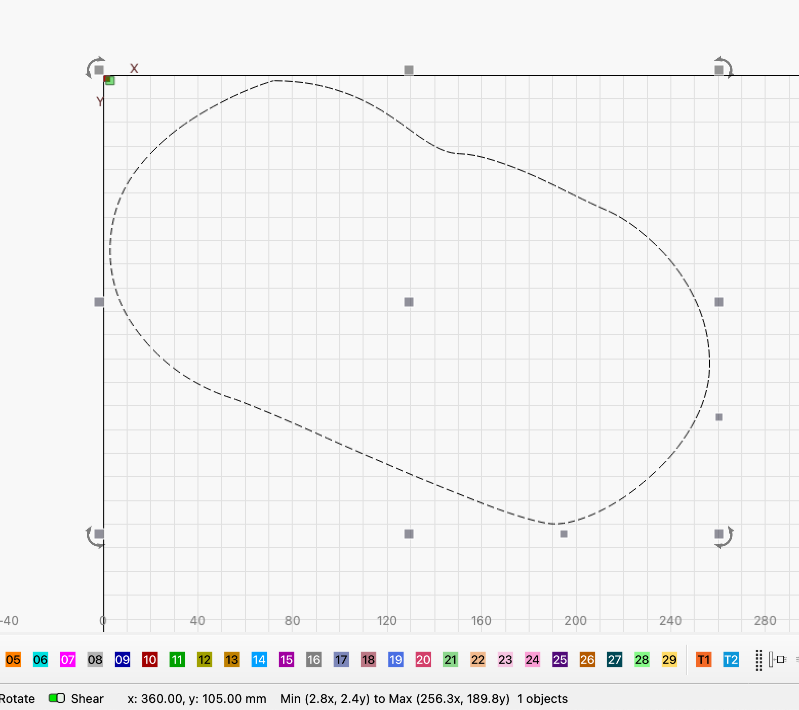

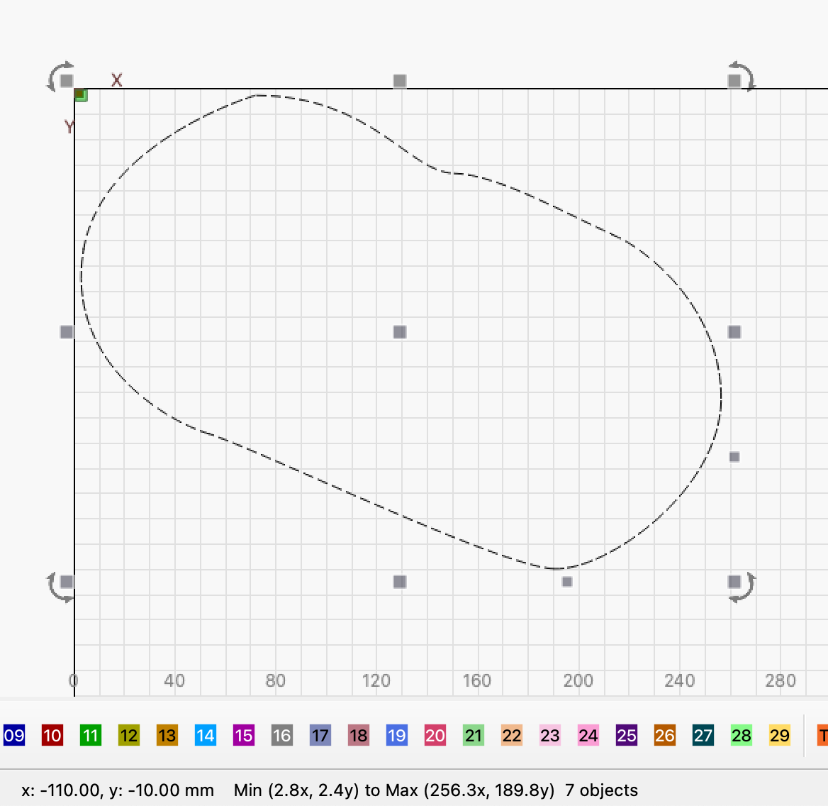

There are 7 segments, after breaking apart and joining them together there is 1 shape, the last two nodes can be assembled manually.
(note the status bar at the bottom)
How? I tried selecting, alt B, then Alt J and nothing happens.
Connect manually, How? I put one on top of the other and nothing

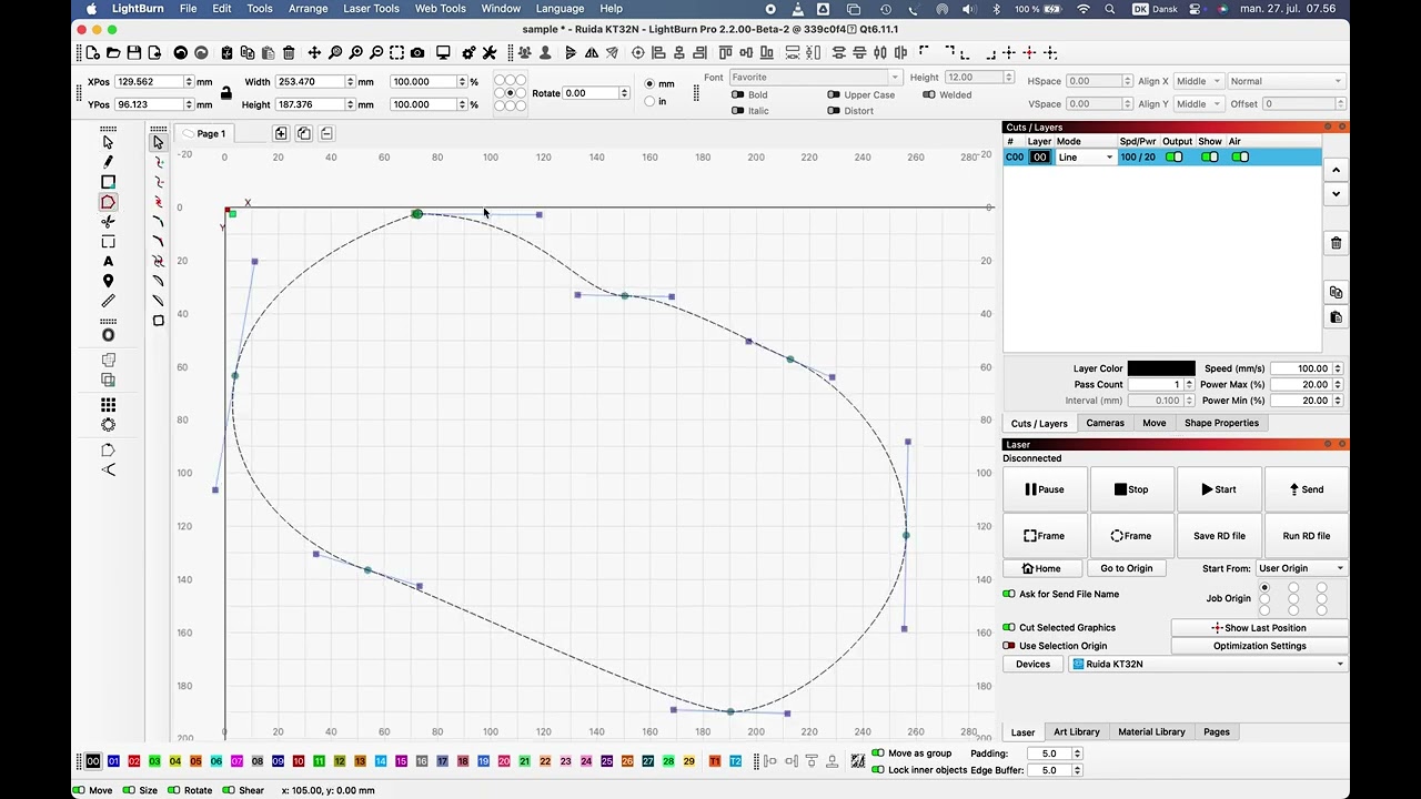

I make the shape editable so I can manipulate it. In edit mode I also drag the two green single points together with the mouse at the end.

  1. Select all of the path. I did a green rectangle (click and swipe left), but you may have to manually add each segment one at a time if there is other stuff in there. You may have to temporarily move it to a different layer to isolate it, then move back when done.
  2. Switch from Line to Fill in the Cuts / Layers
  3. Open the Close Selected Paths With Tolerance window, and slide the Distance Threshold: over until you see the object fill. In your design, it was less than .04mm.
  4. If you move the slider all the way over and it does not fill, sometimes Join with Line will work.
  5. Then switch back to Line and you are good to go.
  6. If none of the tools close the path so it will fill, they you have serious issues with the path. Plan on checking out the entire path to find out what is holding you up. Been there, done that.

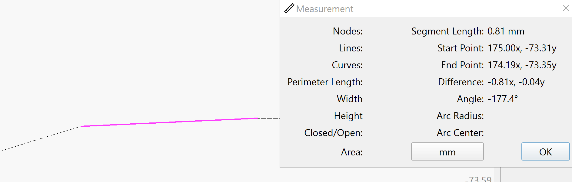

Just to add to the above:
Check the distance between the nodes, 0.81mm in this case, to keep the shape original format.

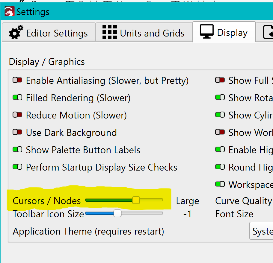

You can increase the size of the Nodes here:
I put fat Nodes, zoomed all the way in, and put one green (turned red) on the top of the other as best as I could. This is set to Fill, but obviously it is not filled. I would still have to use one of the joining tools to close the path. I am wondering if this would ever work…

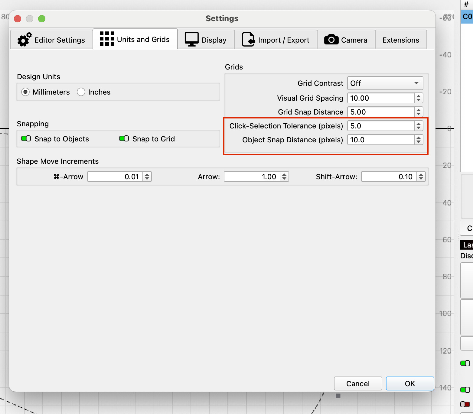

There must be a snap-to or tolerance setting different between us. Your instruction does not work for me.

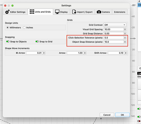

Update: I had Snap to Objects turned off in the Settings window, Units and Grids tab.
Mine is on, but Alt B and Alt J work.
Perhaps this note from the docs is relevant:
To connect start and end nodes using Auto-Join, the nodes must be within .05 mm of one another
