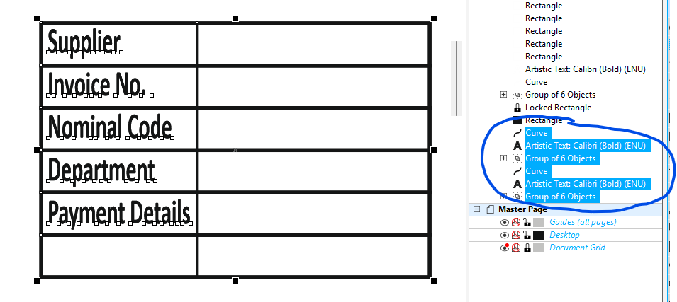

I still actually create all of my rubber stamps in CorelDraw X6 and export them as .ai files to LightBurn. But it is a lengthy process! For smaller stamps I tend to put a hairline around the text, convert the outline to an object and then weld. All lines need to be made 1MM or 2MM thicker and then converted to an object. JobControl used to recommend 1.8mm gap around the edge of the stamp but in LightBurn I have learned the hard way to increase this to 3MM. What I now do is draw a box in CorelDraw, fill it in black and remove the outline. Make what is left 3MM larger than the stamp artwork, change the stamp artwork to white and centralise it over the box, making sure that the white text is on the front I click Front minus Back so that I have one object which is what is exported to LightBurn.

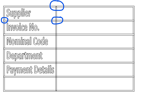

Corel file attached, the .ai file is very larger, a cut line can be added I guess from lightburn, i wish is was bit easier, volume is quite high, shame about JobControl not being available its so good at the stamp side of it, It wont allow the attachement of the corel file so will have to edit thursday and try then

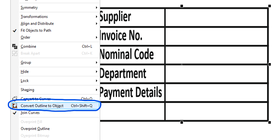

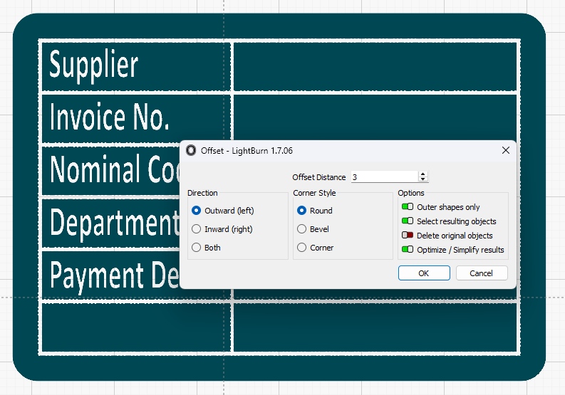

LightBurn ignores any line widths in vector files so as @G4rth mentioned you’ll need to ‘Convert Outline to Object’ first .

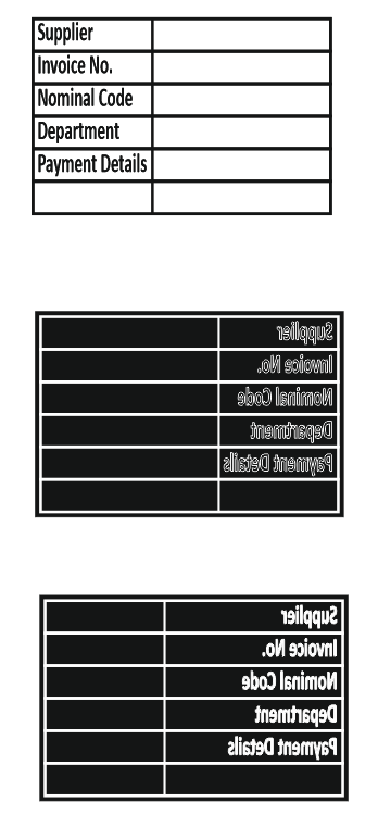

You may then need to weld any overlapping objects (this screenshot is in wireframe mode): This could be done in Corel or LightBurn.
I’ve noticed that there are duplicates in your CDR file so you’ll need to remove these. This is ideally done in Corel but LB does have the ability to detect duplicates and delete them This doesn’t always work though.

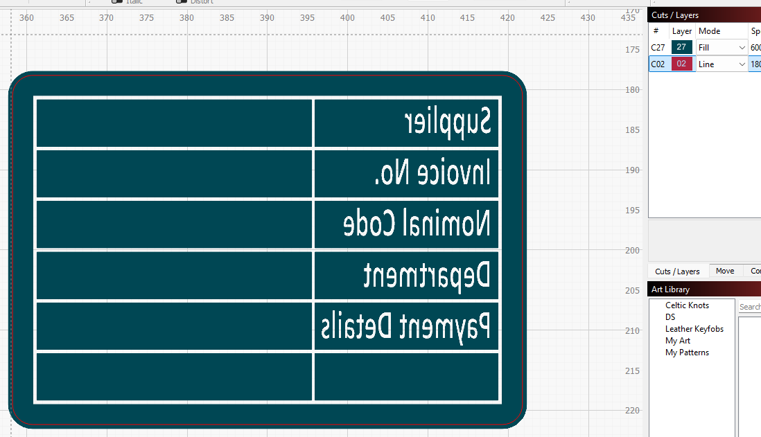

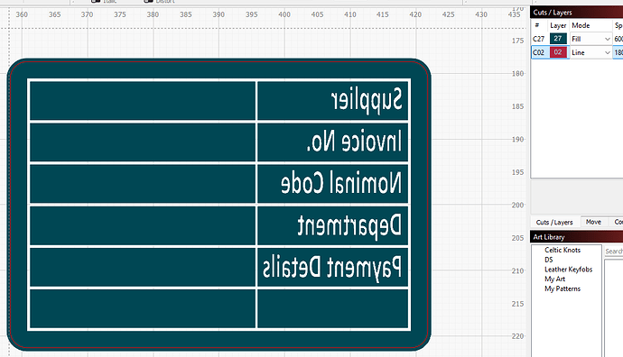

Once in LB I would offset the graphic by an appropriate amount. Make sure you select ‘Outer shapes only’. This will invert the lasered/unlasered areas:
I would then offset the resulting outline slightly inside to get your cut outline (obviously move this to a layer set to line/cut Then mirror everything.

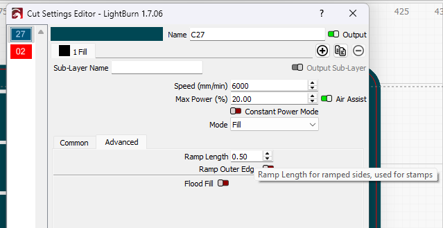

There is a ‘Ramp Length’ setting in the layer setting dialogue that’s meant for stamps that you might find useful:
