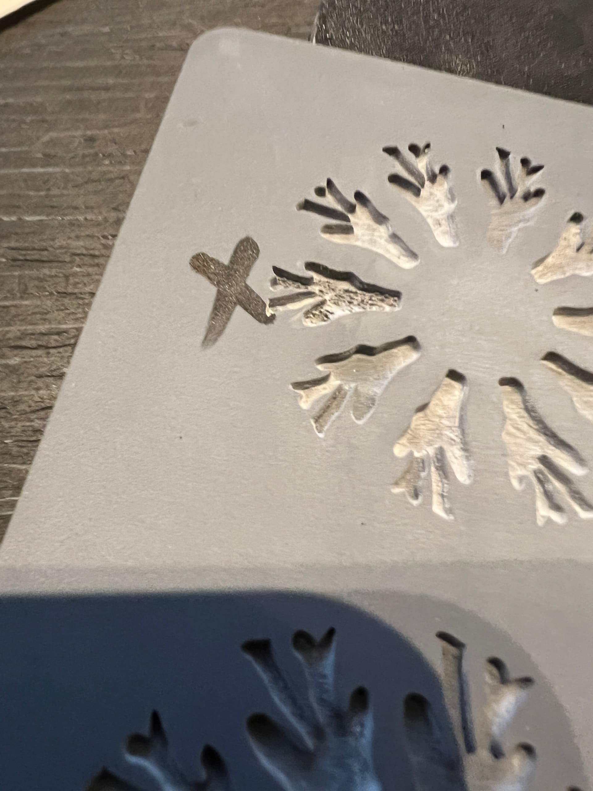

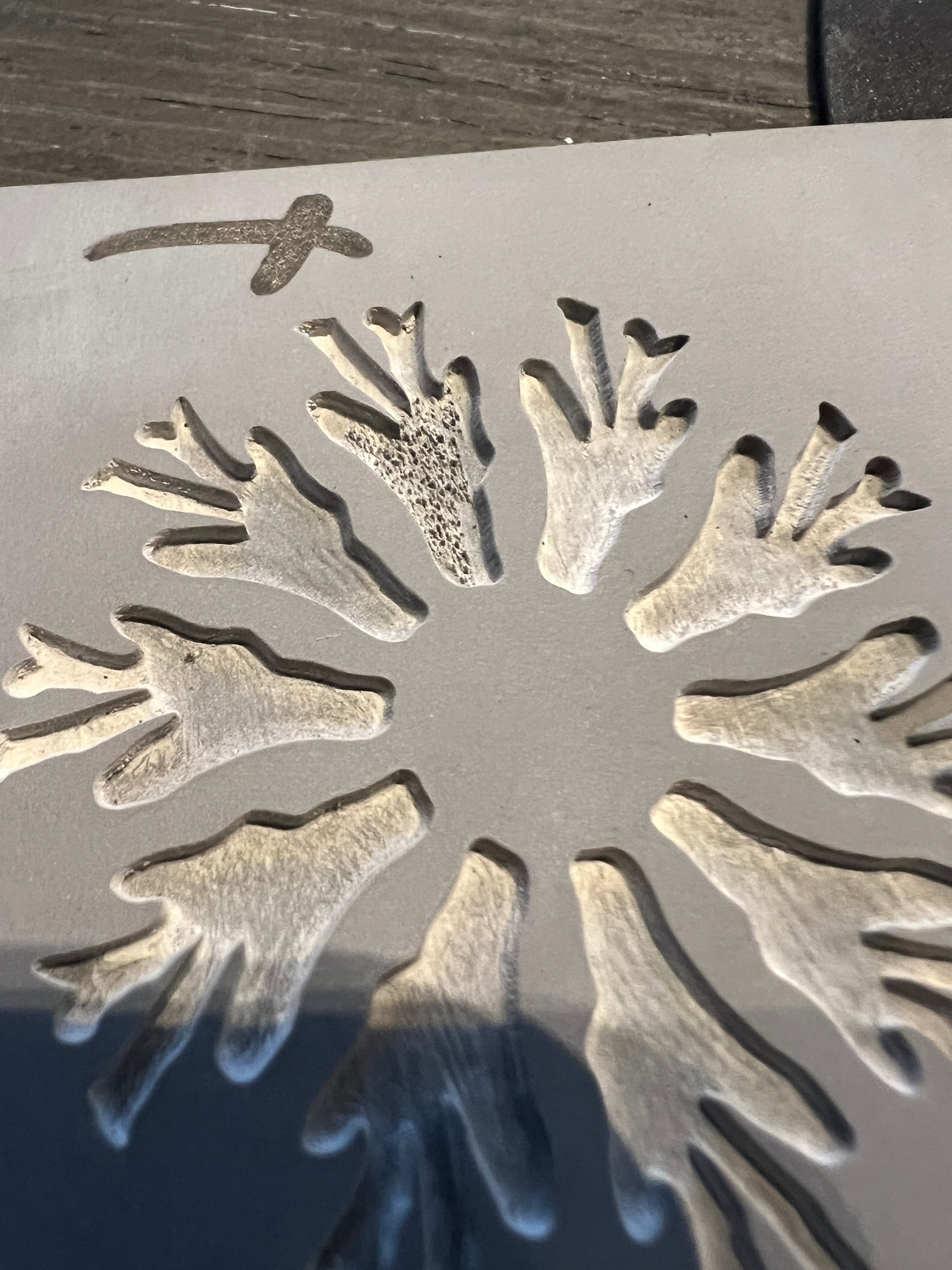

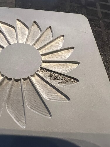

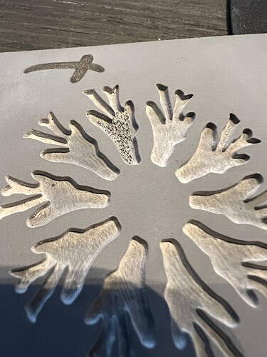

Has anyone had this issue before. I’m etching a rubber stamp. The etched area looks like the rubber stamp sheet dust is re-fusing to the etched part. ( just a guess) See photo. The air is up as high as it can go. It doesn’t happen all the time, but enough to be a problem. To clarify, I’m not using the rubber stamps like a traditional rubber stamp. It probably would not be an issue but I need the etched part to be clean. Any help appreciated.
LightBurn Pro 2.0.03
Mac Studio
Speed 250
Max power 80
Min power 80
400 LPI
ThunderLaser Bolt
I would guess 2 possibilities:
  1. Too much power.
  2. The material composition varies in density or chemical makeup.
Is this a fill operation using ramp setttings?
Min/max power doesn’t matter on a fill/scan operation, the Ruida will ensure it’s up to speed before it reaches the engraving area.
80% power of a 100W machine is different than 80% power on a 40W machine, you’ve left us guessing here.
Is this an RF machine? You should be able to run 500mm/s without an issue with an RF source.
Do you know your spot size? You don’t want to cover the same area for multiple passes.
Is 400LPI a little too high for a CO2 machine?
Thanks I’ll try lowering the power. These need to be deep so constrained to the power that cuts deep enough. Thanks
Thanks sorry I’m still very new to this. according to the site, it’s a 30w RF Tube (comparable to a 60w glass tube)
I have a lot to learn. I have no idea what a spot size is. The settings are set to the crosshatch setting.
In one pass? Does your Lightburn permit multiple passes in the Cuts window?
Yes it does. But the cutting is fine. It is the etching that isn’t clean.
When I said “Cuts window”, I did not mean a cut power setting. I am talking about engraving settings in the Cut Settings Editor window.
I would lower the power to put less energy into the pass, just enough to remove some material. Then use multiple passes to get the desired depth. You destroy with a jackhammer, but carve with a chisel and hammer.
thanks for that clarification. I’ll give that try, your analogy makes sense.
