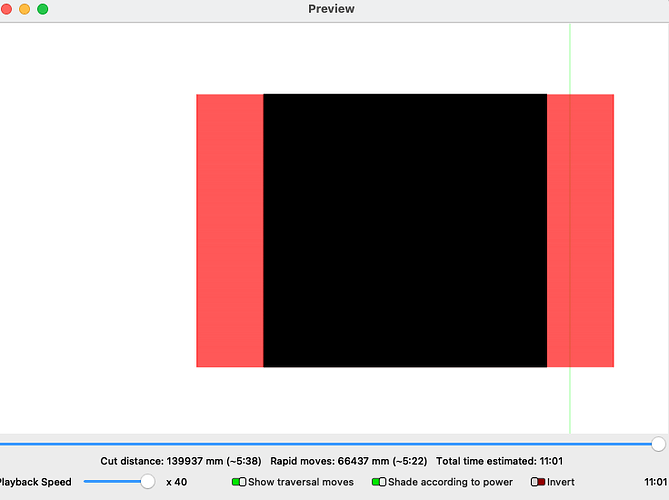

There are some things that confuse me from time to time though. This latest is that I tried running a “Fill” job on my 90 Watt laser at 16in/sec @ 100% power and it kept giving me an error on the controller “Not enough buffer space”. After an hour of troubleshooting my cable, and bridge, trying USB, etc. I changed the speed from 16 in/sec to 15 in/sec and it worked.
First, what causes this. Secondly, is there a way to know what the max/fastest settings are?

16 inches per second is fast. There is probably not enough room on either side of the project for the laser head to slow down, change direction, then speed up again. Faster is not always faster.
I’m sorry, what do you mean “change direction then speed up”?
When in fill mode the laser starts moving to get up to speed before starting to fire, then when it gets to the other side it has to slow down and reverse direction and ramp the speed back up again. Your controller takes the speed desired and calculates the space needed for those actions and if you’re workpiece too close to the edge of the bed it sets a warning. Try moving your workpiece away from the edge and see what happens.
If you look in the preview window and turn on show traversal moves you can see if it goes beyond the extent of your work bed. See below. The shape is within the work area, but the laser needs more space than is available to turn around. The green line is the work area.

Learn to use the preview and enable show transversal moves, this gives you the red, referred to as overscan, that @thelmuth was mentioning…
Here is the same size rectangle 500mm/s and 1500mm/s… Note the time … job is quicker at 500mm/s.
